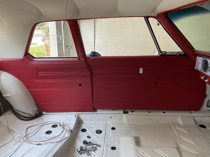

Did you use a standard big block dip stick or one for a Max Wedge?

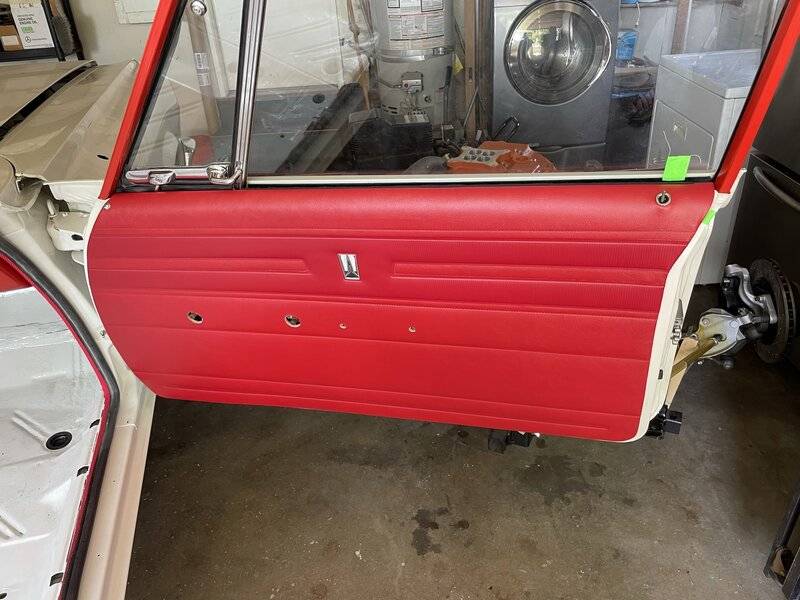

And "WOW!" Those door panels, really beautifully done.

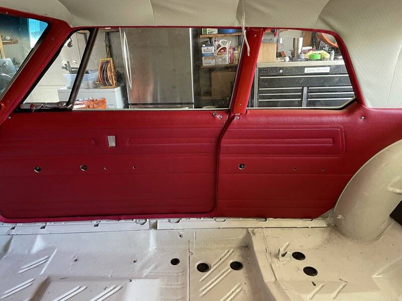

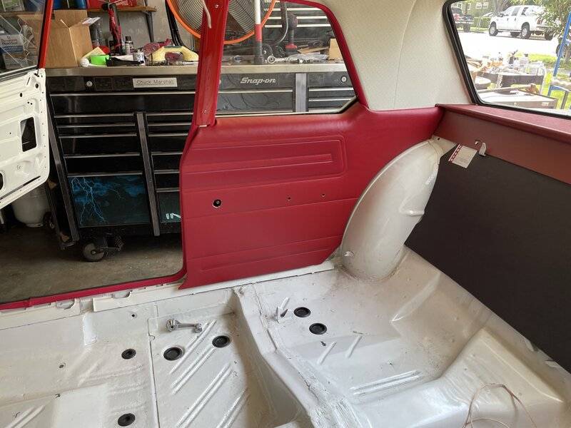

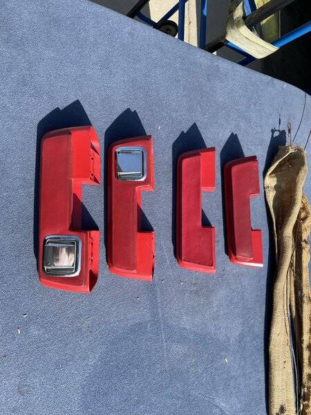

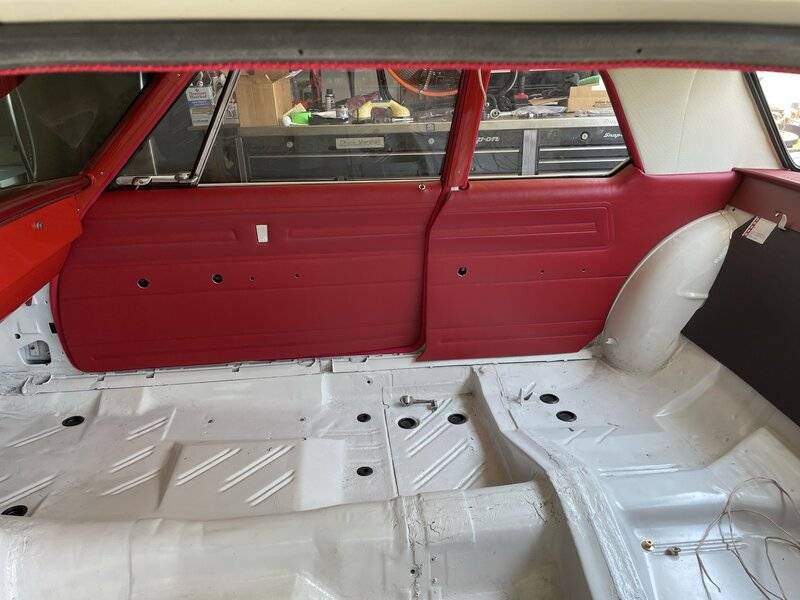

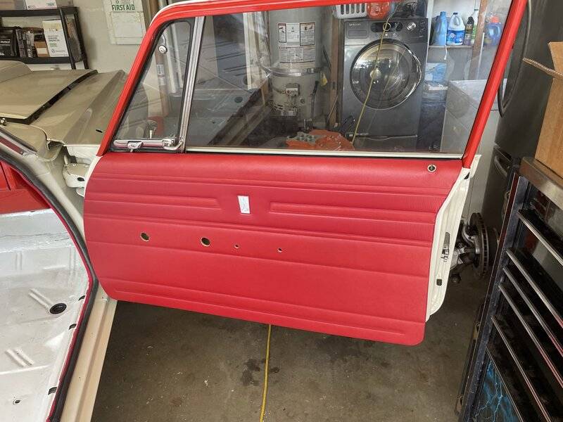

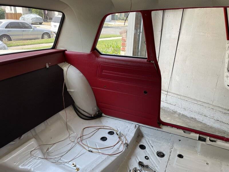

I going to test fit the front door panels and to mount the rear 1/4 panels so that the dark red bars line up with the front door to the rear 1/4's got the passenger side done and looks pretty even. Will wait on the arm rests and window crank handle in rears until after rear seat is in. The front door panels I will have to take off again to install the door lock tumblers. I thought I got a new set but I guess not. I will pick some up at the Ohio nationals next month.
IMG_2031.jpg IMG_2032.jpg IMG_2033.jpg IMG_2034.jpg IMG_2035.jpg IMG_2037.jpg
Little by little you bring her back to life. This is one restoration project of love that 'must be' shared with others.
It looks so great. Can not wait to see it completed.
Oh by the way, I'm taking notes from you. LOL
Great job.

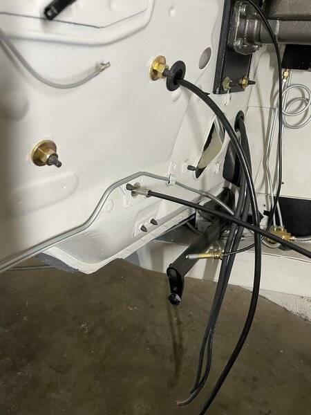

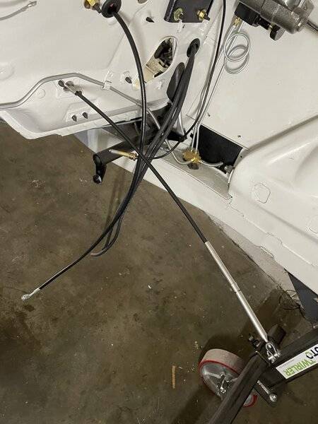

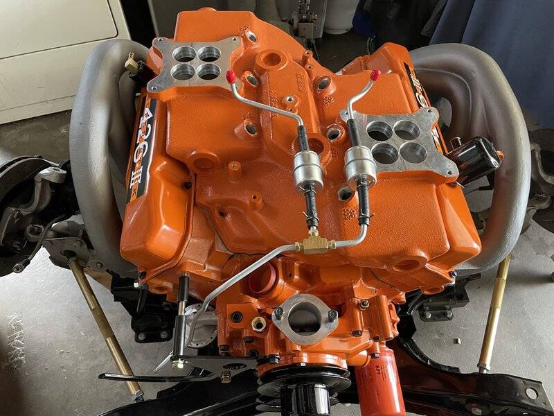

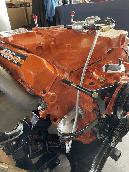

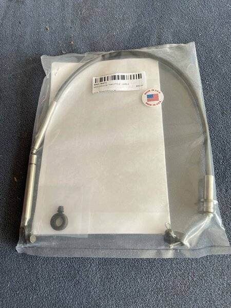

Chuck...The length of the throttle cable that you have...27"?

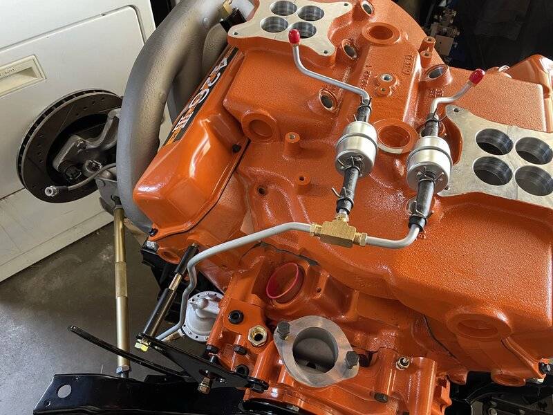

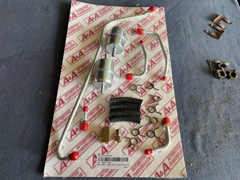

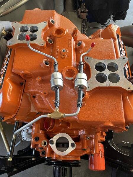

The last picture of the fuel line showing the bends from the fuel pump to the upper fitting is helpful to anyone installing this line.
Looking great my friend...
Good question, I will measure it.
Let me know how that works out for you.
I have one that is 27" long that I was told was the correct length and will use it for the 64 Belvedere.
I have the original intake and carbs, but not on the car right now as I am rebuilding the motor, so I can't tell you anything for right now.

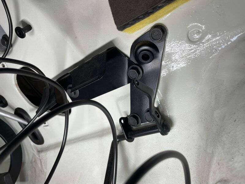

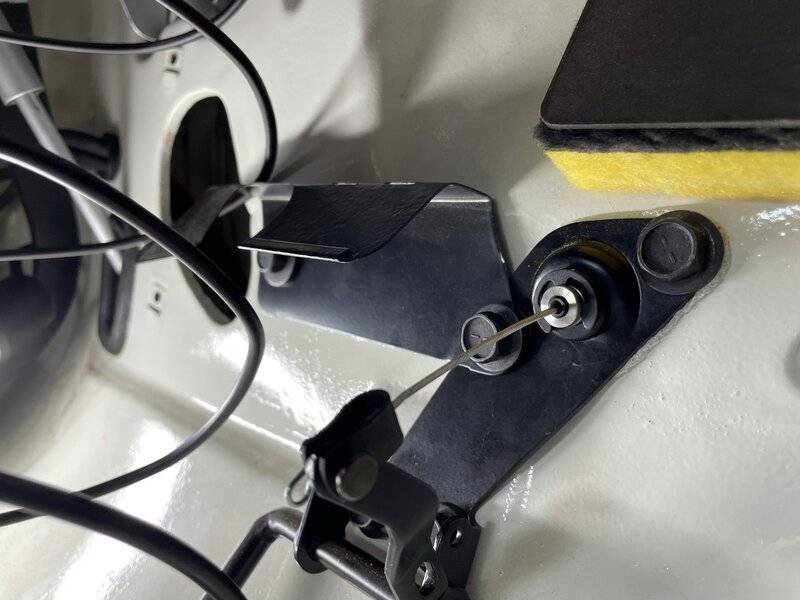

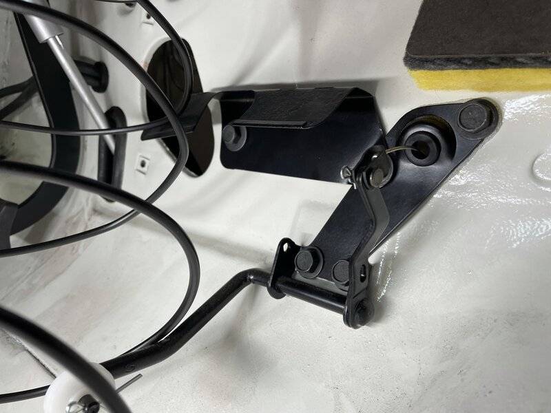

My car was originally a 6 cylinder car but I think at one time it did have a v8 because the k member was a v8 k member and not a 6 cylinder k member. The throttle cable I took off is 27" (I measured it too today). I researched the length and Kramers, Mancini and A&A all sell the 23.5 for max wedge cross ram applications. But I will let you know if it's not right after I install the motor. Hopefully that will be soon! Lol!
Chuck...Did my research Chrysler Part Number 2465927 1962-64 max wedge throttle cable 23.5" to be correct.
The 27" throttle cable would be correct for a 6 cylinder engine.
Now we both know. LOL
Don't forget the small rubber grommet at the end of the throttle cable that inserts through the firewall to protect water from coming in through that hole ruining the carpet there.

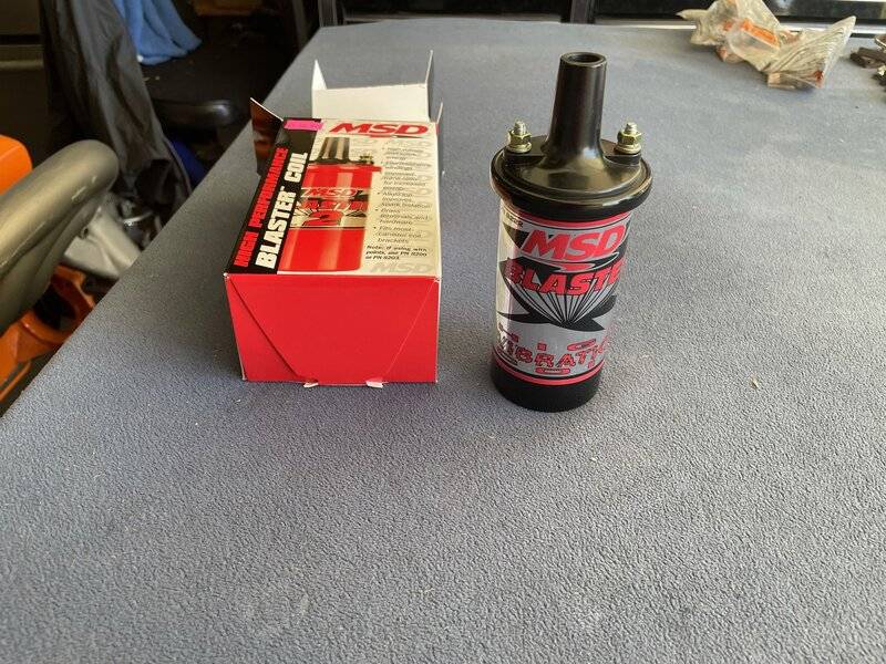

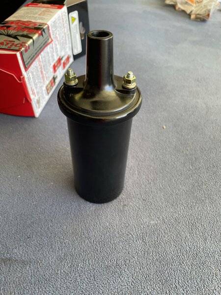

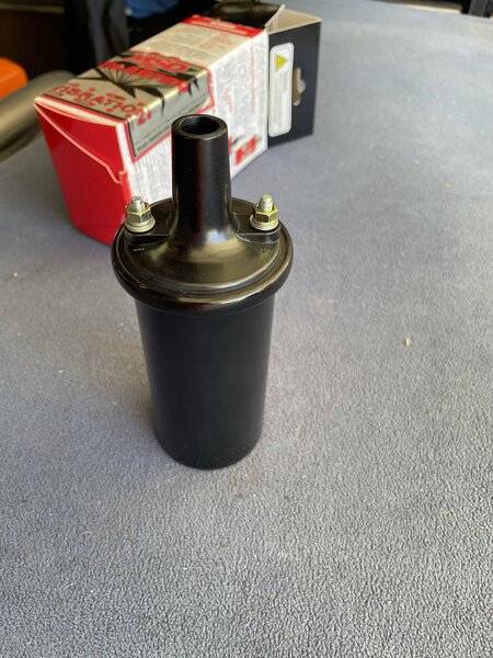

Ok, I thought long and hard on this decision and I am deciding to go with a Prestolite cast iron housing dual point distributor with a Black MSD High vibration Blaster coil. I removed the label so it looks more stock. I got the High Vibration one because it can be mounted horizontal rather then only vertical. I'm also going to run a MSD 6AL-2. The reason for the Prestolite is to stay original looking as possible. The Chinese billet aluminum ones and the mopar performance electronic ones all seem to have issues(from reading on this website) regarding quality and reliability and also not looking correct for a max wedge. The dual point system is more reliable I think then these others. The MSD pro billet distributor is nice and high quality but to me it does not look right for what I'm trying to do. They also sit 10.5 inches high off the block. All the high performance Mopars back in the day ran these distributors with much success and are still running them today. They do take maintaining but hey that's all part of the fun of tinkering with our machines. When I get the Prestolite I will post more pictures. I will be attending the Nationals next week in Ohio. Looking forward to shopping for more parts and watching the racing!
