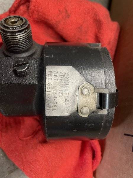

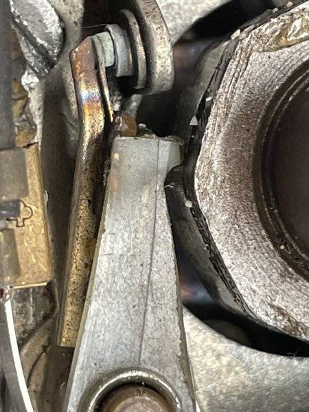

When I was at the MATS a week ago on Thursday when I arrived I went to start the Savoy to take it off the trailer and I had a difficult time starting it, it was very cold at the Mats in the morning but she always fired up quickly. During the show on Friday when the judges were at my car they requested that I start my engine and also run the lights and turn signals and brake lights( never had to do that at a show before) but everything works great on my car so I wasn’t worried. But I was worried it may not start right away. Thankfully she fired right up. When I got home and parked the Savoy in the garage I took the distributor cap off and discovered my lead points were fried. It’s a dual point prestolite distributor 2444721. If you look closely you can see the plastic followers on the cam are almost flat on both with bits of white plastic stuck in the cam lube and inside the bottom of the distributor. I’m guessing over time that plastic gets brittle and dry and breaks away. Not surprised being how old it is. Thankfully I found a new point plate set on eBay and I’m going to install it but remove the condenser and second points to run my MSD digital 6AL I installed during the build. Never got around to finishing hooking it up. Ran great on just the stock dual point. I post pictures when I’m finished redoing the distributor. Thanks Chuck

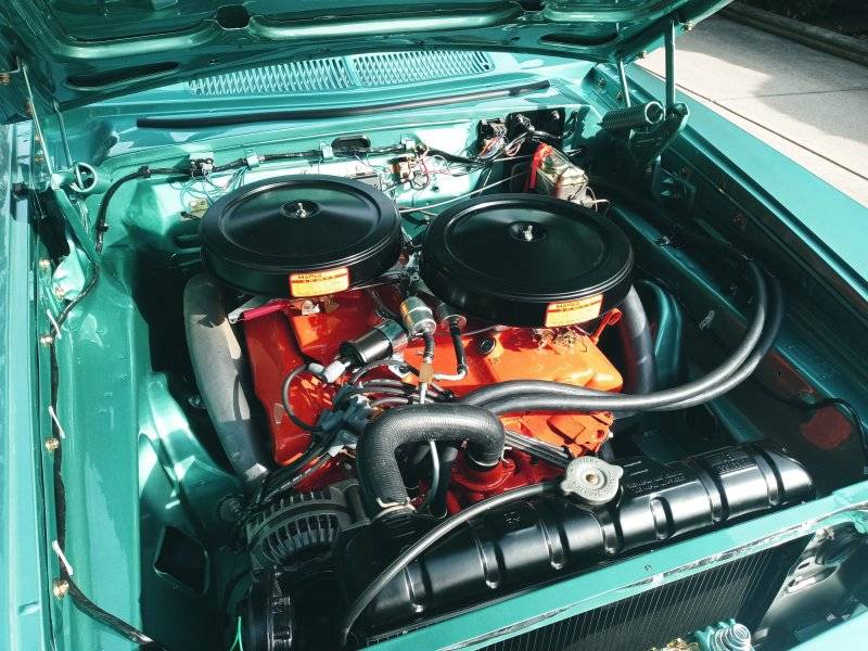

Now I noticed on the savoy the fuel hoses and clamps were leaking fuel. They leaked onto the cross Ram manifold and caused the Hemi Orange paint to blister off. I purchased the KV reproduction hose and the reproduction crimp style clamps. I like the originality of that put the quality is poor. The hose is only a year old on the engine and probably had about 20 gallons of gas flow through them and the rubber is already hard as a rock(obviously why it leaks). So I went with regular Fuel hose and modern crimp clamps to stop the leaks. The other thing is the Hemi Orange paint is the Mopar brand I used and the can reads fuel and oil resistance but obviously it’s not . I need to sand the blistering down and repaint it. I’ll post pictures when I’m done but just wanted to let members know about that.

Got my distributor rebuilt and painted, also took the front carb off while I had the fuel lines off and repaired the bubbled paint on the intake manifold.

Ok so that new prestolite point plate didn’t work out, even though it was brand new out of the box the plastic for the cam follower only worked for about one minute and then broke into pieces like the other one. I guess even though it’s not used it’s still probably 59 years old? I don’t know but know I found a Pertronix drop in electronic system so I’m going with that. The MSD got repaired and on its way back to me so hopefully I’ll have it running again soon.
Do you have a picture of the distributor cam plate. Curious what it looks like?
Is the cam beat up so it might damage where points rub? I have 3 sets points and condensers wonder if I'll have problem running them?
No the cam looked clean and smooth, I lubed it with Bosch distributor lube too. Use to use it on Porsche points years ago when I worked at the Porsche dealership
