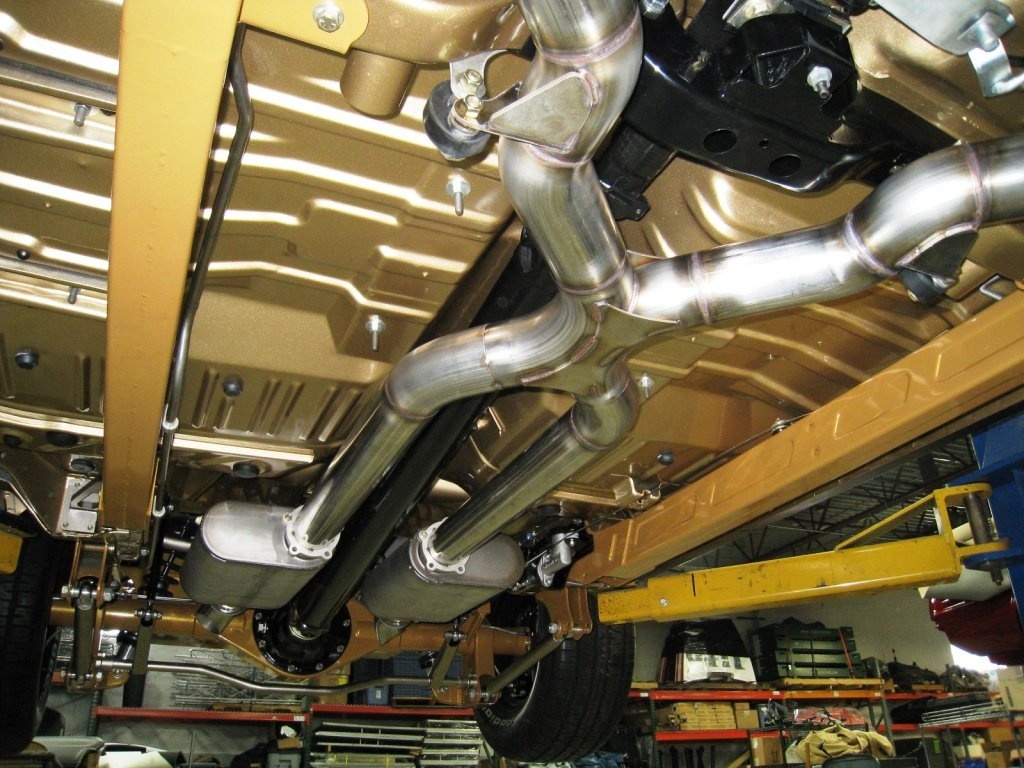

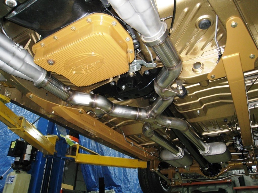

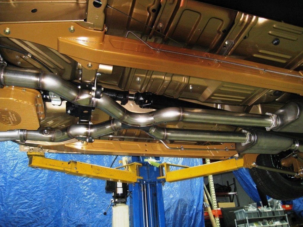

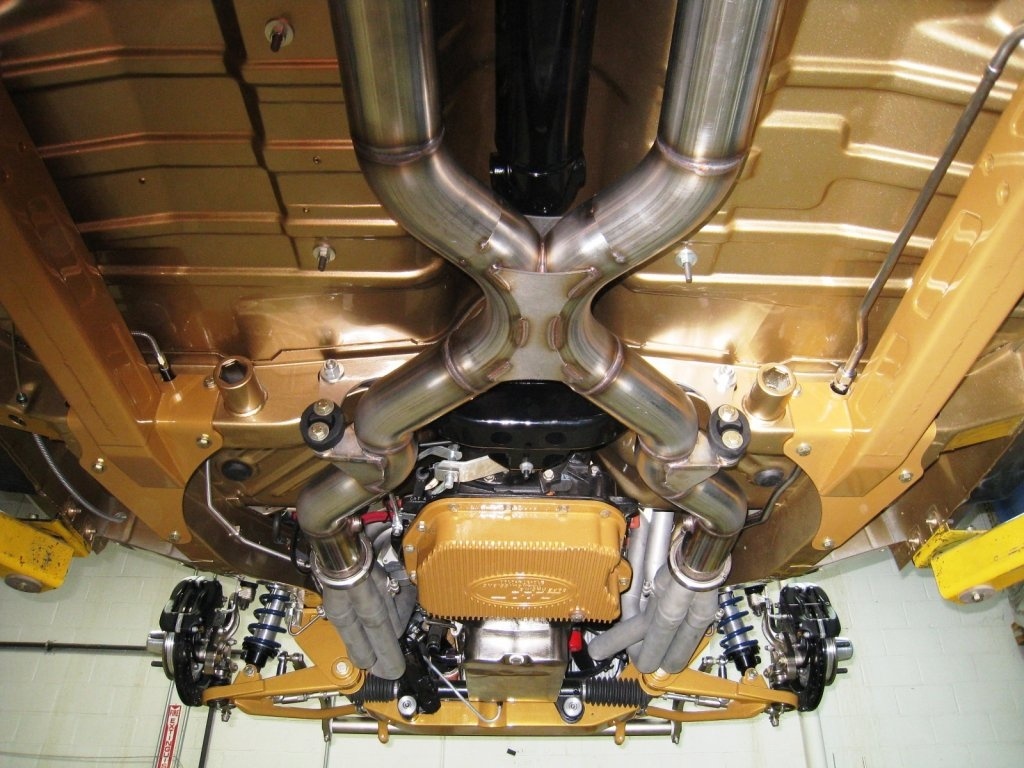

Hi Guys' I've been making a little progress so I thought I'd post. You guys' are probably tired of looking at this project, I know I am!!! The wiring is completed and utilizes the original body harness from the firewall rearward. All of the electrical systems added to the vehicle, fans, fuel pump, MSD box ect, were placed in a separate fuse panel under the instrument panel. Fortunately Ma Chrysler left enough unused pins in the firewall body connector to allow us to utilize it for all engine harness and front end circuits. I can't take credit for the ultra clean wiring a friend, Dave Decker did the work for me. I still have to do my part and do all of the final tie downs on the harness extensions. The exhaust is all welded and has the hanger hardware fabricated. In the photos some of the parts a tacked together, but it's finished now with the exception of the final installation.

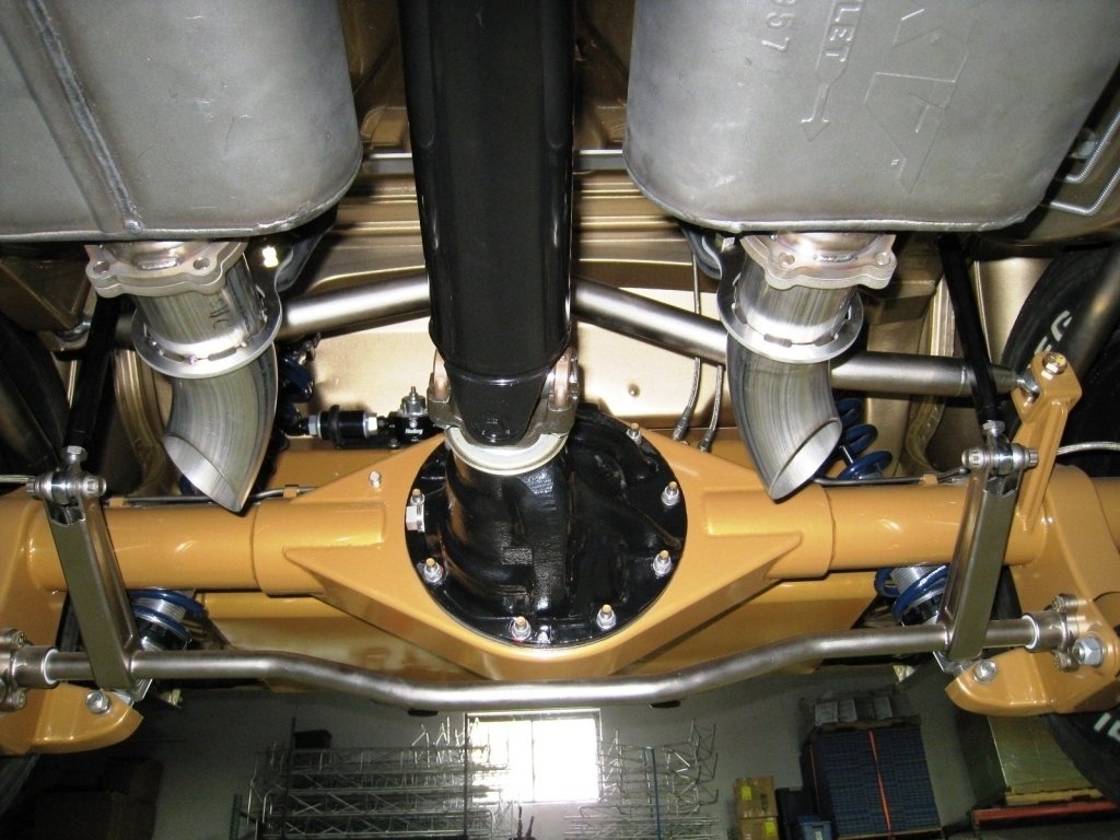

Hope you have your tune correct or your going to turn you axle housing black. LOL
It's too nice to drive.
Incredible work sir!
Gpuller, yeah the housing will probably get some soot on it but, In the photo the axle is at full droop. At ride height the axle is 3.5" higher in relation to the exhaust turn-outs. I'm hoping to get the tune decent and get most of the soot on the anti-roll bar. Now don't you dare apply logic to my naïve illusions........LOL. Thanks, Brian

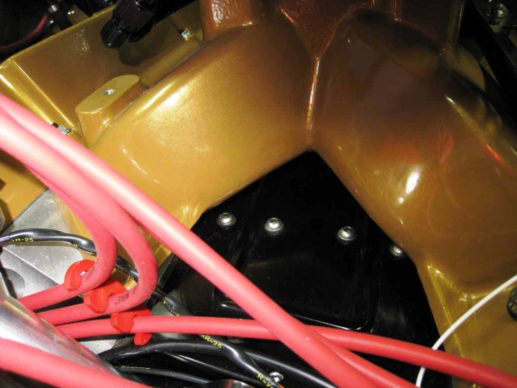

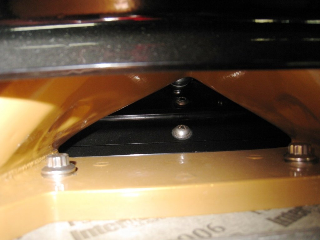

When I was first deciding what I wanted to do with this car and selecting the components for the engine I decided to use a flat tappet hydraulic cam. I realized that this would require specialized high zinc oils or an oil additive or both. I wanted to try to ensure that I wasn't going to have cam lobe/lifter problems. When we assemble these engines we put cam assembly lube on the cam lobes and the lifter faces in an attempt to be sure they're lubricated for initial start-up. The assumption is that after break-in the cam lobes and lifters aren't as sensitive to lubrication issues. The typical break-in procedure recommends a 2500 RPM minimum, this is to "windage" oil the cam shaft lobes during the initial break-in. I believe that I have seen anecdotal evidence that when these types of vehicles are parked for storage, damage can occur on start-up for the new season. A number of friends and associates have had cam issues on vehicles that have been running some time, immediately or very close to the first "fire" of the season. I have seen and heard of enough of these to believe that it's not a coincidence. I believe that we park them hot and let them sit for months and at the end of their hibernation there's not a lot of oil on the cam. Then we fire them up and let it idle until it warms up (who revs a cold engine?), so no windage oil! This is really just a long winded explanation of why I added a camshaft oiling system to the engine.
Below the valley block-off plate (2 piece design) I suspended a center fed tube with a small hole (.012) at each lobe location, It also has a .060 restrictor in the oil supply. In the first photo you can just see the banjo fitting that feeds the oiling tube. I really wasn't concerned about parasitic losses from having the extra oil travelling down through the center of the engine but if it puts to much oil on the cylinder walls and causes oil control problems I'll add a shut-off valve to the feed line. I would appreciate any and all thoughts on this subject, you guys' have a great deal of valuable experience.

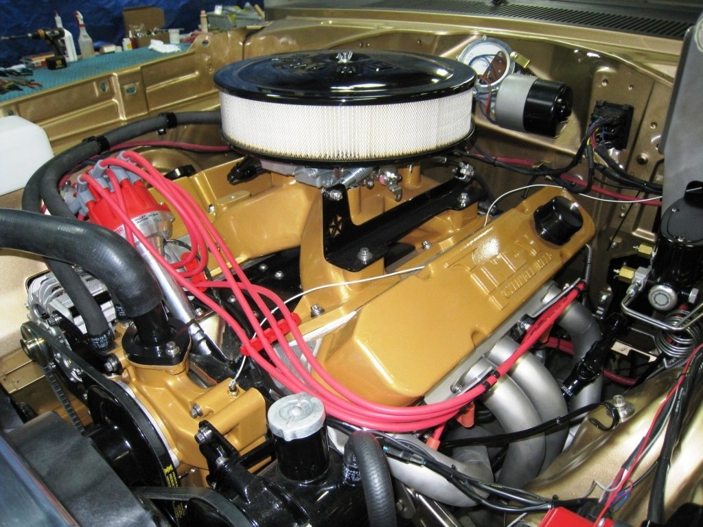

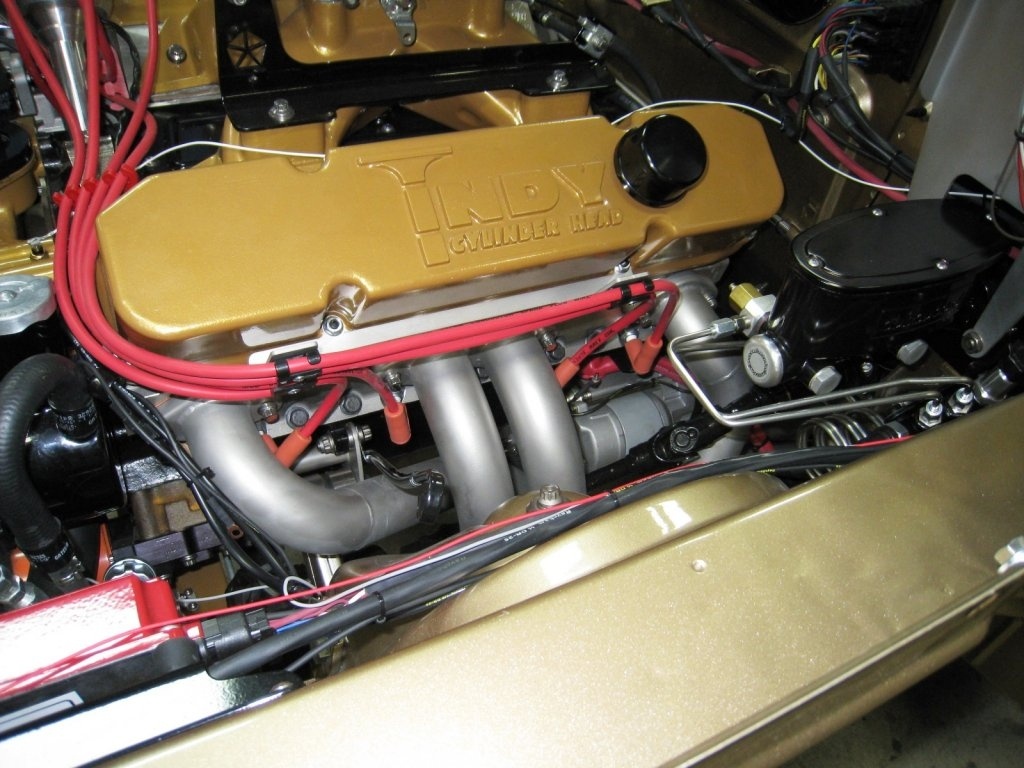

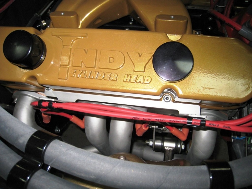

The other photos are just a visual update. We added some temporary gauges for break-in and the loose wires in the pics are for them. I still have to finish my part of the wiring.......the dummy part, mounting the harnesses and extensions. As always thanks for looking, Brian
Interesting..... Don't see why it won't do the job. I'm curious why you didn't try lifters that lubricate the cam? Can't remember which brand it was right off the top of my head but they put a small oil hole in the center of the lifter that lubes the cam, the lifter is pumped up under pressure so.... sounds legit?
Back in the day camshaft failures were few and far in between (other than the notorious Chevy cams) so what's changed? The EPA as always, I honestly think crap oil is the biggest culprit but there's nothing wrong with insurance. I buy Lucas oil and have put 10,000 miles on my current solid lift cam motor.

I did see the lifters with the oil holes in them and I like the idea. Like a lot of things in life I became aware of them after I was done, at the speed I move (unlike yourself) I can't afford to back-up. I thought that those lifters were only available for solid cams but it surely wouldn't be the first, nor last time I was wrong. In retrospect it's attractive to me that this system is easily adjustable for flow by changing the restrictor and easy to turn off if the additional oiling causes issues.
I absolutely agree with your assessment of the "new" oils but I do think there's other factors in play. Modern cam grinds have lifts, profiles and utilize spring pressures that are much more aggressive than our "back in the day" cams. Thanks for your thoughts, Brian.
