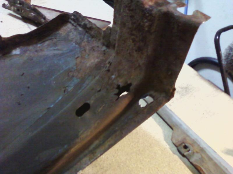

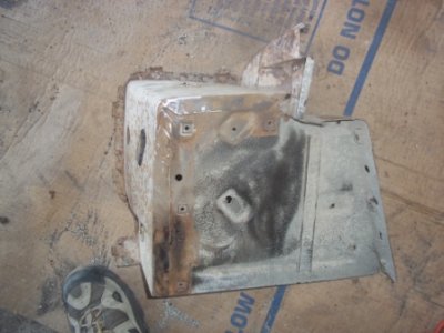

I started working on sheet metal again this weekend for the first time since this fall. Since I have the parts car I now have some of the stuff I need to replace some of my rust damage.

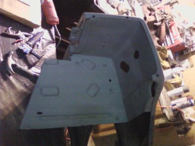

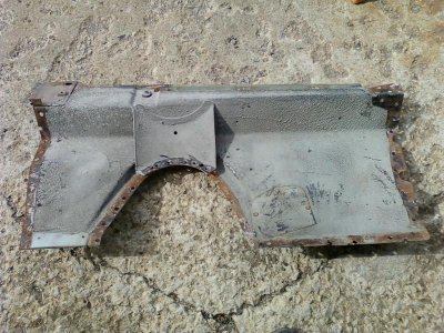

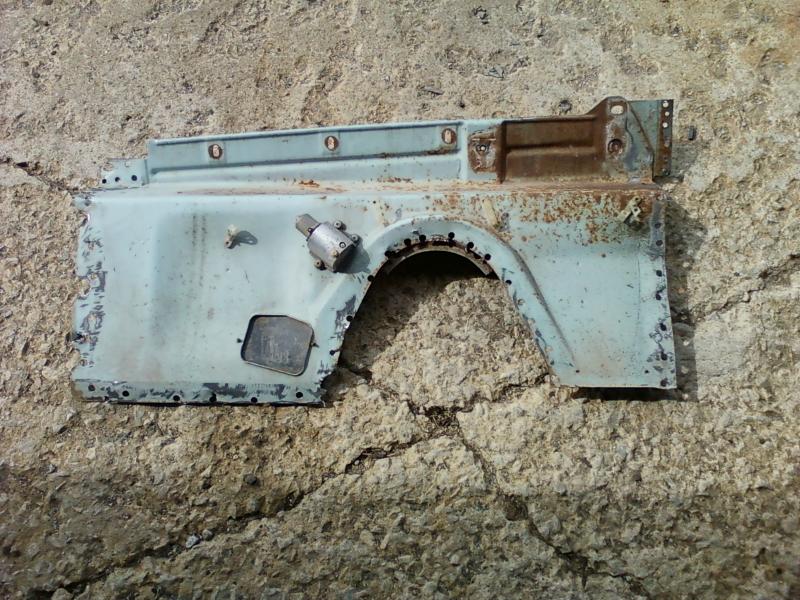

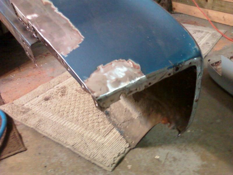

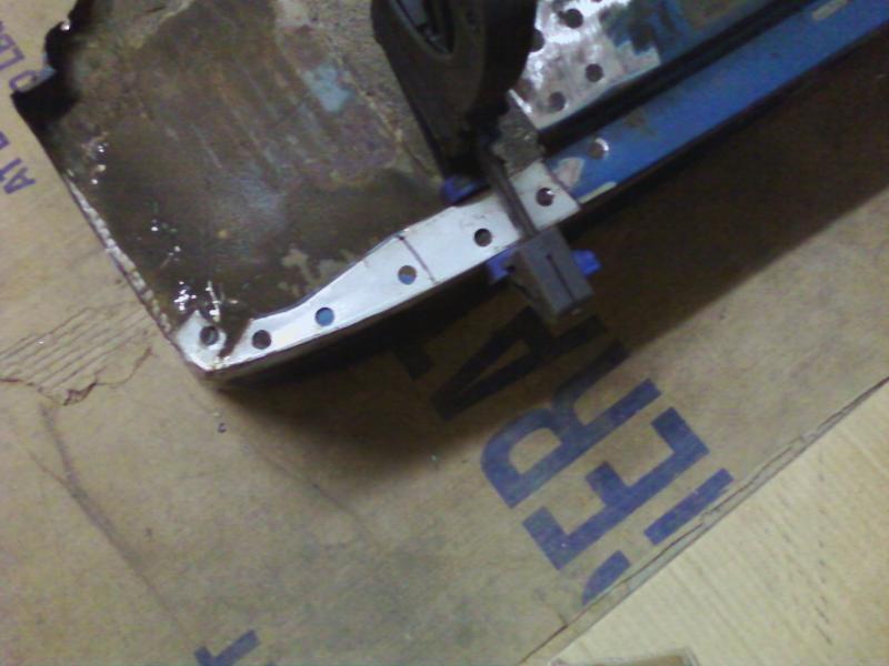

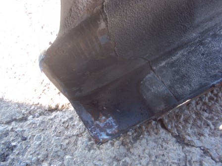

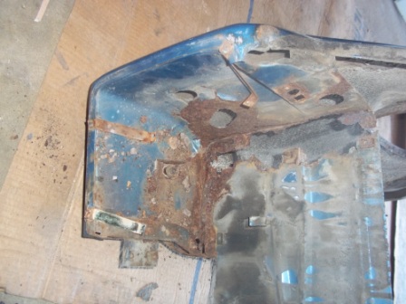

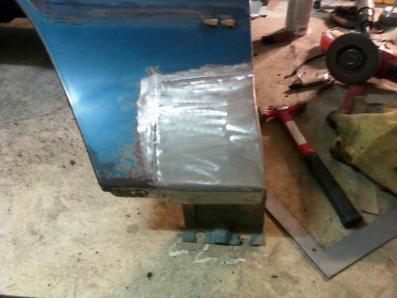

I started repairing the drivers side fender this weekend. The inner structure was pretty bad and my 66 fender was good inside but damaged outside. So naturally I started to mate the two.
The photos show where I got two before I ran out of welding gas.

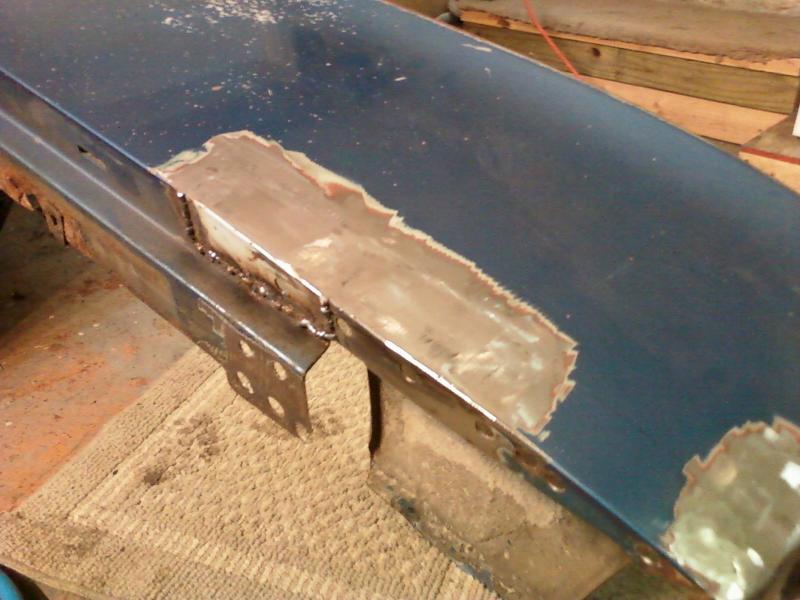

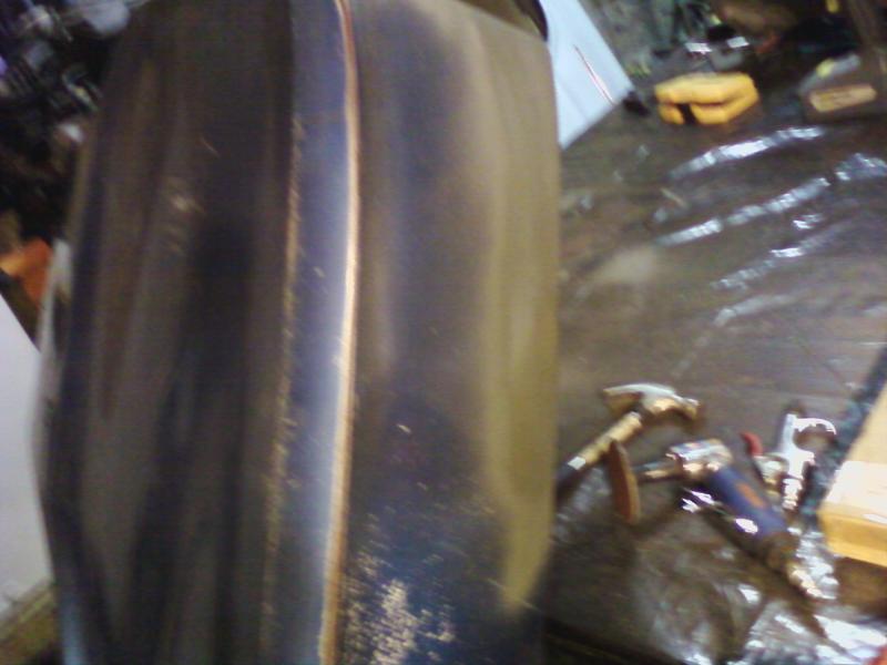

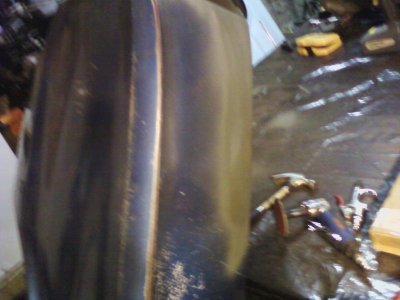

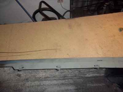

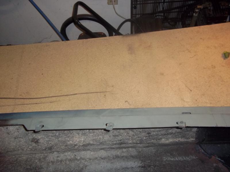

I did some more work last night on the fender. Its amazing how much work it takes to replace rust the right way. Anyway, I took some crappy photos with my phone for your viewing pleasure.

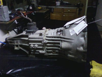

I went last night and picked up my transmission and the flywheel should be here later today. I picked up a NV3500 from the local salvage yard and the flywheel from speedway motors.
I plan to run a stock Ram 2500 flywheel and clutch mated to the NV3500 since the stock NV4500 and NV3500 both have the same shaft diameter and spline count. So with any luck this might be a pretty decent swap that I haven't seen anybody try in a car.
Yes I know the NV3500 is only rated for 300 lbft but in my application with a lighter car and being a street driver my hope is it should hold up for quite a while. My budget prevents expensive transmission choices right now and the only real trans to put behind here to hold the torque would be a t-56 or TR6060. But since the NV3500 cost less than the bell housing...I'm giving this a shot.

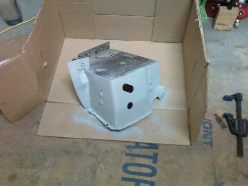

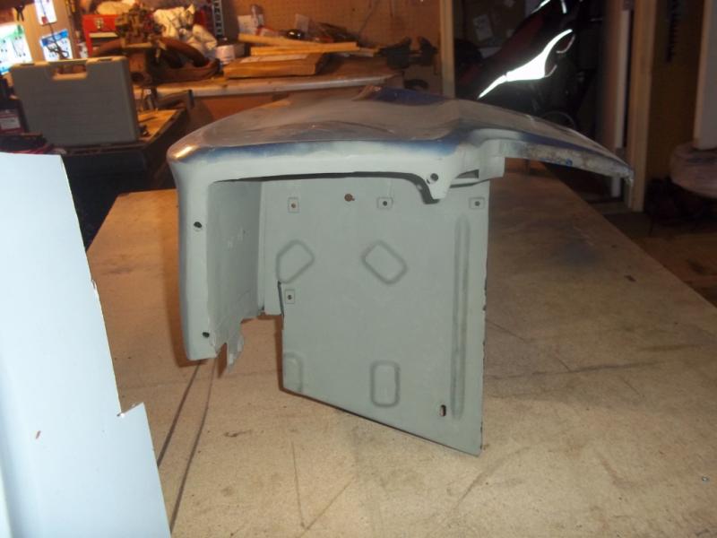

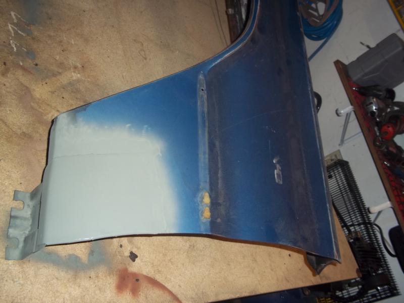

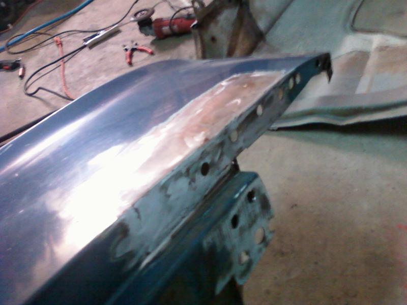

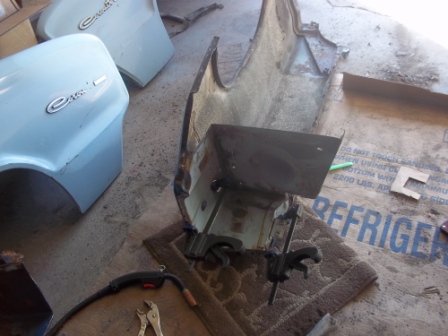

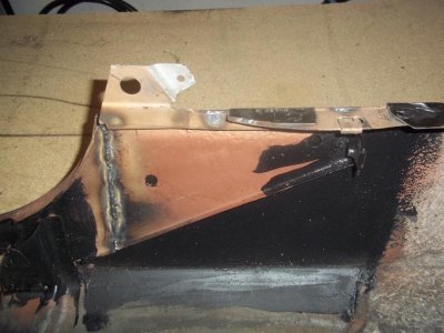

Well I got a little more done in the garage tonight. Only ended up with about an hour and half out there so not much but a tad. I did manage to get the fender welded back together and prime the bare metal until I do body work. I'll add in a photo of the new trans for those of you who are wondering what an nv3500 looks like.

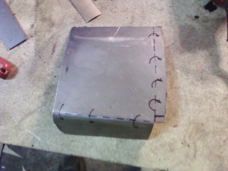

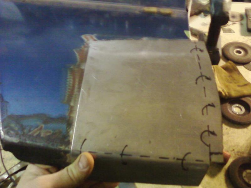

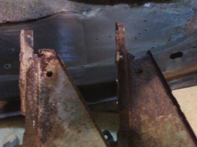

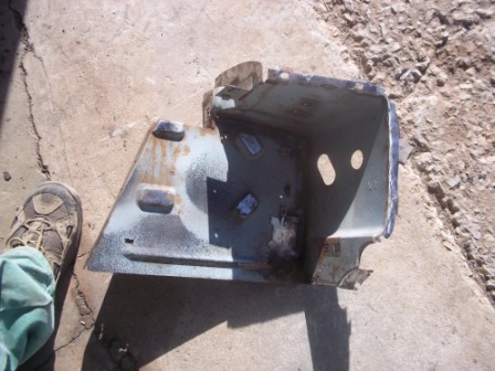

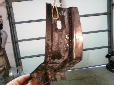

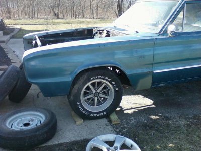

Well I finally wrapped up the sheet-metal work on the drivers side fender. I had to replace the section where it bolts to the inner fenders up top on the rail, the triangle section up top the splash guard bolts to, and lots of work on the lower section and mounting brace. It came out pretty good for me being new to this stuff and for making my own patch piece.

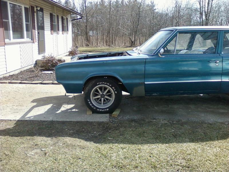

Well its official the car is back up front ready for work this spring. Its out of its wintry resting place in the backyard. I have a bit more work to do on the front fenders then I start prepping the engine bay for the transplant.
Sometime in the next couple weeks I should try to wedge this thing in there.

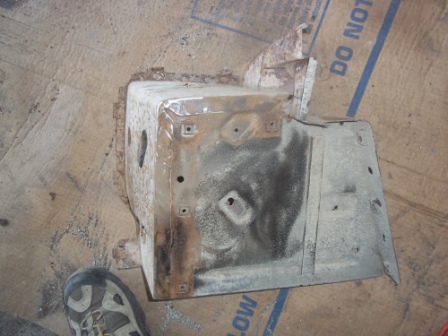

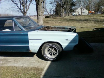

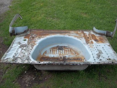

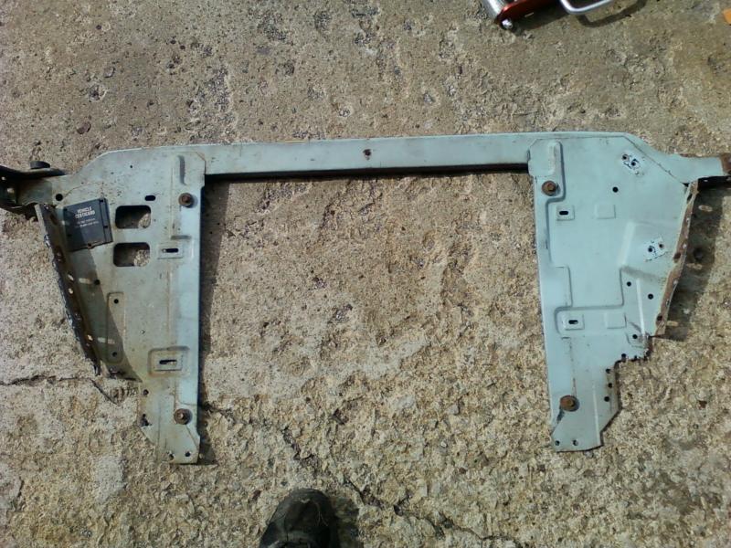

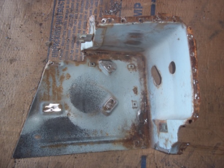

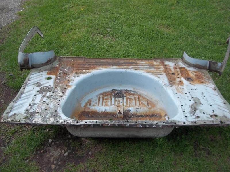

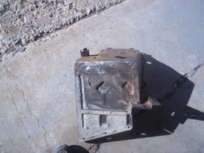

Well I got some work done today. Nothing really to the 67 but I started pulling necessary parts off the 66. Some for sale some for use on the 67. I have decided to get what I need from the 66 now and put whats left up for sale to get it out of my hair. I'll be robbing the trunk and all the chrome parts, door hinges, and doors (for patch panels).
Here's a couple photos of some of the parts I took off and the 67 with the fenders temporarily put on, just for looks and space saving.

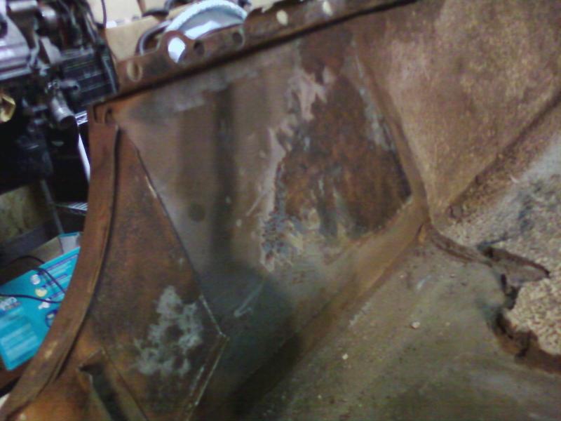

This weekend the intent is to strip the floor out of the 66 for parts/patches on the 67 and then I am starting the tear down of the rest of the rust on the 67. Once I am satisfied the 67 is structurally sound in the rear end and rust free I will officially start making motor mounts!
