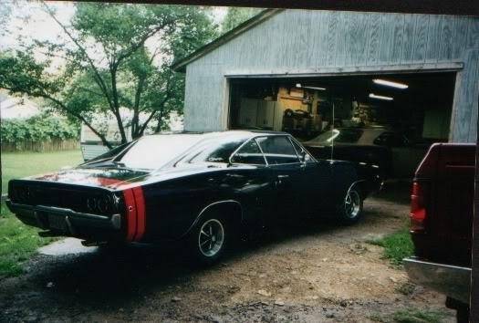

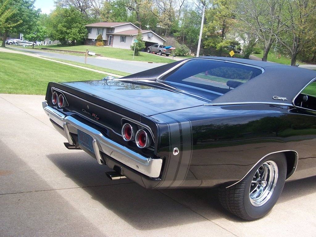

Basket Case, the picture you posted is supposedly what this car looks like. Thanks for clarifying things for some of the other members. And I believe you're right on the Scat Pack / Bumble Bee thing. It was how they marketed it.

Seller sent pics to their cousin who was at my 4th. of July BBQ today. (See attached.) Good news is that the car looks in great shape, the bad news is I can't make out the VIN code on the photo of the tag. I also don't have a price yet. I will contact him tomorrow.
