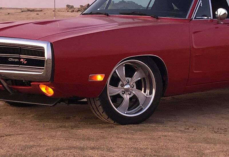

I run a 275-40-18 up front and my tires don't rub.

I have mine aligned to .75 degree NEGative Camber, 4 degrees of POSitive Caster and 1/8" toe IN.

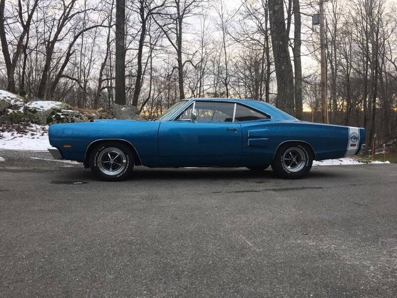

Seeing your post makes me think I can fit a 275/40/17 on the front of my 69 superbee. What do you think? Any negative side to such wide tires in front?
Thinking
17x9.5 5.5backspce 275/40/17 front
17x9.5 5.5 backspace 285/40/16 rear
** rim is also available in a 17x8 4.5bs
Maybe that would be better for front ?
would love to hear opinions

Any negative side to the 17" wheels? Only the rude comments from dudes that are stuck in the 1970s where they think that 15" wheels were the pinnacle of styling and technology. My car outhandles, out-brakes and in my opinion, looks better than it did with 15" wheels and tires. The 275-40-17 will be at least an inch shorter than my 275-40-18. I have a 9 inch front wheel with 4.5 backspace though. The only rubbing I get is at the frame rail where the tire rubs a flat smooth section and wears off the paint.

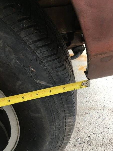

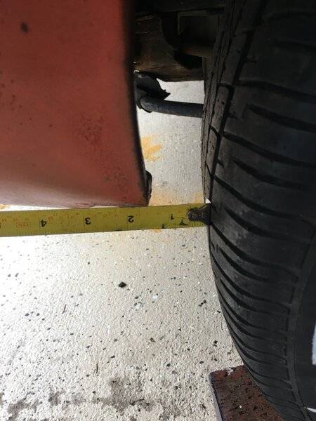

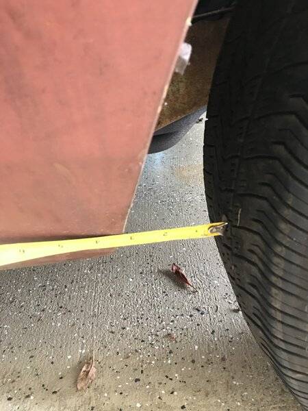

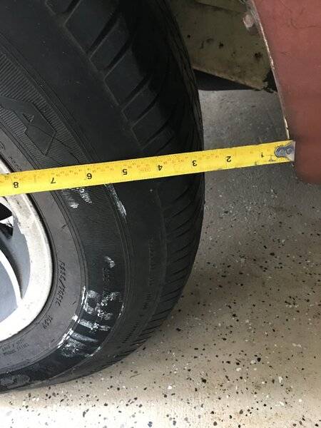

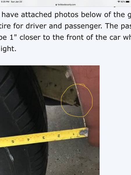

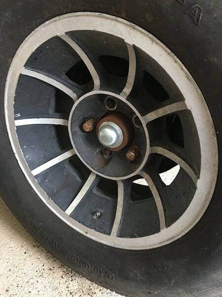

I am not sure of the history of the car and do not think it has been aligned in a long time. Tire size is 235/70R15. American racing vector rims I believe, backspacing 3.75". I do not think the front end is sitting low. When I did the front brakes I just installed the spindle and discs. I have attached photos below of the gaps between the fender and tire for driver and passenger. The passenger side tire appears to be 1" closer to the front of the car when the wheels are pointed straight.
Driver_rear.JPG Driver_front.JPG Passenger_rear.JPG Passenger_front.JPG Rims.JPG
Is this frame rot? If not, a strut rod or something is bent.
No there is no rot in that frame rail. Looking at the strut rods fron under the car they appear straight. The photo you have circled is the driver side btw. I may just try adjusting/loosening the eccentric bolts of the upper control arm and see where that gets me.
