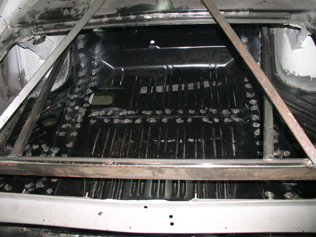

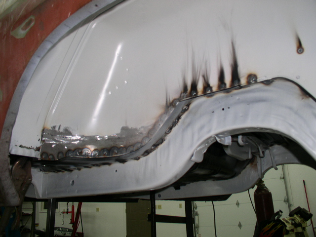

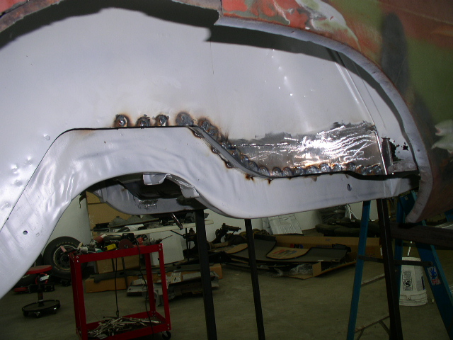

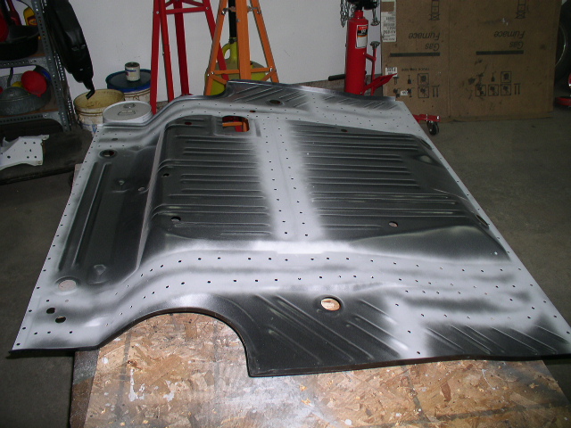

Can you believe 260 5/16" holes in my trunk pan? This is not counting the flanges for the drops. I guess it shouldn't fall out of there. It fit fairly well with the only complaint I would have is the down turn flanges that attach to the inner wheelhouses should be longer. There is a portion that is only about 1/4" flanged. Kinda hard to make a nice looking 5/16 plug weld in that area.

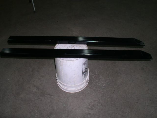

Also cut my frame connectors from some 2.5 x1.5x 1/8" tubing. This works good on these car, fitting snugly around the front of the rear frame rails and butting to the torsion bar crossmember. I will weld these in while the car is all braced up.

Hi Elk,
How did you get your trunk floor in? It looks like it is a full pan and with all that bracing it doesn't look like it would go in, unless you slid it in from the rear tail panel?
Hey Don,
We cut out the metal between the taillights to get it in. I think I posted a picture of this. It just fit under the 1 x 2.5 horizontal brace you see in the picture - we planned for this. By doing it this way, all the tailend structure was intact. Welded the truck pan to the new frame rails and then welded a brace on each side down from the horizontal 1 x 2.5 to the new floor on top of the frame rails. This kept everything in check before cutting any pieces on the rear of the car off.
Thanks Elk, I will be doing the exact same thing you did (donor rear frame rails) and will brace it up as per your example.
I guess I need to get a floor pan 1st so I have something to measure and I can brace it up so it can slide in from the rear.

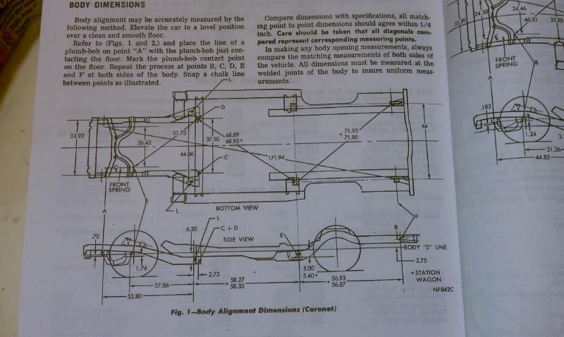

I bought a 68 charger service manual and look what I found., should be the same or near 69 & 70. Looks useful but may have to improvise it on side view for not having any axles or wheels & tires. I think coronet is same as charger.

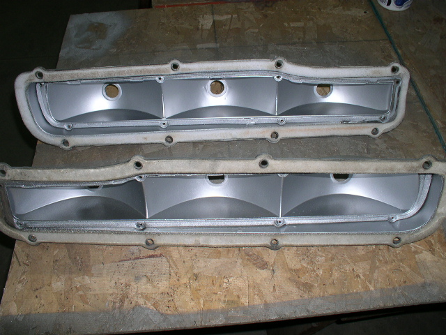

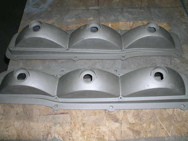

Finally got a little weekend time away from work and the kids to spend on the car. Got the taillight housings painted up nice.

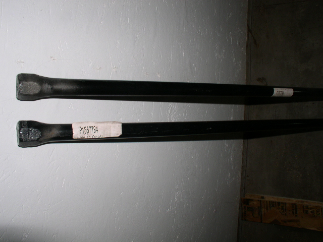

I ordered a set of .960 Mopar Performance torsion bars form the local Dodge dealer. $232. plus tax which was the cheapest I could find. My car originally came with .920 and these new ones are quite a bit beefier. I had thought I had a problem with one of my old bars being that it was slightly bent. There was a recent thread on here where I think RRR said this is normal and will go back straight when back in the car under load. I guess I won't find out now that I have a brand new set of HD ones.

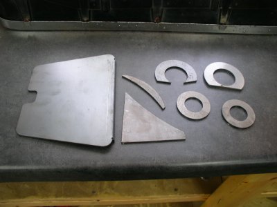

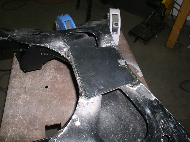

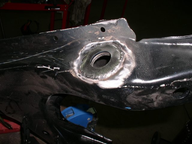

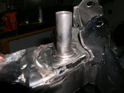

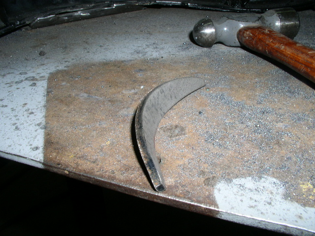

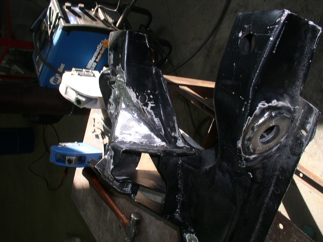

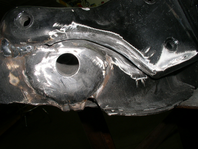

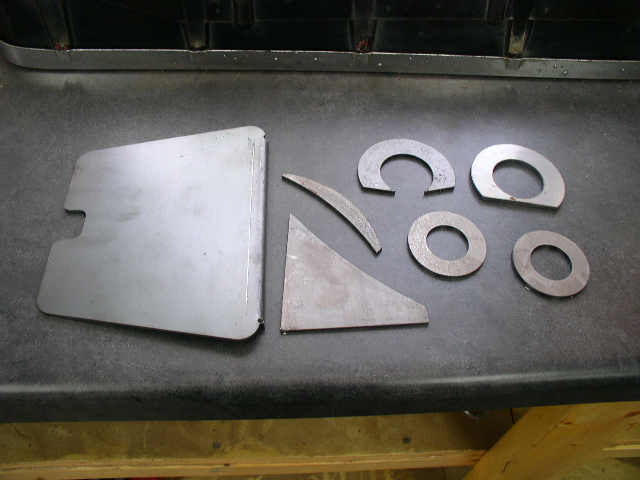

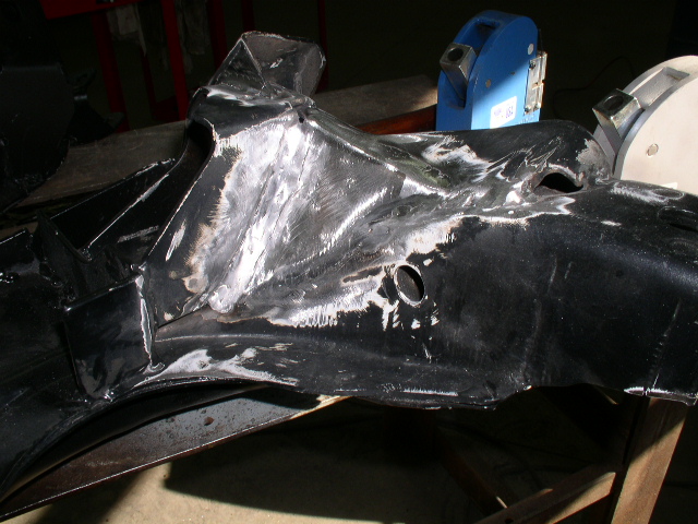

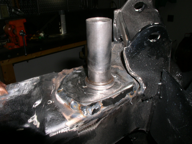

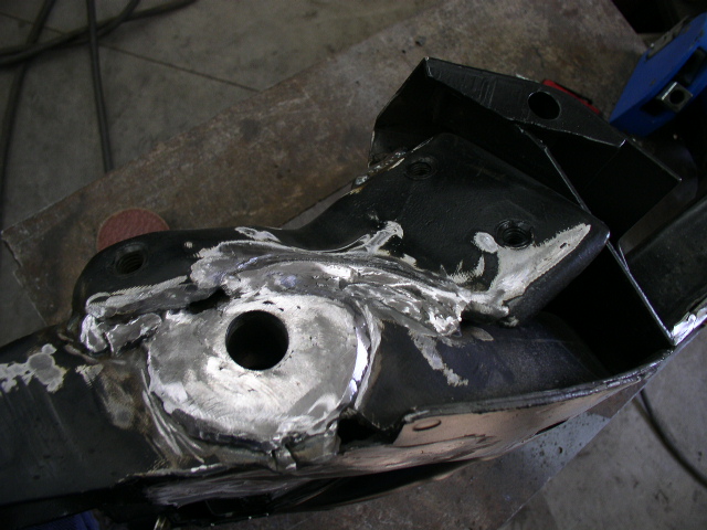

Since I am redoing all my suspension parts I decided to order a k-frame stiffening kit from Firm Feel. It is a 7 piece set that consists of a skid plate, reinforcements for the lower control arm shafts and strut rods, and 2 pieces to box in the steering mount. I think they are making pretty good money selling this for $75., but it all fit good. I also ordered the lower control arm stiffening plates from PST and should have those this week.
