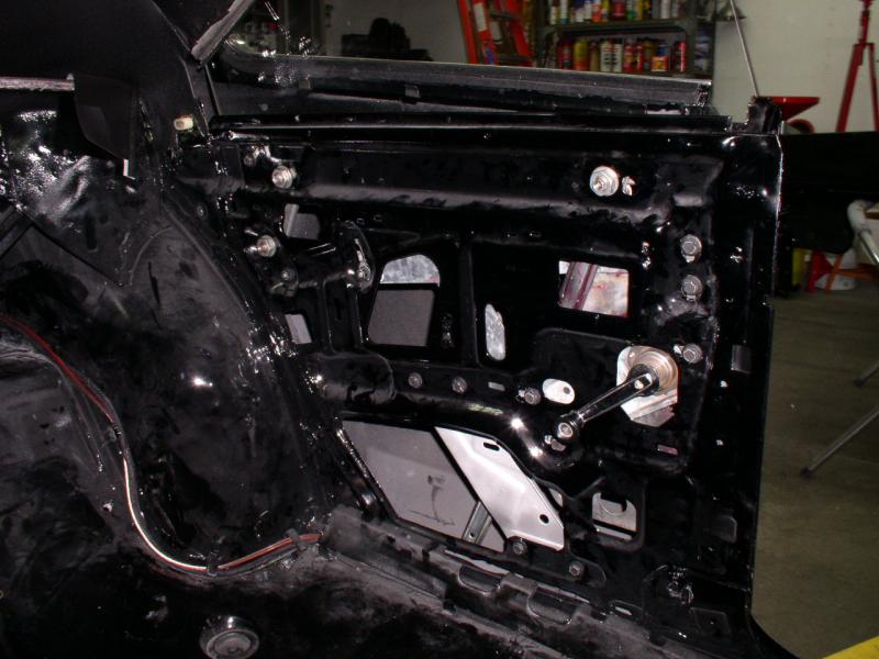

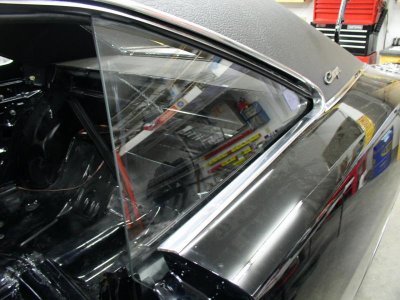

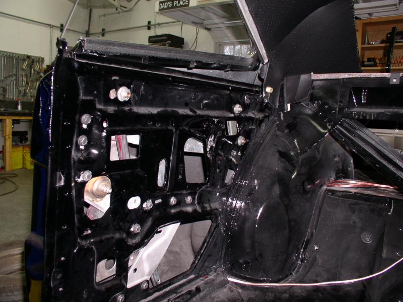

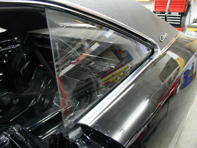

I spent my Saturday working on the quarter windows. I almost feel like I let you down Devin, as 15 minutes didn't get me to far lol. But I have to thank you again for the detailed description and pictures you posted in your thread regarding these. Made everything go much easier. I had some cleanup time, replacing a couple of rollers, and adjustment also included, but nothing to serious. Just a scraped up arm from the first side before I figured out the tricks, and one of the roller clips that I managed to lose down into the rocker - but everything fit and even works. :headbang:

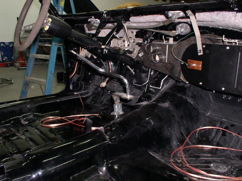

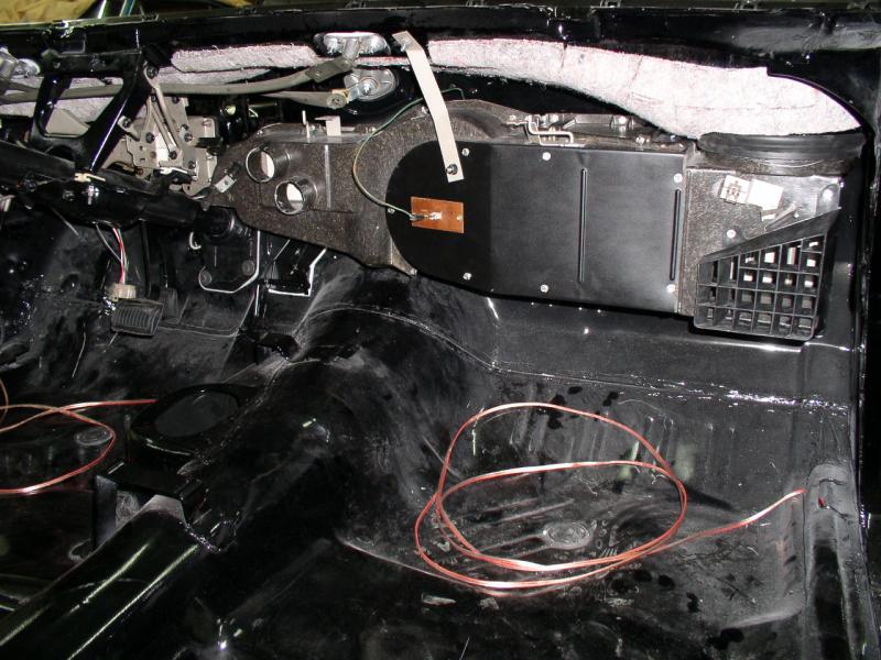

Also managed to get the heater box installed.

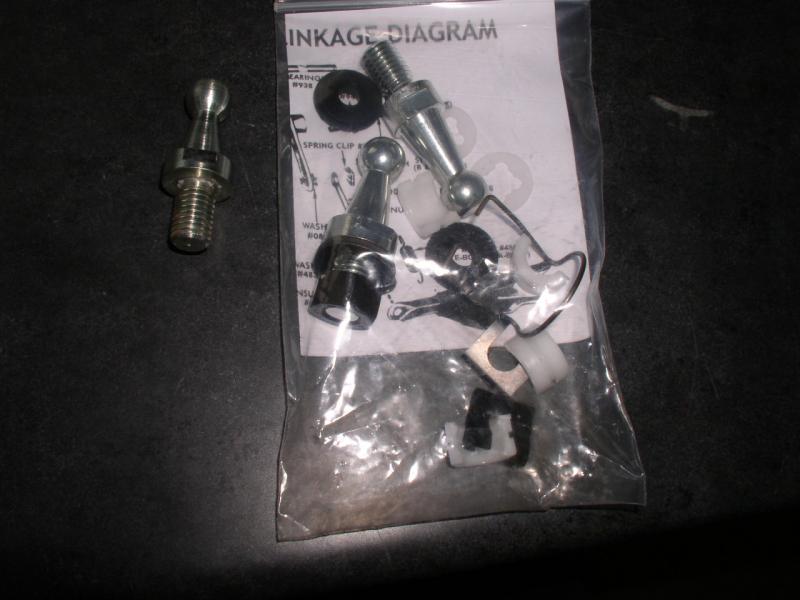

I know some of you don't much care for Year One, but I think their customer service is second to none. As I have been working on this project, I order parts that I know I will in the future to save on shipping costs and throw them on the shelve. I bought a z-bar rebuild kit from Y.O. 1 1/2 years ago and just opened it up and noticed I was missing the nut and washer that holds the stud to the frame. So I call them and explain what I need. They said it would be taken care of immediately. 2 days later I get an entire new kit instead of just the 2 pieces I needed. How's that for service?
I am only bringing this up because I ran into a similar problem with a fuel sending unit I bought from In-Line Tube at about the same time. I pulled it out of the unopened box 3 weeks ago and ohmed it out before installing it in the tank. It was so far out of wack that I wouldn't even think of using it. So I called them and after a couple of hours I get the answer that they cant do anything for me because of how long ago I purchased it and I should have checked it out immediately. Now on this order was also the entire brake lines, e-brake kit, fuel and return lines. So it wasn't like I never have boughten anything from them. So I told them I would buy another one from them. This one came a week later and ohms out perfect. I stuck my first one in the new box and sent it back saying it was defective after getting a return authorization # from them. After 2 weeks and several phone calls, I have finally got a credit for the sending unit, but they wont reimburse me for the extra 2 sets of shipping charges. So I end up with an additional 20 some dollars for a product that was defective from the get go. Two different business' ways of handling a problem - I know who I wont ever be buying anything from again.

Frustration with incorrect and non complete packaged parts is another discouraging part of the build. I experienced the same issue with auto anything on 4 slotted rotors I ordered and they were delayed on shipping but I was not notified. When I called to find the delivery date they said they just shipped. I canceled the order but had to pay the return shipping which was over $45.00. Customer service is # one with all of us. Oh these were for a work truck not the charger.
"Cool" Glad to see your getting it together. I've had really good luck with companies standing behind there product so far but that would piss me off. I wish I would have ohmed mine before putting it in but hadn't heard about all of the bad ones yet and just didn't think about it:sleepy2:. I've put 5 gallons in it and it barely moves the gauge so I'm hoping it just has that much of a reserve haha, if the rest of the car is an indication I'll be pulling the tank:angryfire:. Enjoy
Thanks for the example of the two companies Customer Service ( wait, on company - guess the other on is Customer Non-Service ( SMILE ) ) - will keep it in mind.
Great job on the windows - they look really good ! ! Bummer about the arm - but I think we've all been there.

Great up date H2E and thanks for the tips on both companies. I know which one I'd buy from after considering that. I have ordered from YO and last was just recently I bought a set of Conv top locks and anti rattlers and a bunch of other cool stuff since it was a 30% off sale.
I got an email stating everything except a RR horn button was out of stock and would ship separately. I was thinking of calling to confirm they wouldn't charge me separately for the split shipping or cancel the horn button since it was a cheap part so no big savings and shipping it would cost more than it cost.
Well I didn't get around to it and got the first shipment right away. I got the horn button a few days later with a note saying they don't charge for separate shipments if a part is out of stock. I thought that was pretty cool.

Good to see you making some progress. Sometimes doing the little more time-consuming things (rear window) are more gratifying when you get them installed then the bigger stuff on these cars.

Nice battle scars from the quarter window war too lol! Good luck with the big drop-in man, and like everyone's gonna be saying.. "watch the paint!"

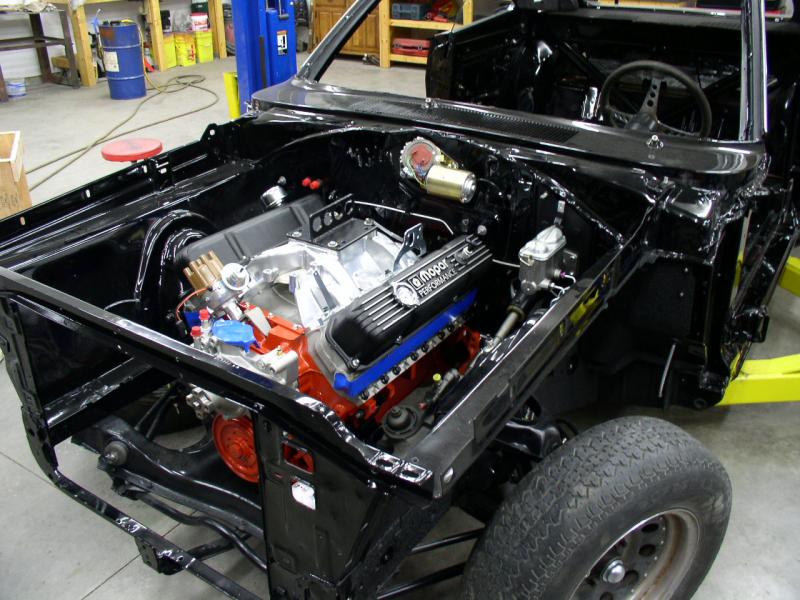

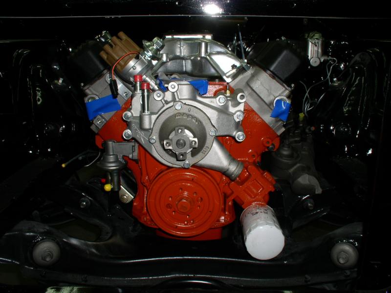

Got a good day in on the car today. Motor, clutch, bellhousing, tranny, and shifter are in. And not even one scratch in the paint :hello2:. Got the shifter adjusted, the wheels back on the car and let down to put some weight on the suspension. Torqued all the front end parts to spec.
DOGGONE!!!!!!!!!!!!! You work fast.Looks good sitting in there. Any idea on when the rest of the sheetmetal will go on?
Nice!!! awesome progress man, and I'm with rrman "that was fast!"

I was waiting on the front end sheetmetal until the motor was set in. Just thought it would be easier and less chance of scratching the fender tops.
Hopefully this question isn't going to cause you a setback, but are you going to be able to get your headers in with the engine and trans fully installed already? Not sure how TTI's are but I know I wouldn't have had a snowball's chance in hell of getting my Hedmans in if Ididn't have them hanging loose on the engine as it went in. Either way it's looking outstanding as always elk!
The tti instructions say that the torque shaft has to be out and the left side of the motor raised an inch, and that is it - but we will see. I will just use the cherry picker to lift the motor while the car is up a couple feet on the hoist. That is the plan right now at least.
