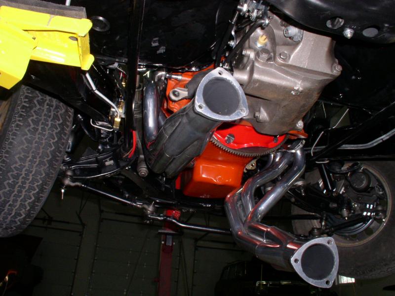

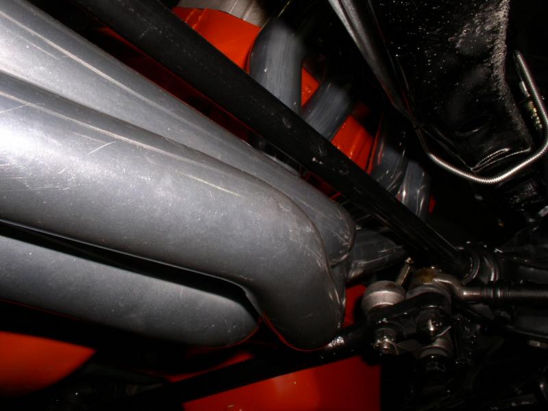

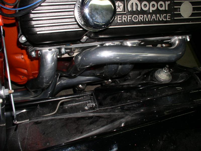

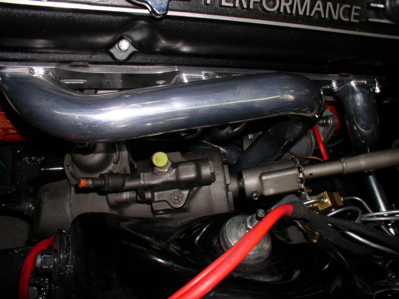

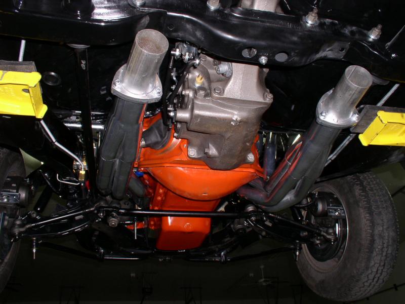

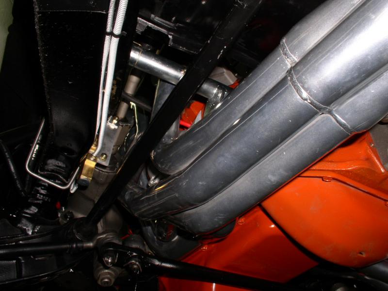

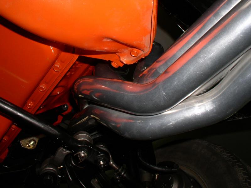

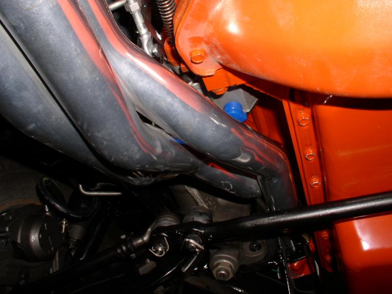

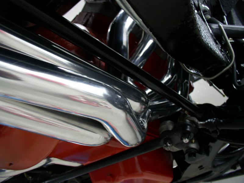

Spent a joyous couple of evenings getting the new TTI 1 7/8" headers installed. It didn't go quite as easy as the instructions would lead a guy to believe, but they are in. I ended up having to pull the motor mount bolts and raise the engine until the bellhousing hit the firewall, and then dropping the steering link. Oh yeah, and then there was all the extra room left over to get the starter wires on. I sure am hoping I don't ever have to replace that. After getting them in, I realized how nice they fit. It is close in a couple of areas, but nothing terrible. No hammers or torches to make things fit was very nice :hello2:. Next up will be the exhaust.

Those are sure purdy. Nice work!
The Hookers I installed on my car a few years ago required both motor mount bolts to be pulled, motor raised and center link dropped too. The cheap Headmans that were junk didn't require that much work when I first put them one. Header wrap killed those.
BOY, you weren't kidding when you said they were tight. I like the shot of them under the car.
I knew you were gonna have some fun with the em haha congrats on getting them on though, they look gorgeous on that engine man!
Yep - you were right Speedy, definitely wasn't as easy as I anticipated.
They are tight, but fit real nice. I have to imagine that the 2" and 2 1/8" would be a major headache.
They do look good in there Hunt. Headers are never fun to deal with but at least it's over and you can finish the exhaust. I can't believe how fast she's going back together. Keep up the good work.
Wow...Those headers look slick! I might not have caught it, but how did those brake lines fit for you?
The brake lines worked out fine Will. After the ordeal of buying the correct small jumper line from The Right Stuff because In-Line wouldn't sell me one :shruggy:. I need a couple fuel lines between pump and separator and carb - I'll be getting those from The Right Stuff.
Dam h2e that looks sweet. Looks like you will have to invest in some mirrors for the car shows to show off the underside too. Just gorgeous.

All I can say is "that sure is Purdy". I think it's a givin "headers and torsion bars don't mix well" always going to be a struggle regardless. Looking good
