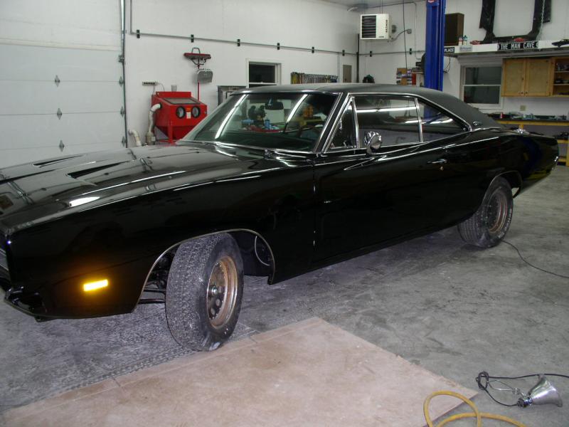

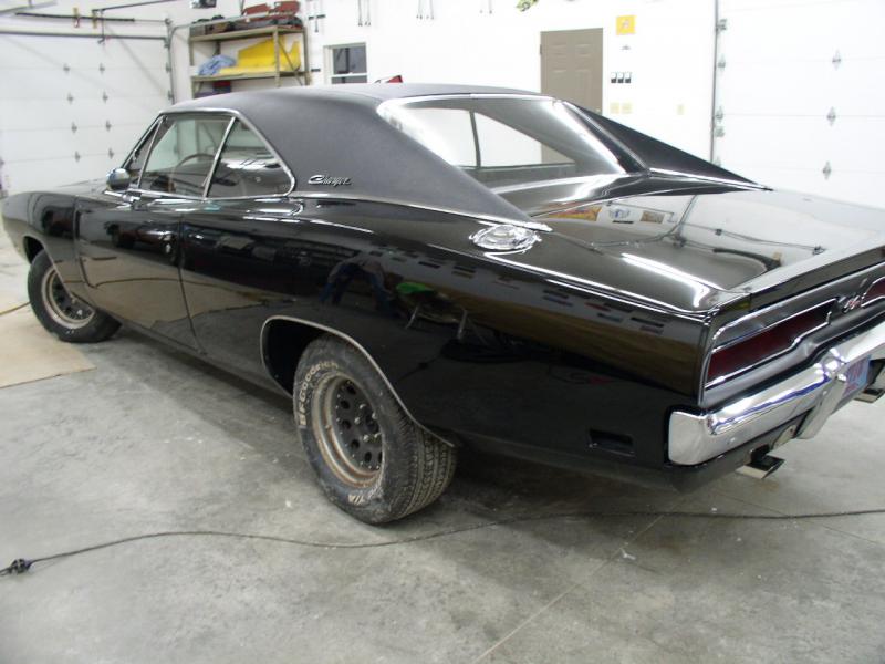

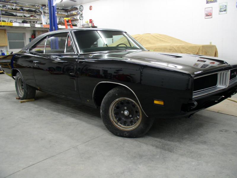

Thought I better post an update of the resurrection. I do have a little tip for those of you wet sanding and buffing your cars - do it before you bolt absolutely anything back on the car. I've spent every evening this past week cleaning the white film from every nook and cranny I can get to and then reinstalling the exterior trim. It really did turn out nice, and hard to get the full effect in a picture. This thing had to buck a little more though. We lightly sprayed the car down and washed it between buffing steps. After opining the doors up after 2 weeks, I was greeted to water on the drivers side floor. A little investigation last night revealed a stream coming in the from the lower windshield corner :angry5:. I swear to God this thing is possessed sometimes :devil4:. So I have to get the window guy back out here, pull the trim, and load the channel with more butyl.
Sweet! She looks like glass joel. Good to see it turned out so nice for you. Kicking and bucking like a stubborn horse...won't be long and you'll be braking that filly.
Absolutely beautiful, sorry to hear about the windshield leak, what a pain. I had a leak at my back glass when I was done with mine and it had to be pulled to reseal, so I know what your feeling.
Dang it H2E . . . I think you could shave in the reflection of that paint job . . . that turned out GREAT ! ! ! !
Now it's time for me to say . . . are we there yet ? ?
Looks great in the pics, I'm sure it looks awesome in person. Like the wheel choice, gives it that 80's vibe. :toothy9:

The reflection is just awesome. It actually does a double reflection off the white garage walls - you can see the opposite wall of the garage in the car when looking at it right.

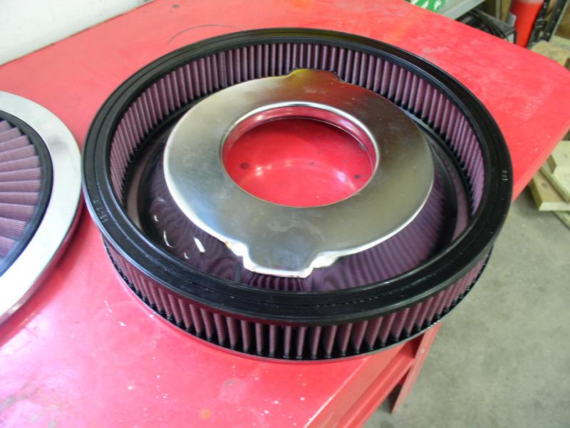

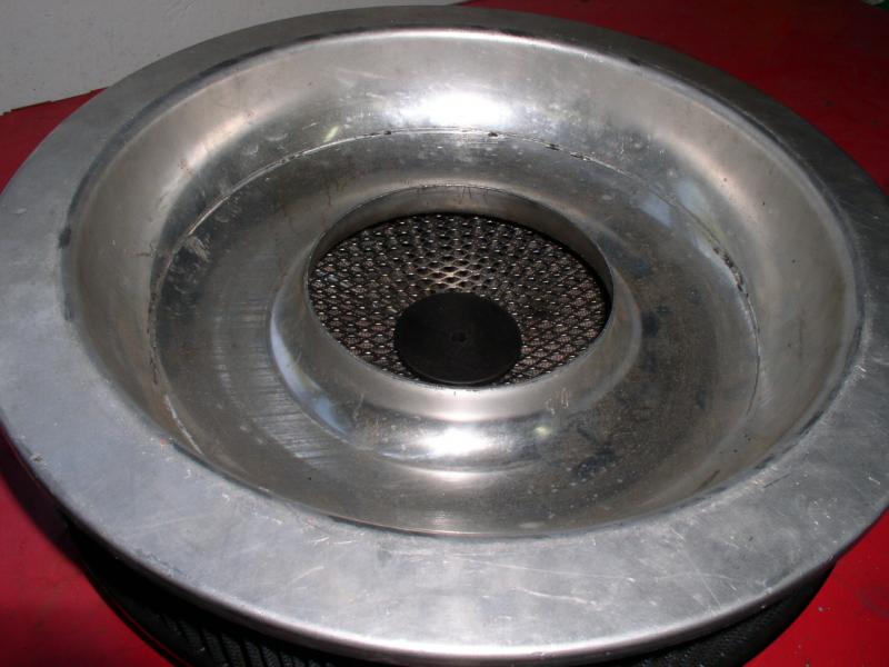

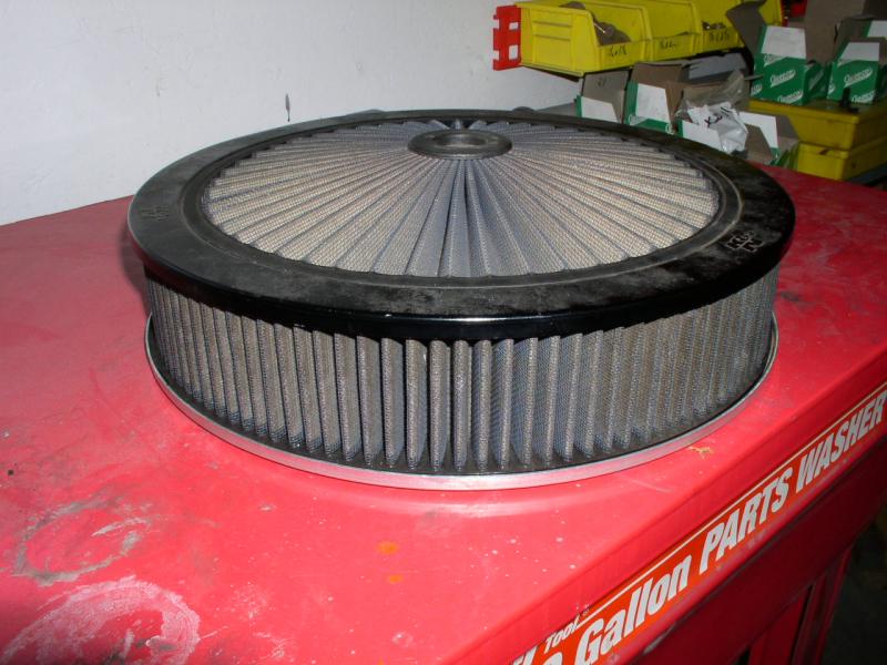

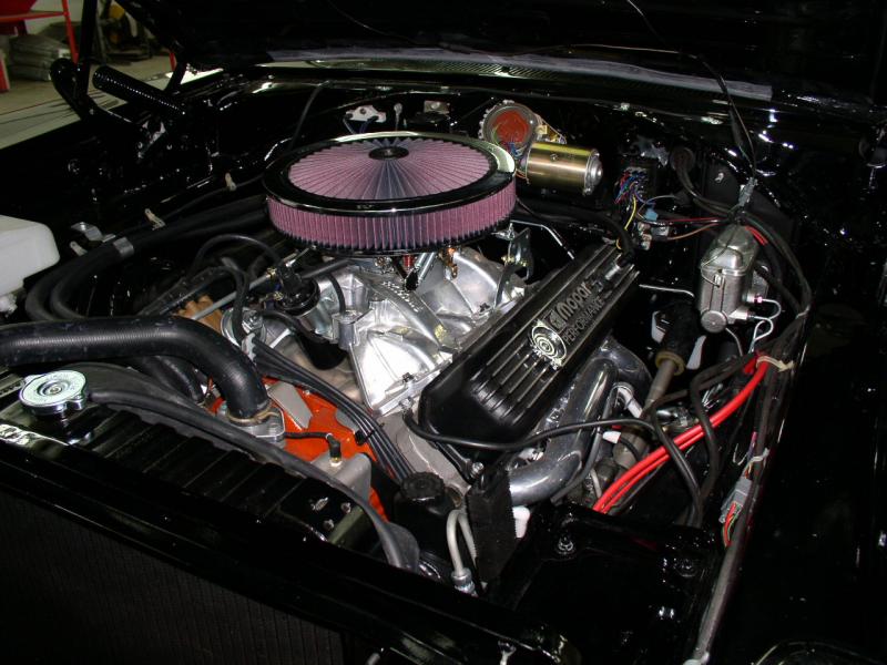

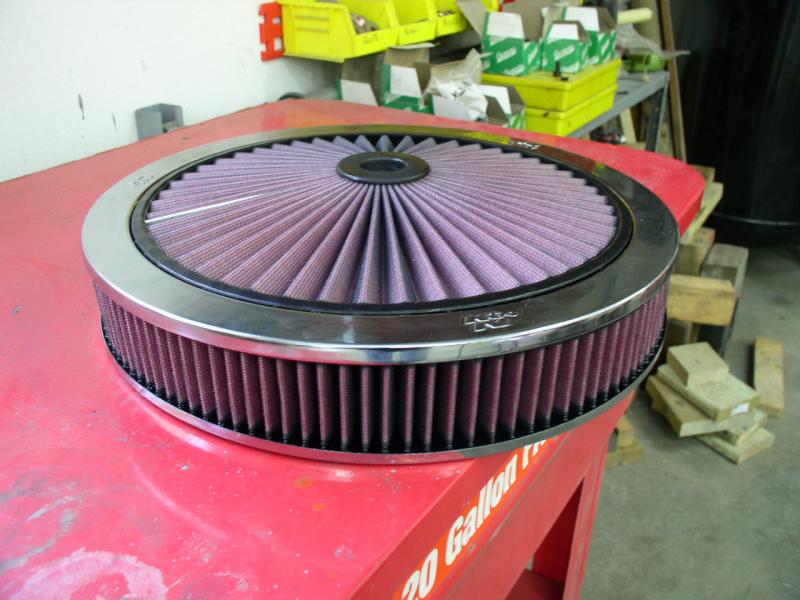

Play day in the garage today and as luck would have it my air cleaner parts showed up from Jegs. I am happy to report that this portion of the soap opera is over and I am as satisfied as possible without being able to use a pie tin style unit.
The 2nd to the last unit I tried was made by Spectra. This model with the Proform drop base was still .75" taller than I could use, so it went back to Jegs with no questions asked.
A friend had an older Proform base that he was using on his Duster which we compared to the new one he bought for me. Come to find out the older style has 1/8" more drop built in. So he swapped me his. With this base, a 3" K&N 3737 triangle type (not the standard 3-1/16 1650), and a K&N top, I had about .75" clearance from my stud to the hood. This set up gave about 5/16" air flow around the horn. My buddy is using this on a 650hp motor.

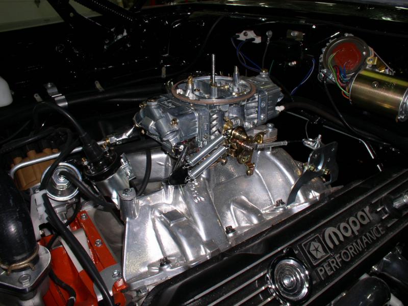

While talking to K&N, they gave me the idea to try my Holley drop base(1.25"), their top, along with their 3740 xtreme 2-5/16 element. This is what came today. I had to shorten the 2 air tubes on the top of the carb and was able to straighten out my throttle return setup. This combo sits a good 1/4" lower than the previous attempt. It also has about 7/16" of airflow around the horn. I now have a solid 1 1/8" clearance to the hood. I can live with that, but don't think I will install my hood insulation pad on account of relying on a lot of air flow through the top.

Good to hear she fits. Those air cleaner post's/pics's you posted should be a sticky. Seems to be a pretty typical problem with Gen II Chargers with anything but a stock height intake.
