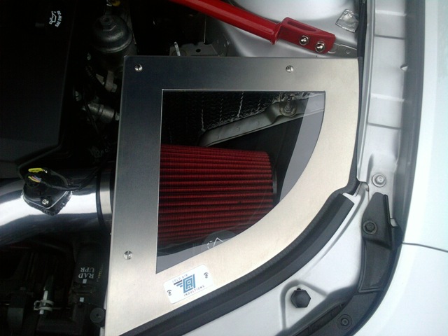

Hey H2E . . . here's a wild and crazy idea . . . just a thought . . .
What about changing it up and making it a Cool Air setup ? ? And you could place the filter like this ? ?
Just throwing the idea out there . . .
You already know I think outside the box . . . or in this case, inside a box ? ? ( smile )
That would solve my problem, but it is a little to modern looking for me - no offense.

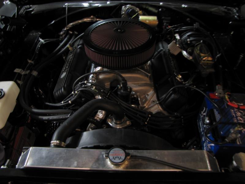

Going off the machinist puddy test, I got me a whopping 1.4" of clearance. I looked up the Summit Racing receipt from the drop base, I was mistaken, it's a Keyser MFG 1.75" drop base, not K & N. It is a K & N 3" Filter and Element top. I'm running an Indy DP intake, so i'm about .250" shorter than your eddy. No hood pad.

As far as clearance RR vs. Charger....the 68-69 roadrunner is known for just a tad more clearance than the 68-60 Charger. That's coming off Dodgecharger.com. I would think with a 2" Drop Base, you would have no problems. I know when Pettyblue72 was around he ran the same Intake/Carb as you with a 2" spacer on his '67GTX and it fit fine. And those aren't known for great hood clearance either. I don't know how you could manage a hood pad under there, that's a tall intake.

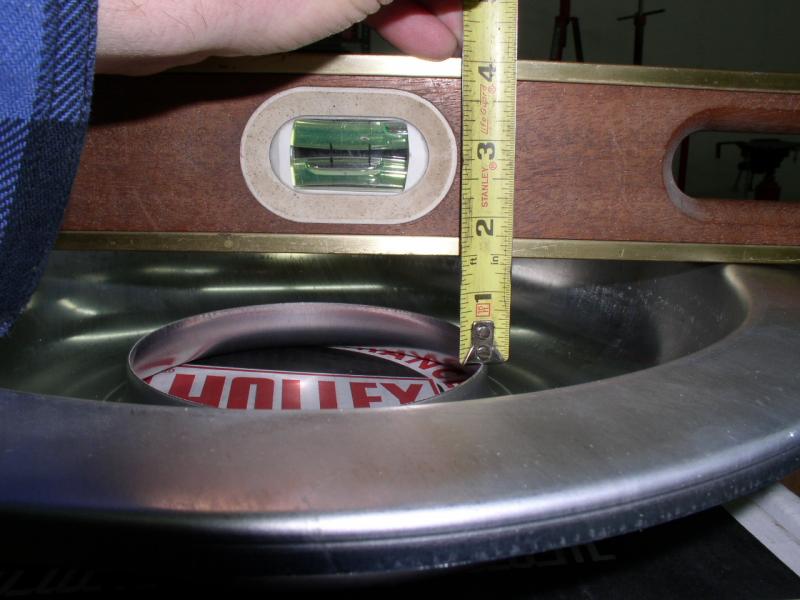

Ok Will, last question I am going to ask you about this - fingers crossed. Here is my Proform base and measuring like this I have 1 7/16". Does your Keyser measure much more than this? I've already bent my throttle return bracket way down and think much more of a drop will be interfering with my throttle linkage.
Joel,
Just got done measuring my base out. Keyser was being a little optimistic about their 1.75". I got 1.5", maybe a 1/32" over .5
I have the throttle return spring set up like yourself and had to do the same, or the springs would have been rubbing up against the bottom of the base. Anyways, IMO for maybe a tenth of an inch, don't think the Keyser would be worth $30 bucks to ya. Heck a little trimming on yours and you'd easily be where i'm at. One thing I will mention is just like the spectre and eddy filter lids, the K & N lid also pitches up a tad. Finding a nice flat one might give you another 1/4" or more. I would imagine you would need to trim down your carb bowl vents a little, which isn't a big deal.

Thanks Will - you're the greatest! I thought about grinding the bottom flange of the base too. I think I should be able to get 1/8" off and still clear my throttle linkage. I'll make that decision once the Spectre arrives. Regardless, I wish there was more room under there.
