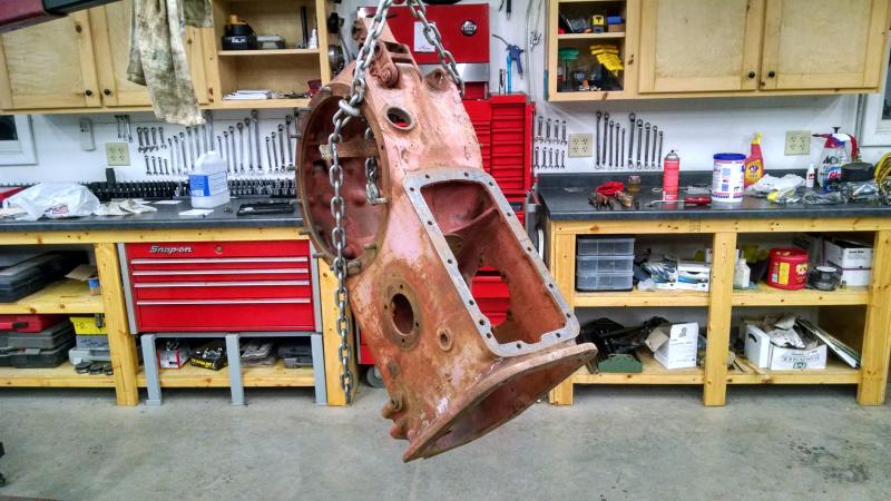

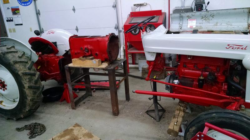

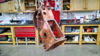

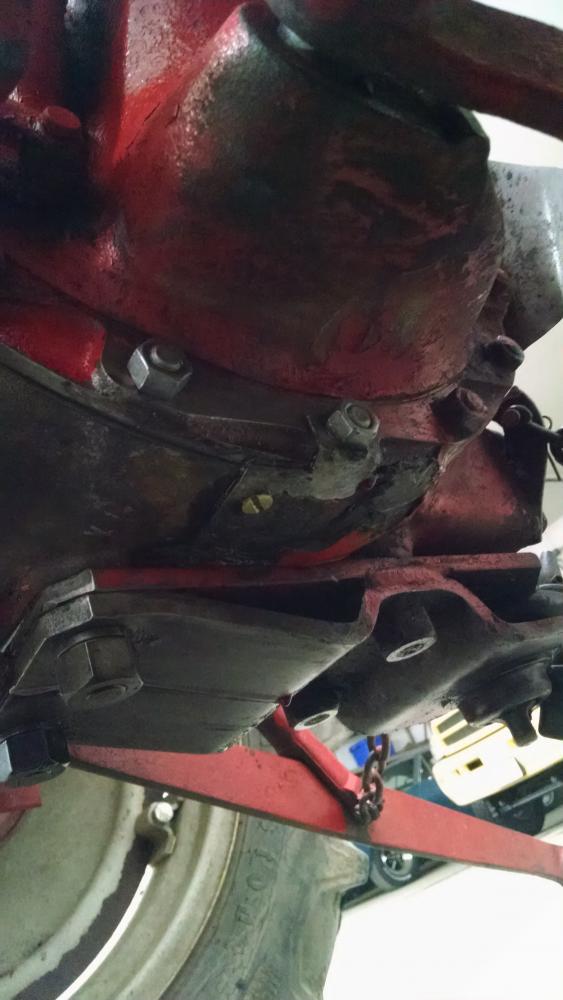

end. So while cleaning that up, I decided to find out where it was coming from. Found a nasty cobbled up repair. The bottom of the center section had cracked, so some crack head decided to fab a piece of steel to cover the crack, drilled in a couple of brass screws, JB welded over that, and painted it all Ford red. Well there was no way that was going to work in my world, so I found what I think is the last center section within 100 miles of me and just picked it up today. Off to the races again :headbang:.
