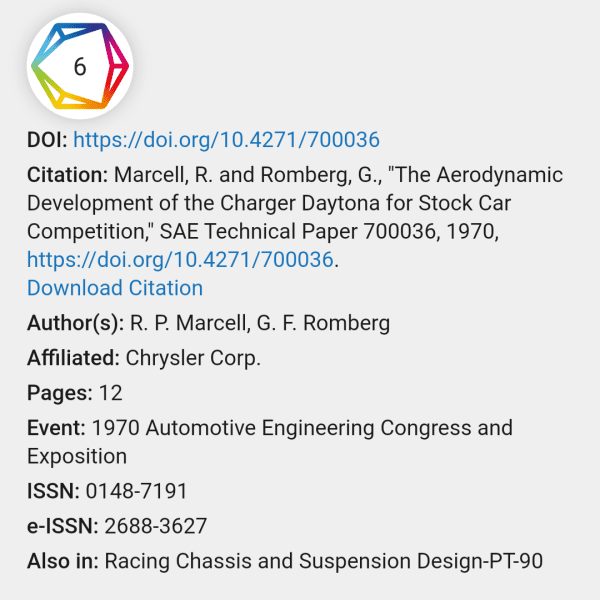

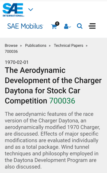

I do not recall any discussion of the scoops on the fenders in this tech paper, but get yourself a copy if you like reading about what they did during development.
The Aerodynamic Development of the Charger Daytona for Stock Car Competition
For future searches:
R. P. Marcell and G. F. Romberg
Chrysler Corp.

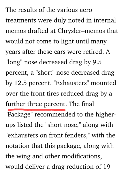

I read in an article that Mopar engineers at the wind tunnel found the "vents" lowered drag by 3%.
Here is where I saw the three percent mentioned:
These Cheaty Scoops Are What Really Made the Dodge Charger Daytona Spectactular
_________________________________________
These Cheaty Scoops Are What Really Made the Dodge Charger Daytona Spectactular​
The wings and nose were important, but these small scoops are how Dodge really got the advantage.
BY STEVE LEHTOPUBLISHED: NOV 7, 2016
