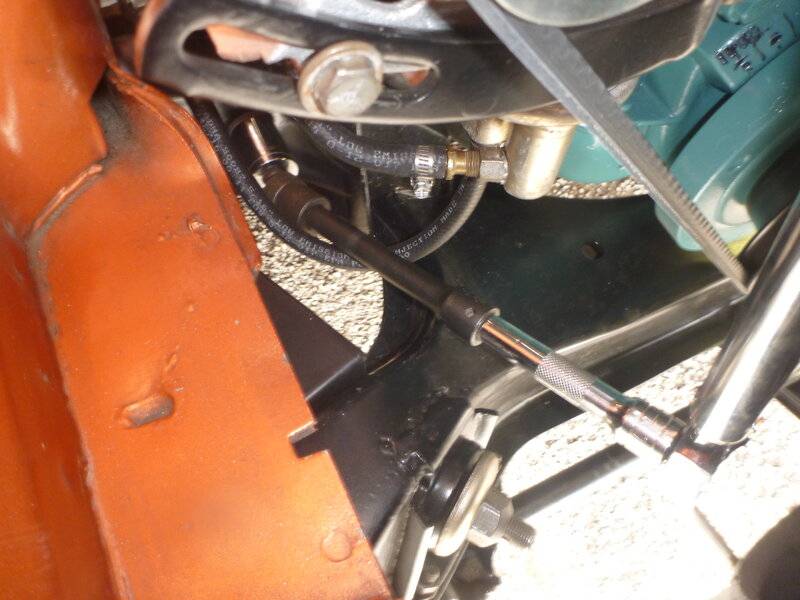

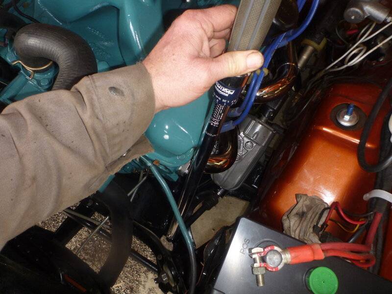

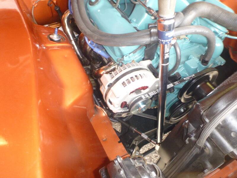

Went to bed last night and the little voice spoke up and said "hey asshole, did you forget to do something..." Don't forget to tighten those LCA pivots after putting the car on her wheels! 130 ft-lbs !

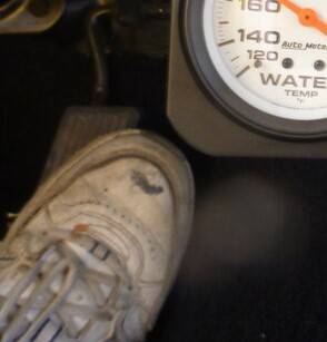

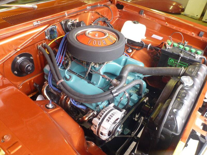

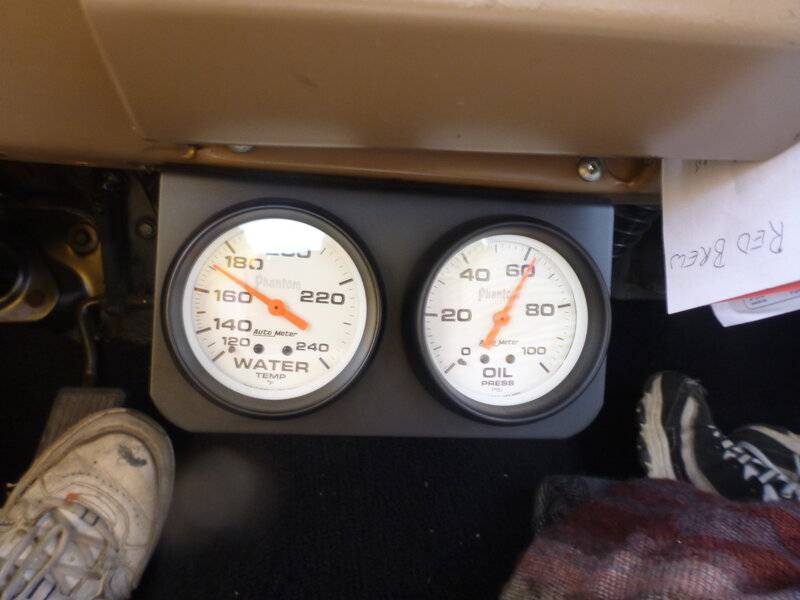

Grocery run today.... can't believe how cool this thing runs with that 7 blade fan I threw on. 172F on the highway and 62 PSI oil pressure. This was about 40 minutes in :D on the way to the grocery store!

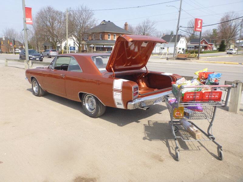

Trunk mat? :-)
We did the same with Fred yesterday. People actually gawk when I open the trunk and load groceries in
him, like it's sacrilegious or something. :-)
