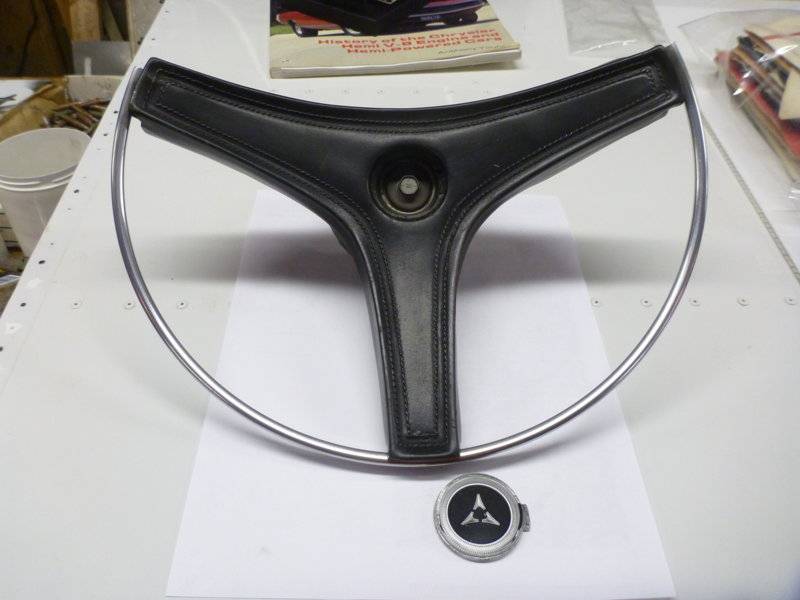

Amazing what's still out there and kicking around. A nice near mint horn ring and pad, and especially the center cap, that I picked up from Justin @pearljam724 to swap onto the car, replacing my OE that I took countless hours to make presentable.

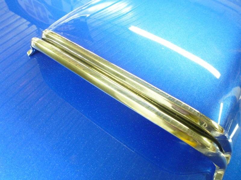

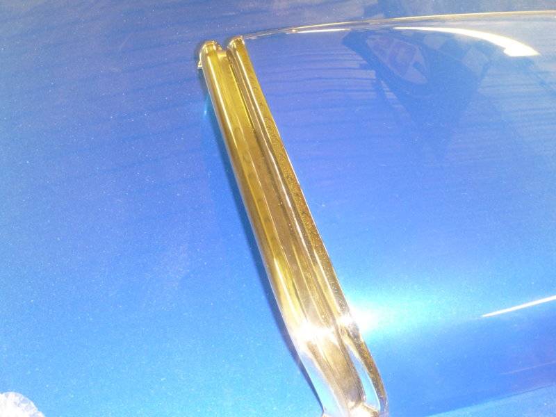

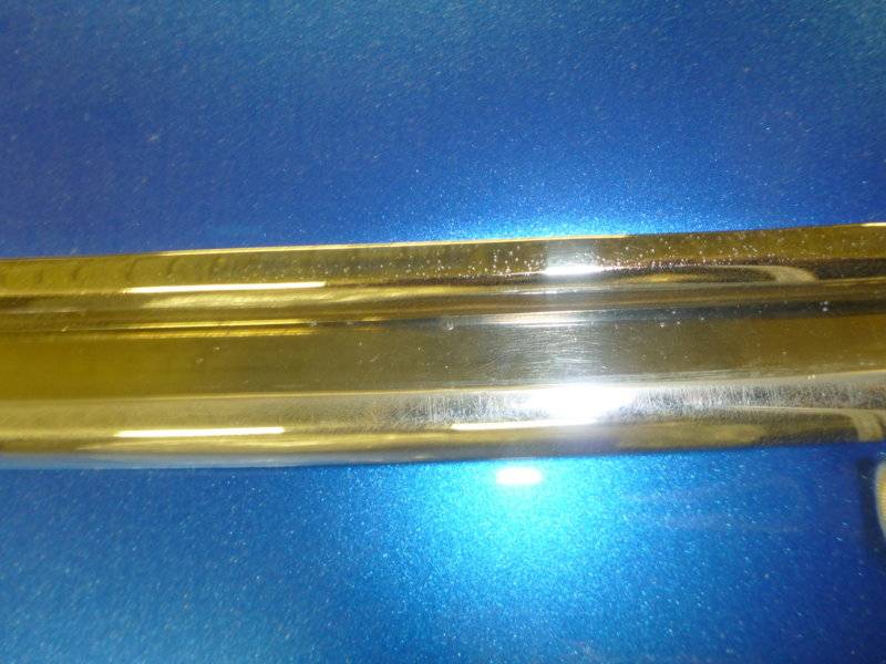

Finally getting around to cleaning up the pair of scoop bezels I picked up before Christmas from Joel. Scratched and lightly pitted, but not near as bad as what I had. Right side.
Left side.

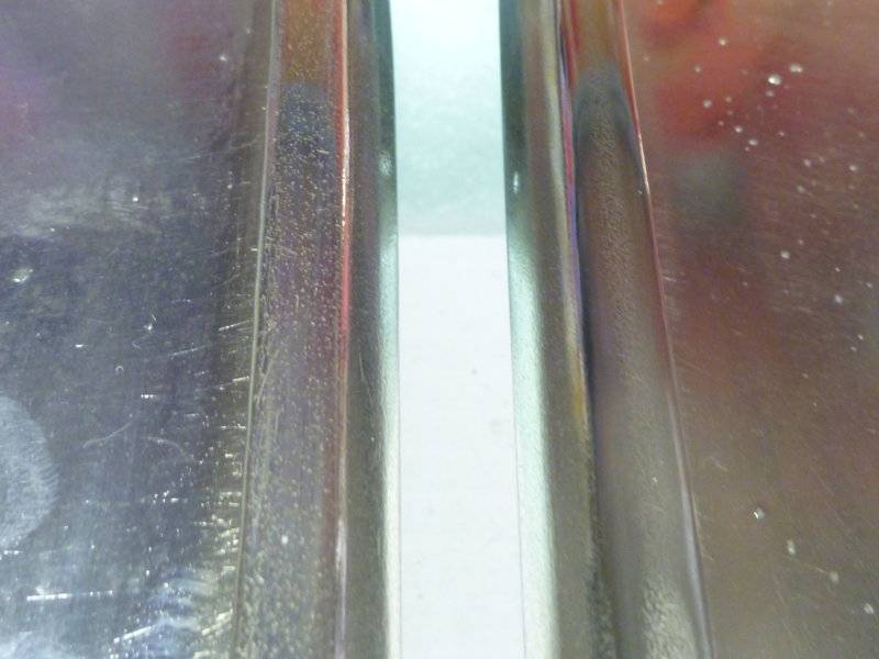

With a presentable set already on the car my brain will let me be a tad more agressive this round. 150 paper to start and hoping I don't run out of chrome before the pits/scratches are mostly gone. Then 400 / 1000.
White compound on the harder wheel and rouge on the soft.
Getting there but not happy yet.
One sanded and polished, one not.
Still not there, as you can see pitting/scratches in the center on the right one. Left hasn't been done yet.
Presentable, but I'll continue to beat it up.
Top surface isn't flat, it's concave. Some careful sanding down the center and then more polishing.
I now have both to this stage. Better than what I have installed to the car, but I think I can make it better yet. Famous last words.
Three hours to this stage!
Getting there.. my polished OE's on the left with deep pits and what I'm working on on the right. One more hard cut with White compound and a buff should do it!
Gonna call the RH side done and installed.
Gotta thank Joel @hunt2elk for providing me with some OE bezels to improve my restoration.
Dressed out pretty nice!
Drivers side almost there... just another buff and then install.
The 'zebra" stripes are the reflection of the shops metal ceiling.
Well.. guess I need another car to work on now!
This was about 1.5 hours of work this round = 4.5 hours total to bring these around to this stage.

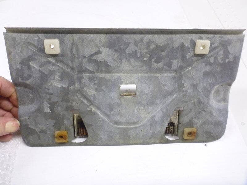

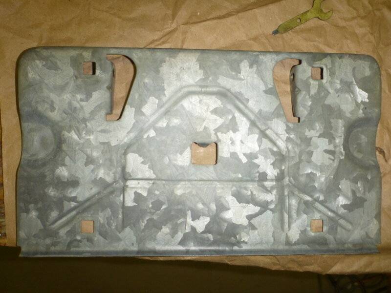

Bought Her a gift that I got from @Jeff Brundage down in New Brunswick. Near mint licence plate holder. Just need to clean up the rusty pin/spring/nuts, put back together and swap onto the car after removing my old one that I dollied for hours to get straight and painted black.
Nice clean piece Wayne. That parts car Jeff has is in some shape. Ever try vinegar on the galvanized? A fine line between real clean and screwed. lol I practiced on a old bucket before I tried my license plate light bracket. Did not want to wash the galvanize off. That one looks cherry!
