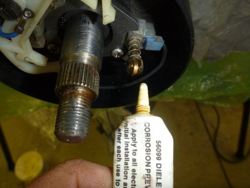

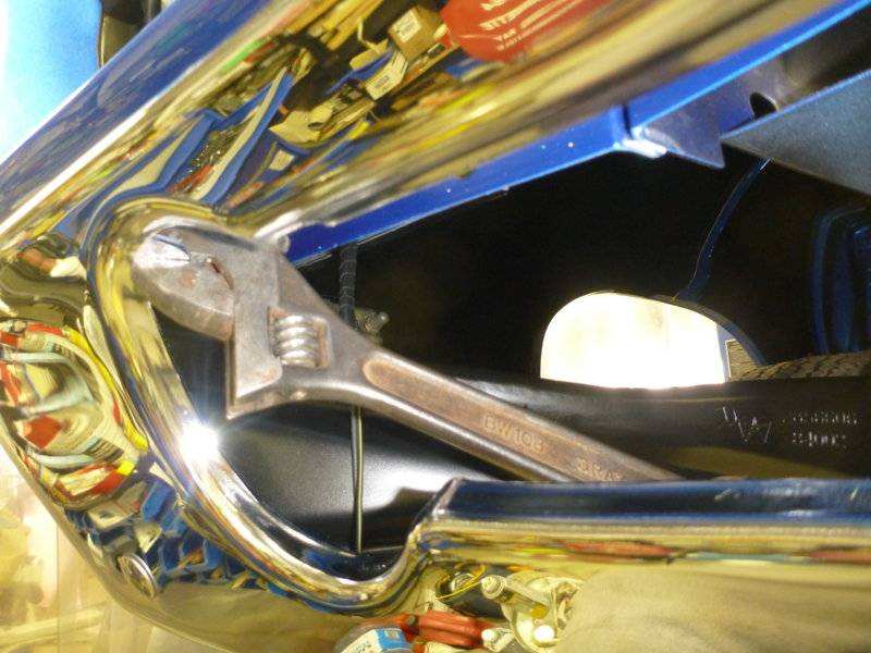

Reproduction signal lights that I painted the housings flat black previously.
Bit of dielectric grease on the connectors.
Had to tweak the mounting ears just a tad so the signal lights would sit correctly. Very slightly I must add, amazed at this AMD bumper so far.
I found myself in the same situation today with repop front turn signals and repop front bumper. I had to bend the mounting hole ears as you did to get the screws to line up with the bumper holes. I also applied dielectric grease to the connectors.
Thanks for your help, Wayne.
Sorry.. had to go to camp and didn't get to this. You'd be best to ask elsewhere.. I have 6-32's x 1/4 in the Bee and self tapping #6 screws in the Bird. Don't know which is correct.
I bought the 6-32 x 3/8 and they work. They don't carry 6-32 x 1/4 at my local hardware store. 10-32 x 1/4, yes. Go figure. Looking at your photos I see I am missing the plastic cover you tape on the column. Any chance they repop those?
