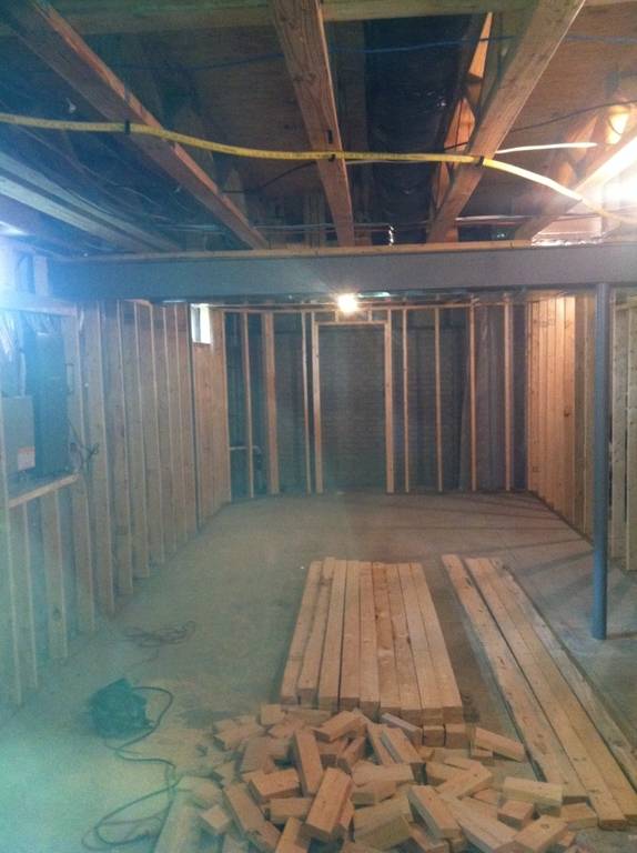

Well, it didn't take long for life to get in the way. Reference post #1: With a baby on the way, I had to take a detour in my projects. One of our rooms upstairs is my office. We have to make that office into the spare bedroom and the spare bedroom into the new baby's room. Subsequently, the office needs a new home. My daughter's room remains unchanged. Time to finish the basement. Been working on this for the last 2 weeks. I'm done with it....Electrician and Drywaller have been hired. This will be the childrens play room / workout room / office. Pre-wired for a new TV etc. Trying to de-cluter the upstairs.
