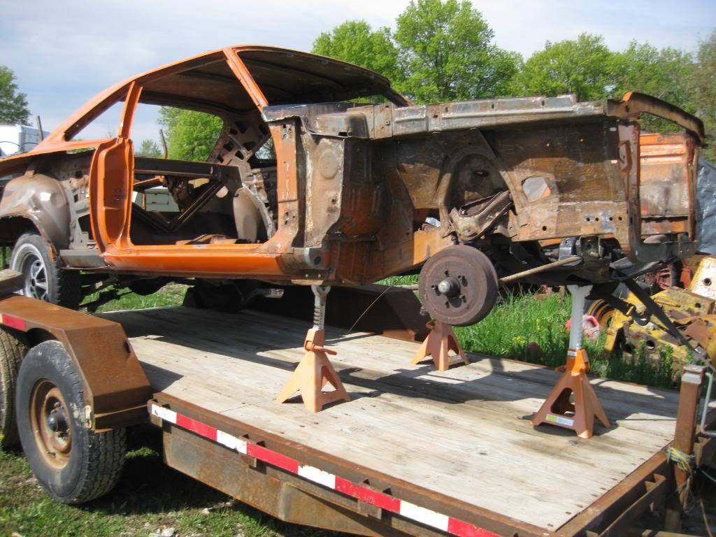

Not a big update, but all the undercoating has been removed. Also finished up removing the remainder of the seam sealer. About 10 hours invested into that little chore. What a dirty job....can't wait to start inhaling filler dust vs this crap.
I have decided to hire someone to do the blasting. My fathers company can't spare a day without the compressor. It's like trying to pull teeth to get a day with it and we can't make it work. I hired a member here to do the blasting. Not sure he wants me to mention him by name. He's watching this thread, so I'll let him chime in if he wants to. He should be picking up the car in the next couple of days.

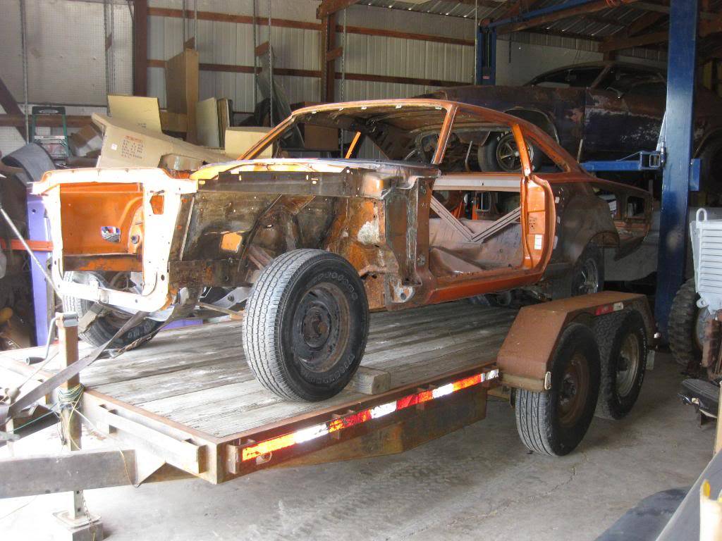

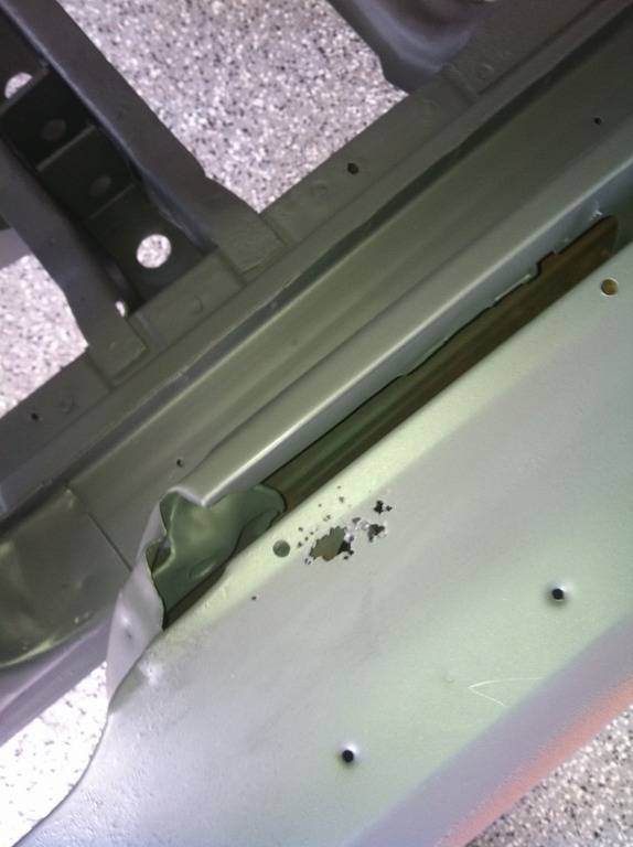

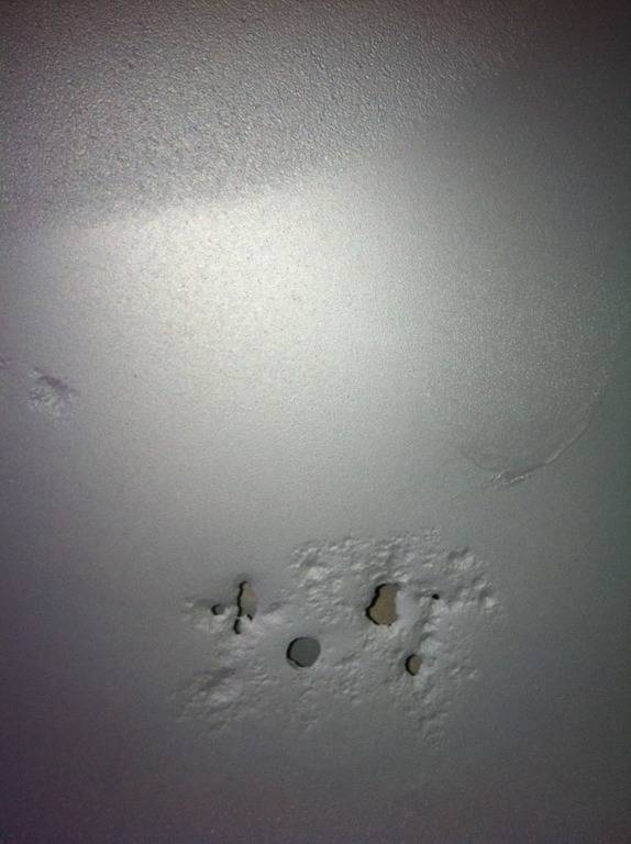

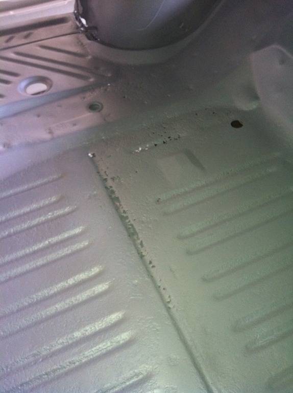

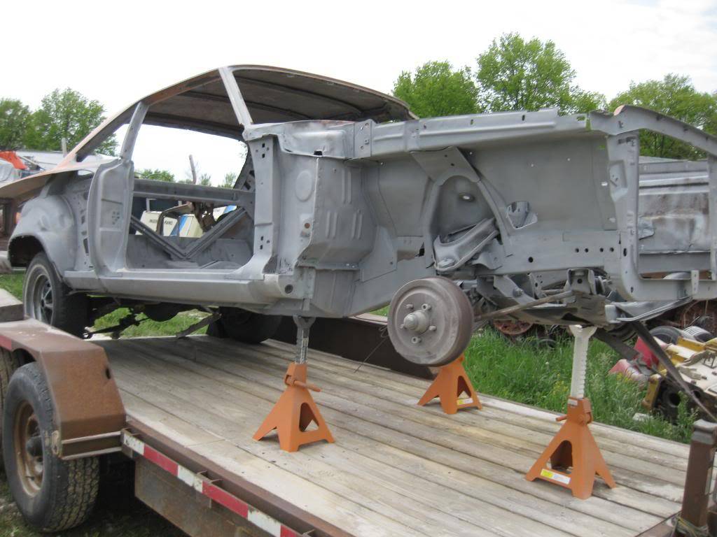

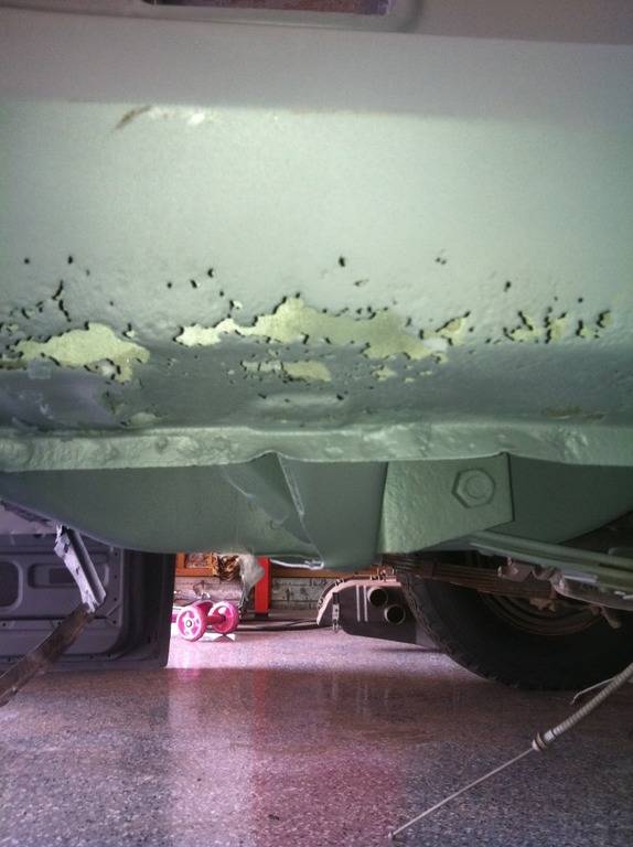

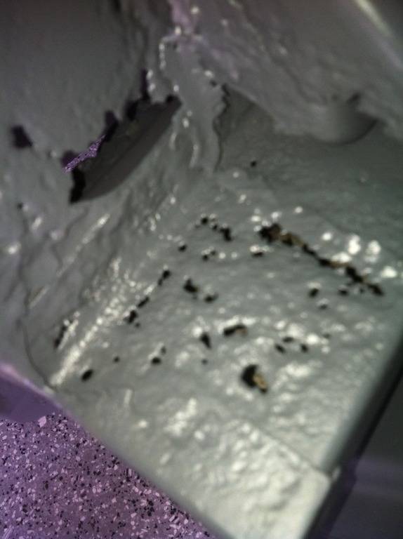

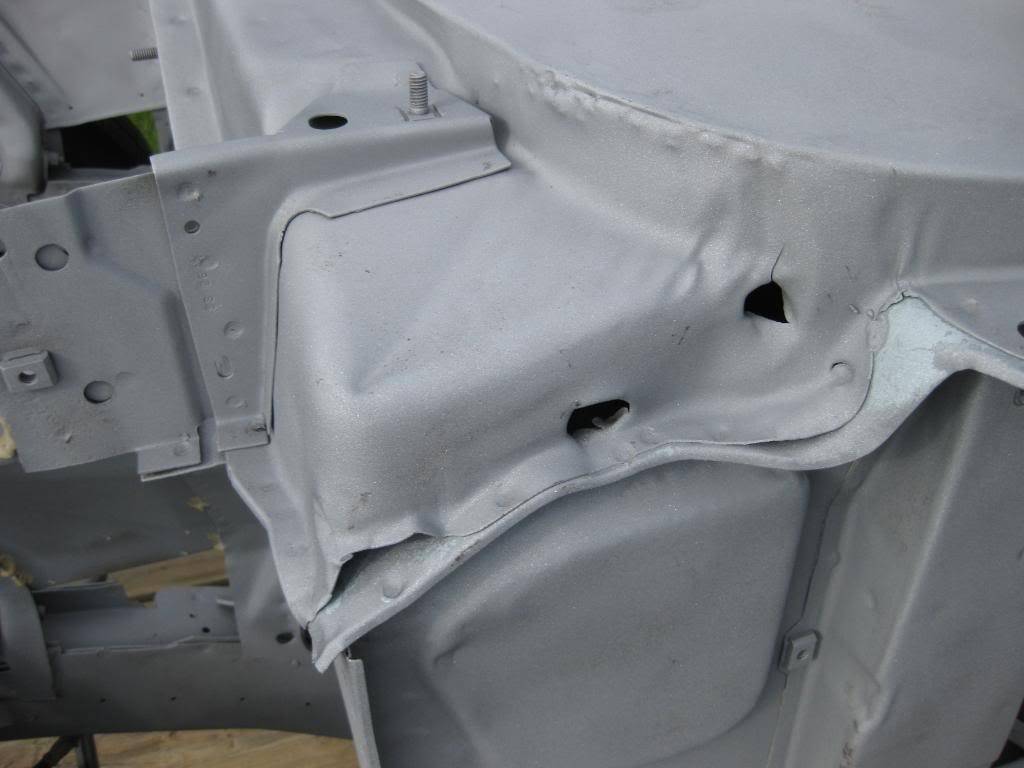

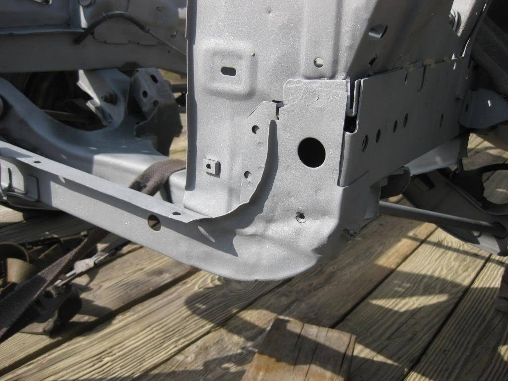

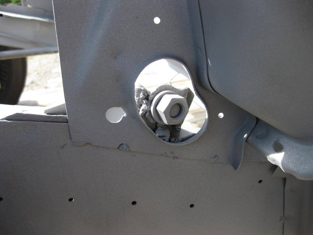

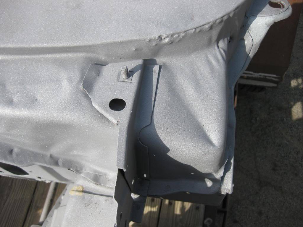

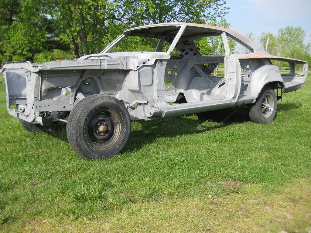

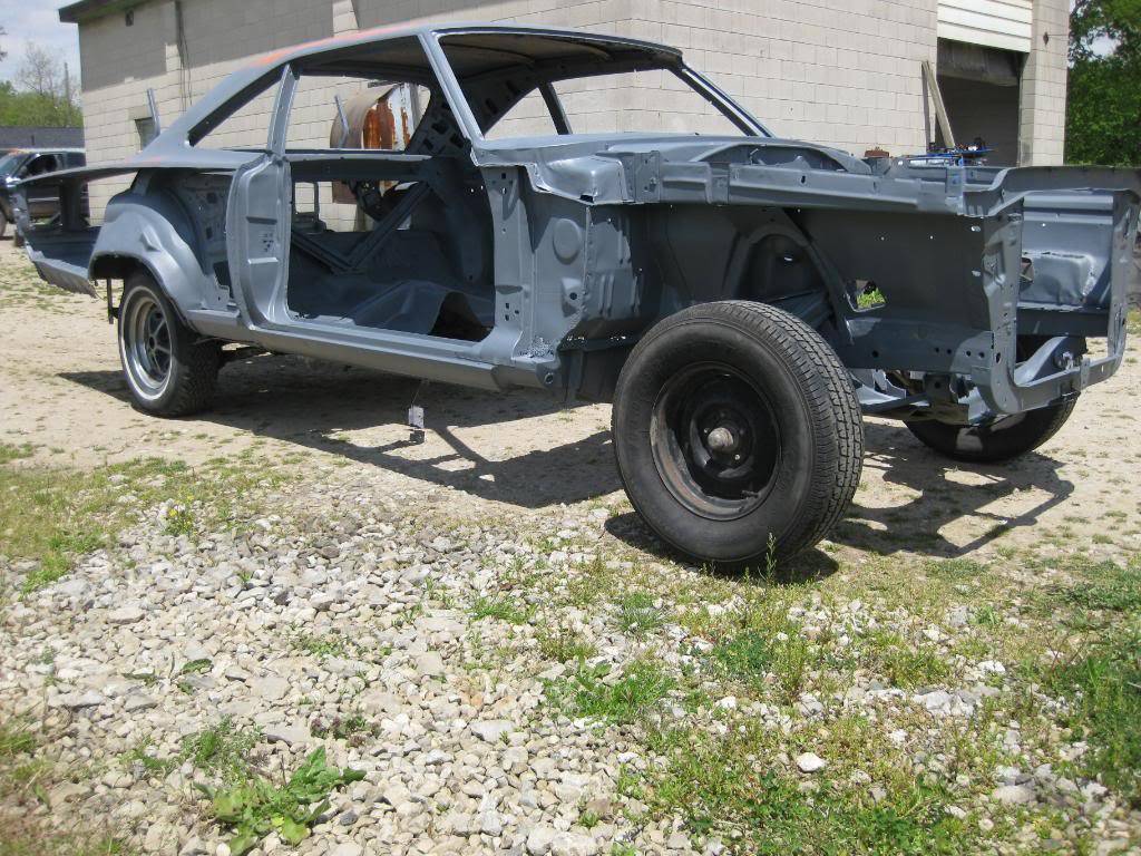

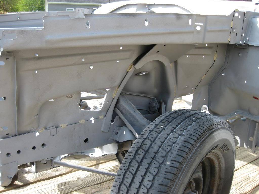

Got the car back today from the blast booth. I have to thank Jeff (68427vette) for getting the car blasted for me. I can't thank him enough!

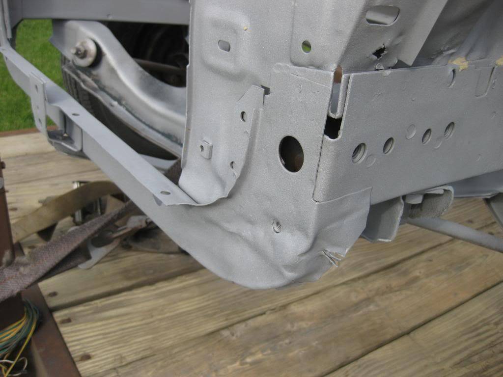

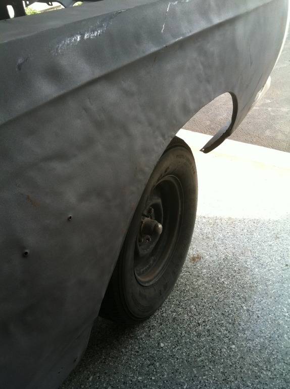

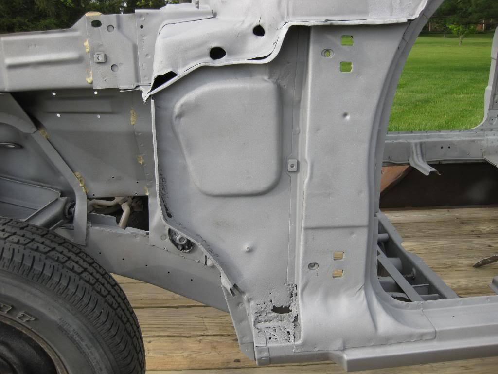

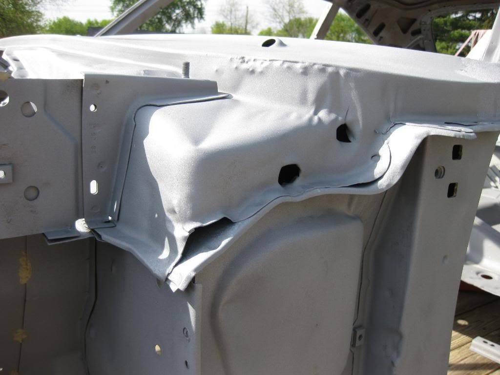

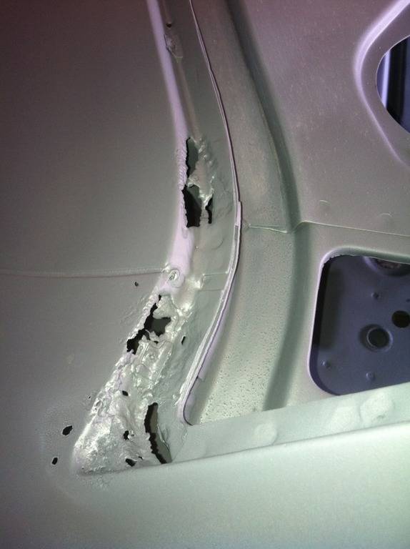

We have some issues. The car at some point was hit on the left side of the car. Several "demons" were found with wicked welding techniques and holes in the side of the cowling that aren't suppose to be there. I have to replace the right side inner fender and 2 pieces of the radiator support. (thankfully I can save the one with the numbers on it) Right side fender is destroyed...didn't even put epoxy on it. I thought I was going to be able to save the trunk, but it doesn't appear that is going to happen. I was hoping I was going to be different and wouldn't find much, but alas I am now one of you guys with the midwest rust bucket.
Here are some pics.....enjoy.
LOL i have the good photo's!!:smileinbox:
when the bondo can make its own shadow!! look out!!
she's so naked!!:lurk:

i usually dont blast on a trailer,, but time and weather only allowed me a day and a half,( FULL DAY ending at 11pm last night, and an early one starting at 6am today) and on and off rain all week...
ps --- josh its raining!!! WE MADE IT!:hello2:
Welcome to Rust-Belt Restorations. You have offically been inaugurated Captain! Time to crank up the tunes, welder and the misses nerves.

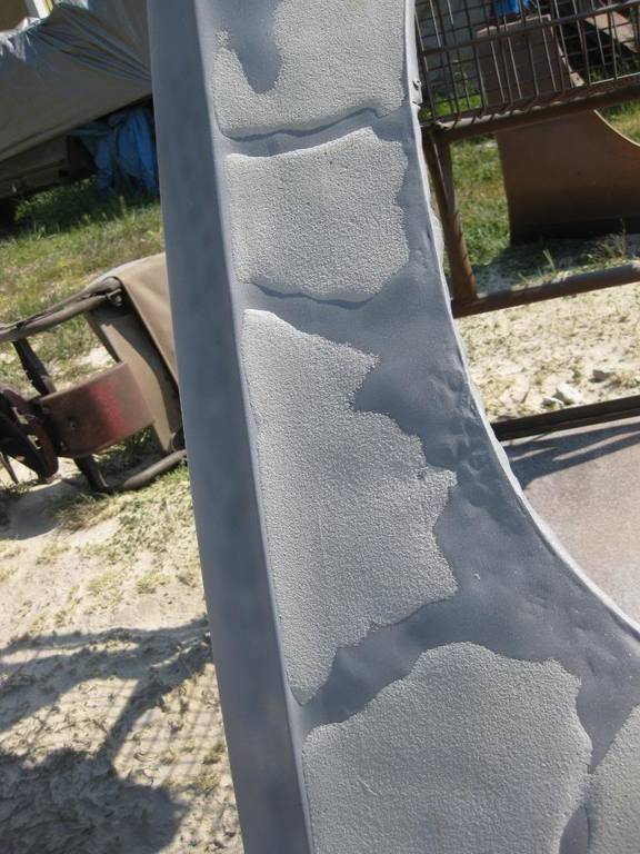

Did that fender try to survive a Texas cow stampede? Holy smokes.
Texas cow stampede, hit by a meteor or a back drop for baseball pitching....not sure. :)

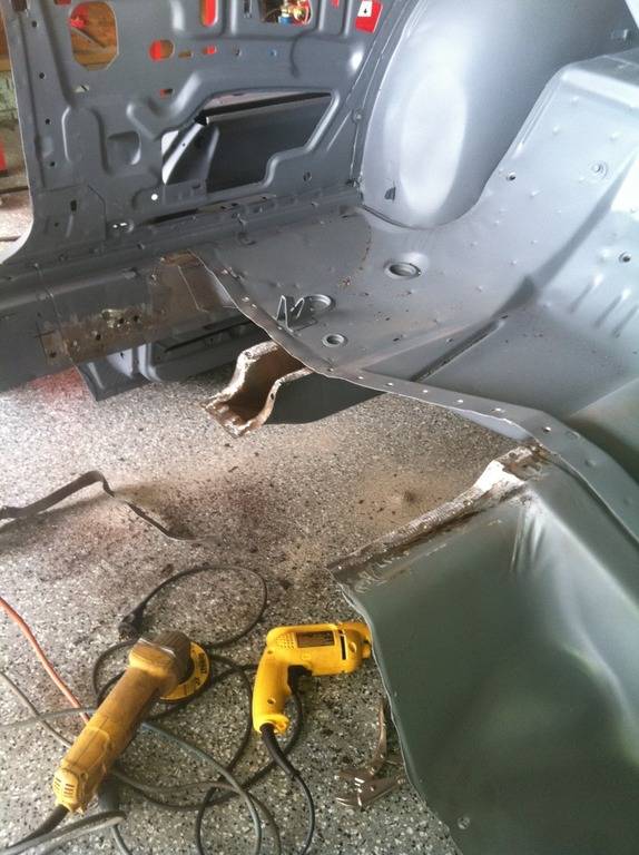

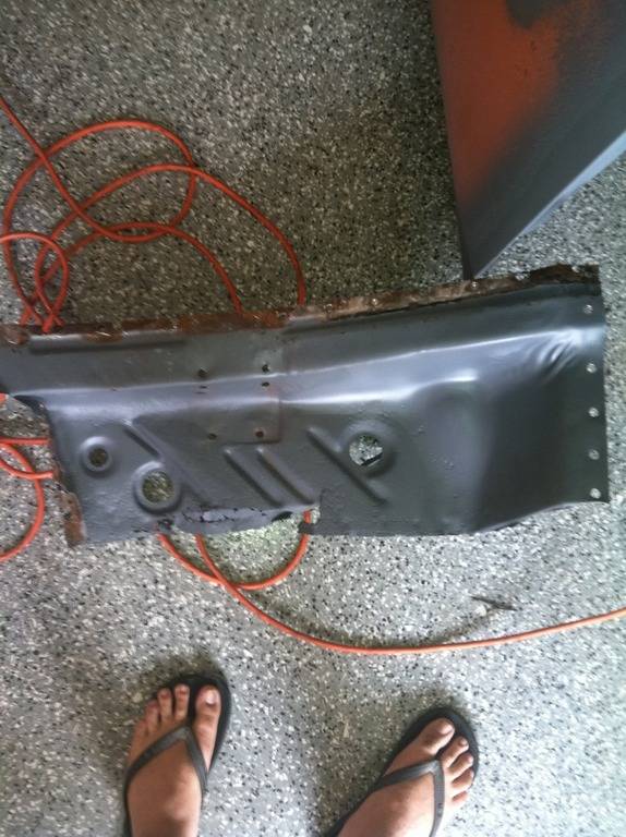

Had a couple hours this morning. So, I removed some more of the floor. I need to get a nice spot weld cutter, the one I have is dull already and it has only made about 30 cuts. What do you guys use?
Spin the bit slower, it'll last longer. I use a Blair cutter, or if I'm taking out junk metal like you are, I just grind that layer away until it peels off.
I need to find two footwells like you cut out, only good and solid on the outside edge over to about the start of the second factory hole. When they put a roll bar in my road runner, they brought it up right through the first hole and wrecked that part of it. I don't want to replace the whole thing since the rest of it is cherry.

BTW, are those your work shoes? :D
Thanks guys, I'll have to give them a try.
