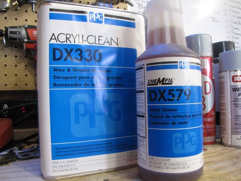

I sure would....I use a metal wash then a wax/degreaser before priming/painting any surface. This is PPG, but folks like SEM, 3M, Eastwood..ect...ect... also make their own.
A good cleaning solution to wipe it off is a good idea.. Takes any oil residue, any foreign stuff that may be on it off.. I use a cleaner i got from the paint shop i buy everything from, Its been about 4 year now but ill get the name/numbers from it and let you know sometime in the AM.. It was 40 bucks for a gallon of it but well worth it. If you need this like now, ill go out to the garage and find it for you no problem..

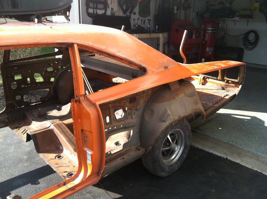

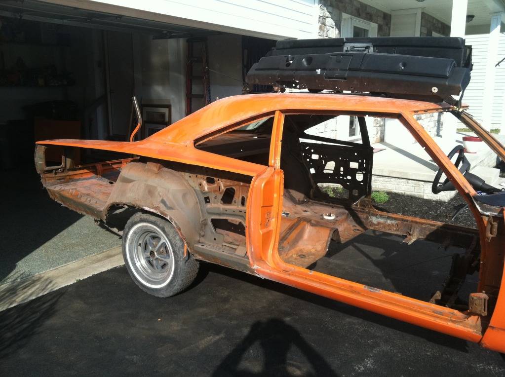

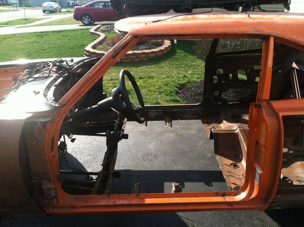

Day 116: Removed quarters and floor.
Floor DIDN'T come out in 1 piece....haha!

Thanks for the compliments. Sometimes, I wonder if I'm moving too fast. When doing something new, fast can be bad. I hope I'm not forgetting any steps.
Another concern. Some of the flanges were damaged during the removal of the quarters and floor. My BIL says that's normal and we have to build new ones. Ok, so my question is: the factory used a lot of spot welds. When doing the repair, is it acceptable to use plug welds in leu of the spot welds? Also, when using a spot weld cutter, are you suppose to drill thru both flanges or just the top flange?
