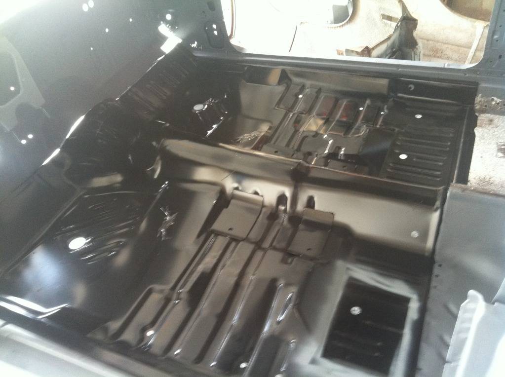

Capt. I did the same thing, bought the one piece floor pan. Had to cut mine because its a post car. I tried everything to get mine in, bottom, twist, bend, thru the front, I could not do it. I can send you a pic of where i cut mine, or just tell ya, i cut it at the front support crossmember. I cut mine in the middle from door to door so i could get good welds on both sides of the crossmember. Then welded where i had cut it. Let me know if you need a pic to understand what im trying to say. It stinks to pay the price for a full floor and then realize that the 2 piece would have been alot cheaper (including shipping) and easier to deal with. :icon_hang:
There is the pic of the front crossmember, i cut mine in the center of that from door to door. Then welded on each edge of the crossmember then welded the two pieces back together again (where i cut it). I hope that helps. The bad thing for me was, I ordered 2 halves for the 70 that you see on the other side of the 69 and the one piece for the 69. I already installed the 2 piece in the 70 before i tried to get the one piece in the 69. Otherwise it would have been done the other way around. Frusterating, i know! All i can do now is laugh about it. Good luck.

Agreed Capt! I had a hard time as well, I almost ordered two more halves and sold the one piece. Its hard to do. You might me able to get it in from the bottom if you cut everything out (seat supports), but i wouldnt recomend cutting out that front brace. Thats why I had to bite the bullet and cut the new one piece floor. Ask Prop or some of the other guys before you cut it. Just letting you know thats what i had to do and I knew there was no way i was going to cut the post out either.

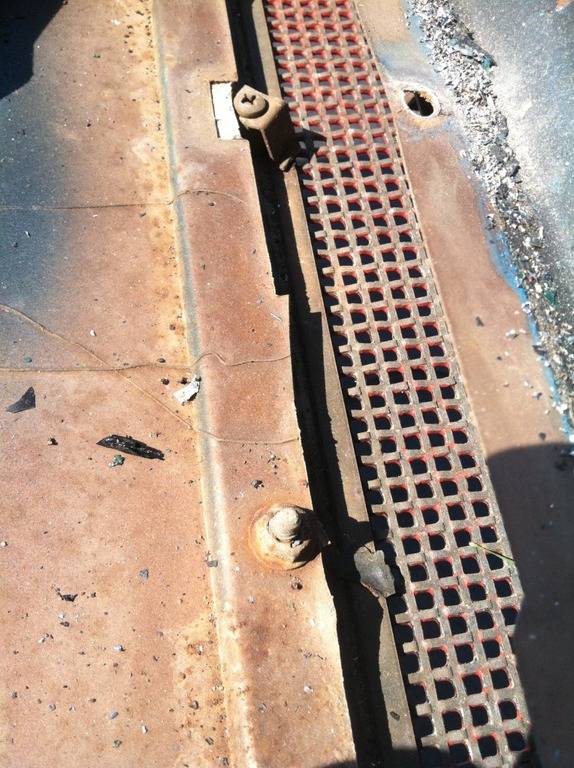

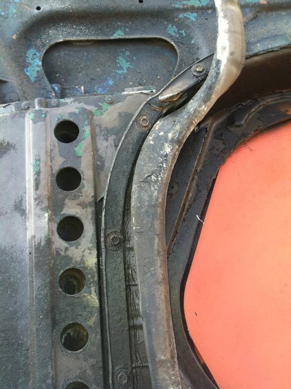

I also bought a hood with the airgrabber boxes from Brad (68bee70rr). I have a brand new hood from AMD and since this was a N96 car, I was missing the boxes. So, I spent a couple hours drilling out / popping rivets. I also took the inserts out. I have a set of inserts but they were the non-airgrabber varity and didn't have the red mesh screens.

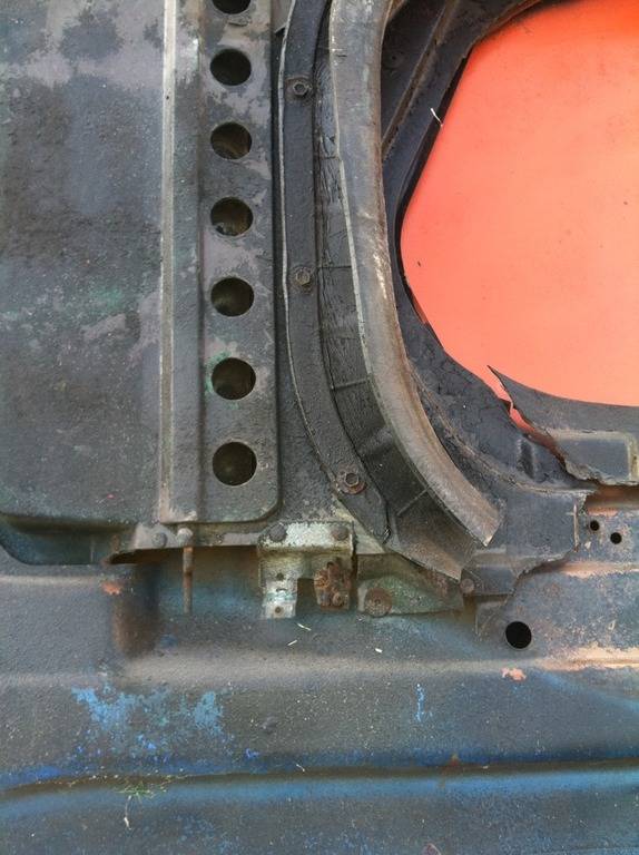

Here is a picture with the boxes out. Look at that line where the inserts attatch...does that look like a factory cut? The line is all jagged and I don't see the support crossmembers between the 2 sides like on the repops from AMD.

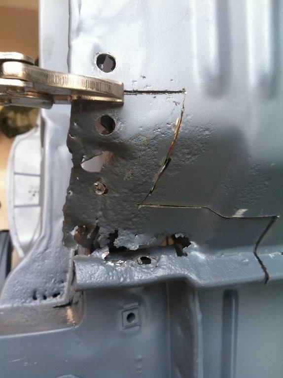

Also got a bad section of the firewall cut out. I need to get this piece corrected before the floor goes in. This is near the kick panel on the passenger side. It would be toward the passenger right foot. I got a local guy lined up to try to make me a reproduction piece. I kept my old quarters that I cut out. There was still a bunch of good metal on those quarters. So, I cleaned up a piece of metal and put some weld thru primer on it for the fabricator.
At any rate, I guess it's not time critical to get the floor in right away until I get this piece back from the fabricator. He's only charging my $30 for this test piece. :headbang: If I like the way it fits, I'll take him more work.
