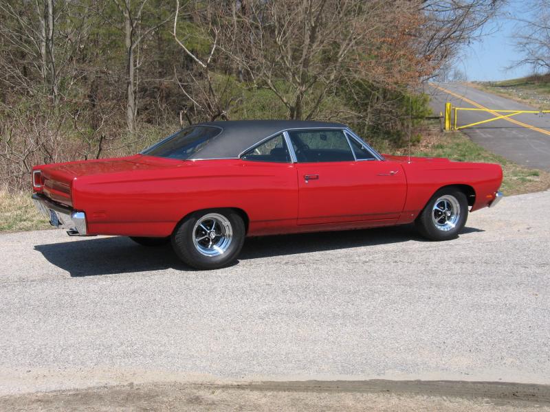

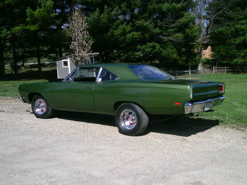

I had 15x8s with 2756015s and 14x6 with 2257014s on mine before I got my Cragars. No rub anywhere.
Looks nice. What I am looking for, never considered 14 inch on front.
Thanks for the picture.
WOW that is the look I want. Is the suspension stock front and back? I like how it sit's.

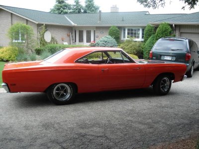

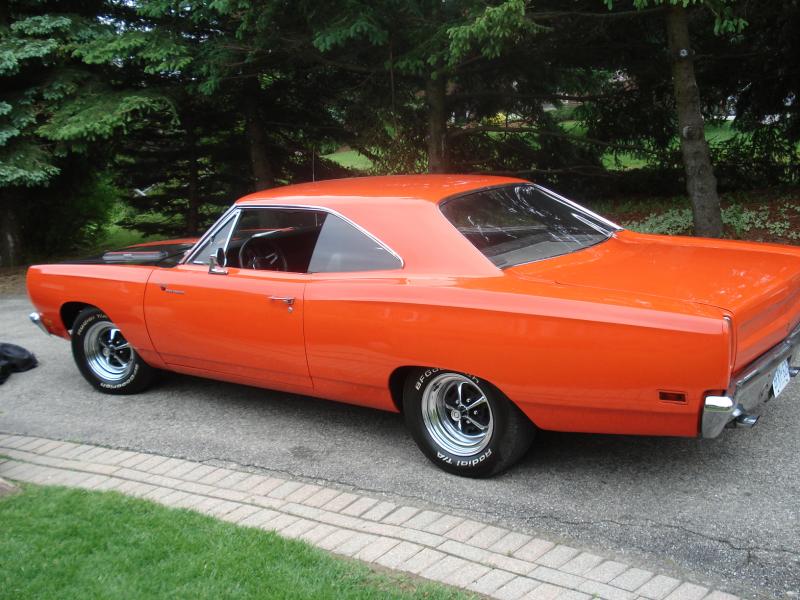

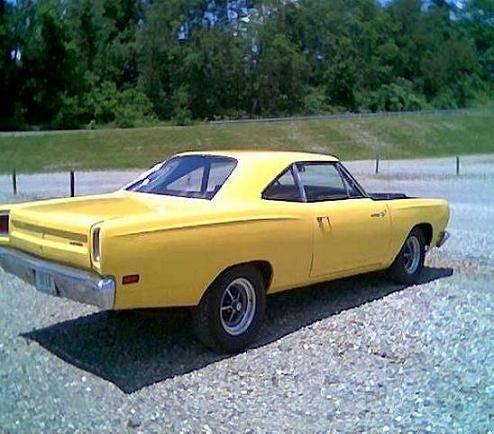

69 Bee with 15X8 with 275/60/15 and 15X7 with 235/60/15 no rubbing ever.IMG_2934.jpgIMG_2926.jpg
I really like the 15 inch on these B bodies. I like the 8 and 7 inch combination. Car is beautiful.
Thanks for the pictures.

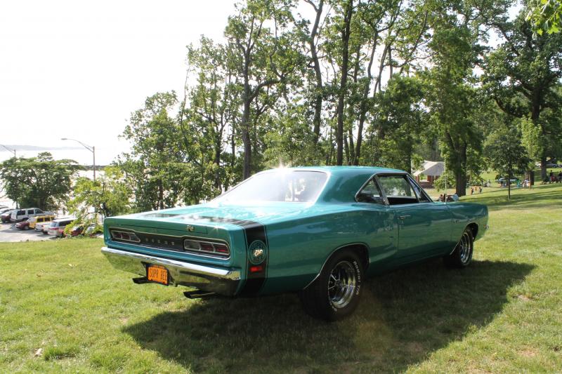

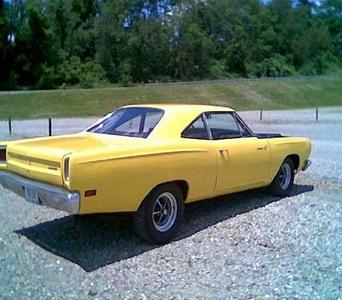

Why does it sit so high in the rear? Looks like more than the difference between 15 on the back and 14 on the front as the difference between the 60's rear and 70's front should offset that.
Tire and rim size affect ride height A LOT esp when you have really tall out back and pretty short up front but i'm interested to hear if it's something else too like SS springs, air bags, or air shocks on basket cases car. That's up there :)
Other than that all 3 of the cars except goons have a similar rake and similar height tires
Note the RRs stock rear wheel openings are lower at mid point than the coronet's by design

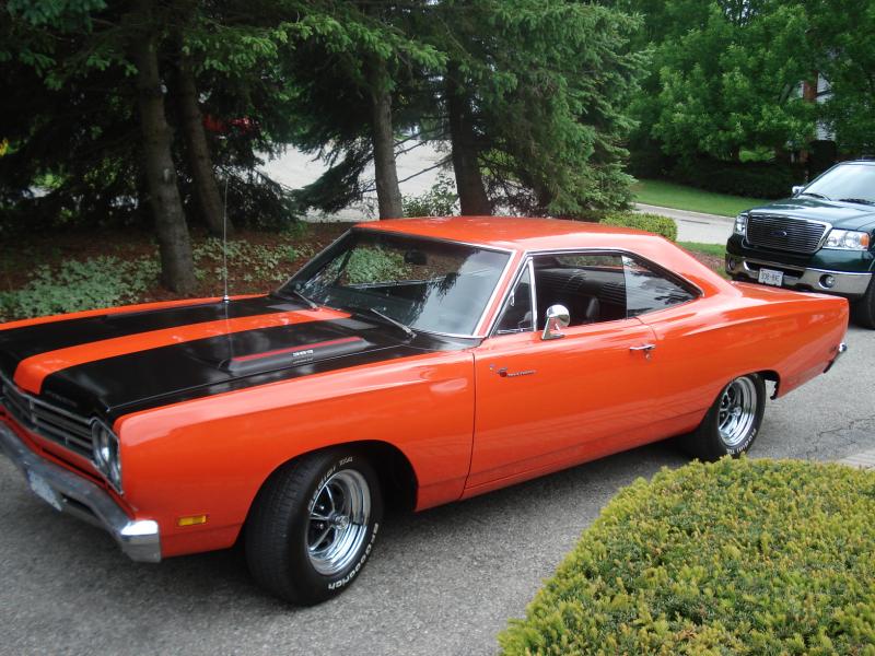

well when I got the car, it only had four leaves on each spring, and it sat low like an E Body. Even sitting that low, the 15x8s ddn;t rub. we redid the springs with an extra main leave and a half.

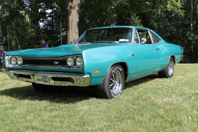

Now I have 15x8 Cragars with a bunch of offset and they still don't rub.
