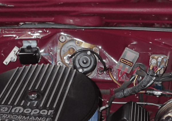

It's a 2 speed and looks like this
It's nothing mechanically wrong with it but it looks terrible ;) I guess I need to take it apart - sand it - prime it and then spray it while trying not to open anything up which I can't put back together? ;)

It's a two speed. We drill the rivets out to get the cases apart and that gives you access to the internals of the motor. Be careful with your conical grommets, no one I'm aware of reproduces those and they have a tendency to get a little crunchy with age and you can split them pretty easily. If that happens it's not the end of the world, just use three speed grommets and cut your inserts/crush sleeves to fit their height. Black Satin and some elbow grease and the motor will look MUCH better on the firewall. If you need anything, hit me up I'm always willing to help someone who's trying to help themselves :icon_winkle:
