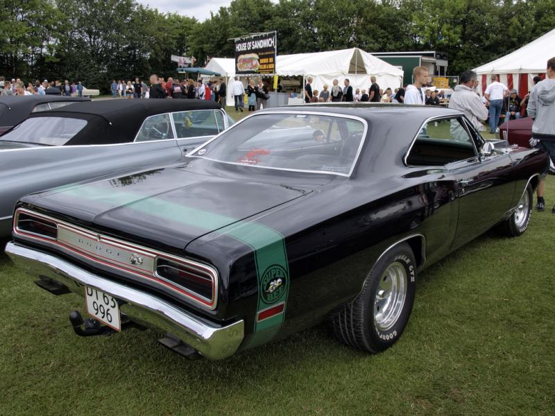

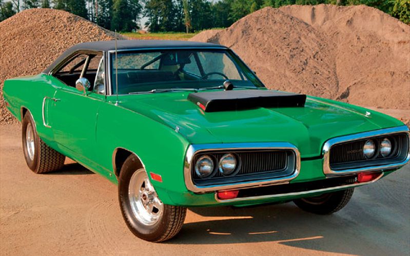

I am looking to purchase new wheels and tires for my 1970 coronet. I was hoping someone can refer me to a post or provide recommendations for the best tire size to fill the wheel wells of a 1970 coronet?
I like the look of the tire taking up most of the space rather than the tires getting lost in the space of the wheel well and size of the car.
any suggestions would be greatly appreciated. I included some cars that look the way i want mine to look.

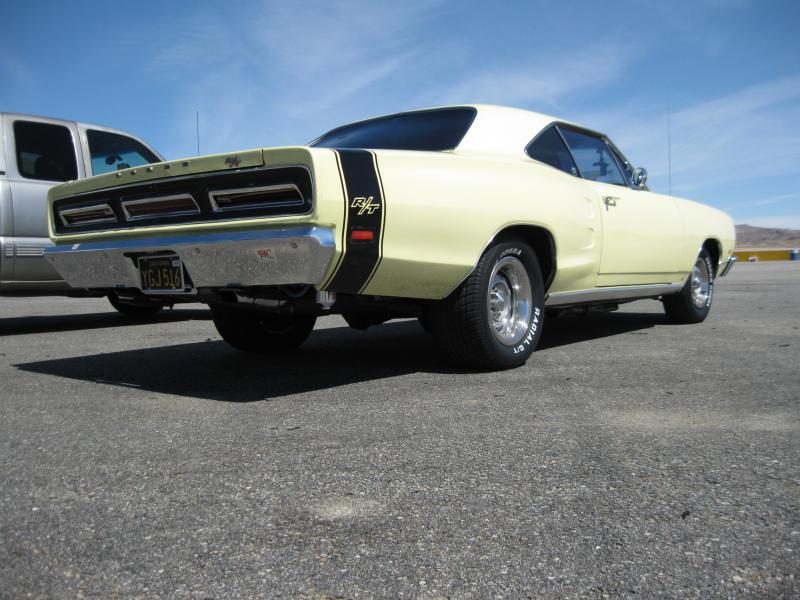

2014SprFlVegasCC 075.jpgiPadApril2014 238.jpg225 70 14 front. 295 50 15 rear. 8 inch rim.

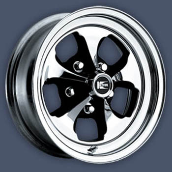

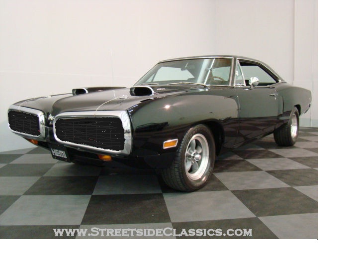

Different year cars look better with different wheels but it is always our taste in the looks, the 70 is such a nice looking model and to me can be fitted with a number of different wheels and look great.. The Keystone classics are one of my favorites 32 SERIES 32 Keystone Klassic Chrome Composite RWD.jpg But there is so many others, And i like the Torque wheels torque thrust whel.jpg But the choice is kind of personal taste and here is a link that you could look over many of the ones available.. Thats some nice looking rides there!
http://www.texasautotrim.com/Cragar_Classic.htm

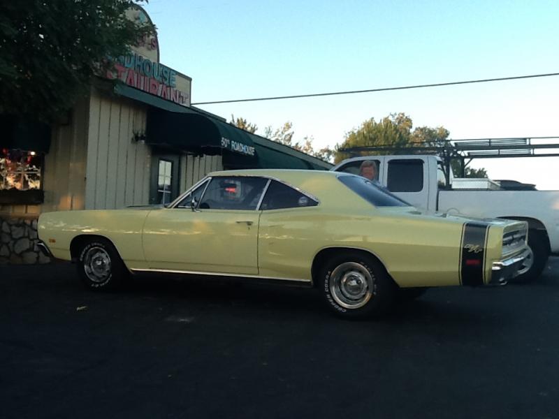

i am looking to make the car a driver, so radials will be the preference. 15inch wheels are what i have now. in the rear they just seem to look narrow, and from some angles almost look like "doughnuts" when compared to the space in the rear wells.
do you have pictures you could post of your wheels, tires and what size they are?
