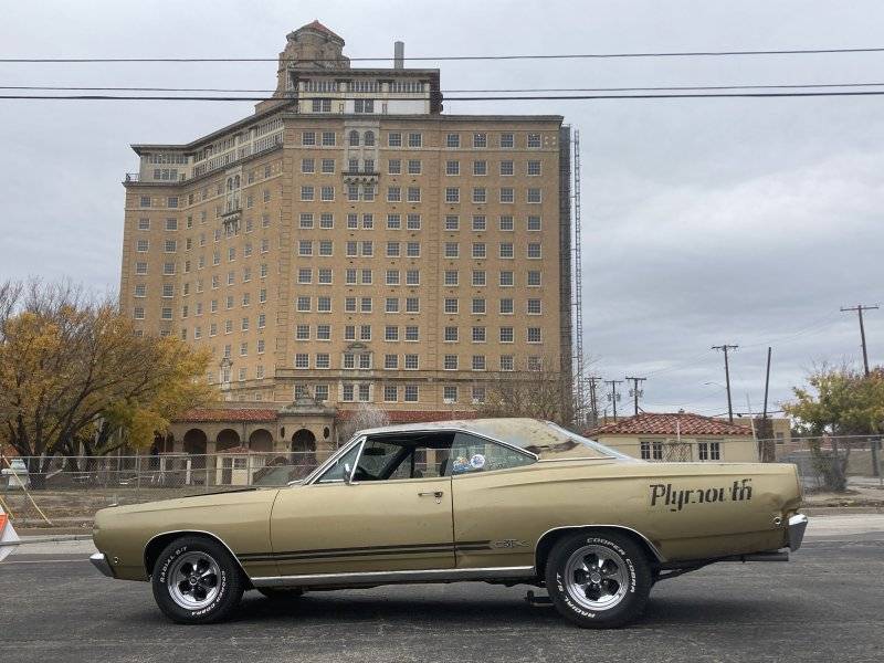

That GTX just seems to shout "TRY ME!" At the very least "Beat me!" :lol: I know they don't do anything but always loved the looks of the traction bars on any Mopar. Maybe a little tighter up to the springs??
Thanks, the 255s are a little too narrow, it needs wider tires to give it more attitude, and more importantly traction!:steering:
