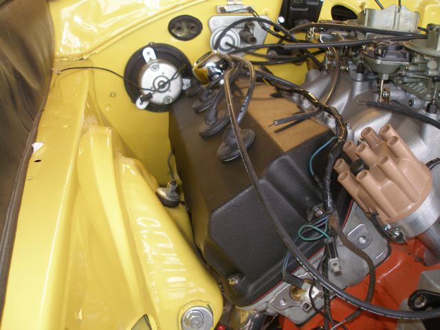

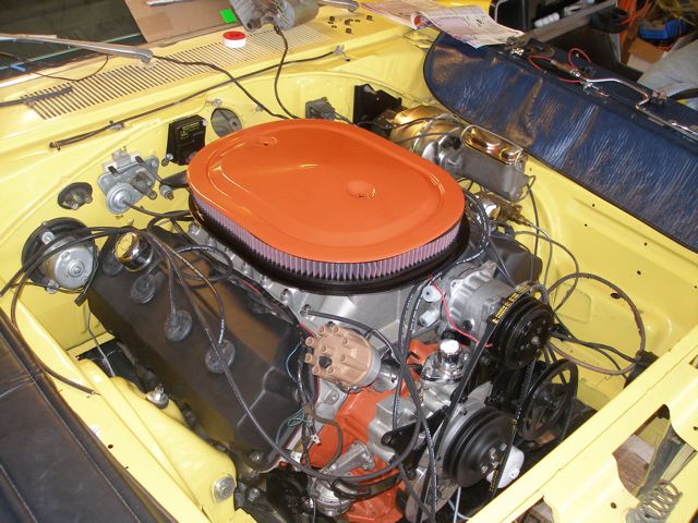

70 Superbee with the Stage V heads and covers. The right side head and cover make contact with the heater blower motor. Is there a smaller heater motor available? I'm running AC on the car (Bouchillon Performance kit) and I have Mike Schumacher's "Creative Services" engine mounts so the engine will be stationary.

That is what I call a shoe horn fit! Zero allowances for any kind of flex.

Yes, I'm finding out that the Stage V heads are taller and wider than stock "Mothership MOPAR" heads and covers. That is why there is a tighter fit.

I thought about removing the blower motor BUT as you can see, the "Bee" is an AC car and I purchased the AC kit from BPE. The compressor is mounted. I'm here at Edwards AFB, Mojave Desert. Typical daily temps are in the low 100s. But: "it's a dry heat" Ha Ha...so is HELL!
I hope you don't have solid lifters. What are the possibilities of getting that blower motor out of there completely and move it to the inside by using a different heater box? Or have a way to easily slide the heater box out of the way should you need to get the valve cover off. That is just way too tight no matter how solid the mounts are. The clearance to the shock tower isn't that great either and I'd modify the valve cover with a scallop to clear that area. I will say that HEMI is looking mighty sharp sitting in there :VB toast:
Note: If you do any welding on the valve cover you may want to bolt it down tight to a head, or some rigid fixture, to keep it from moving while you weld. I can just see it pulling in the weld area and ending up with a potato chip.

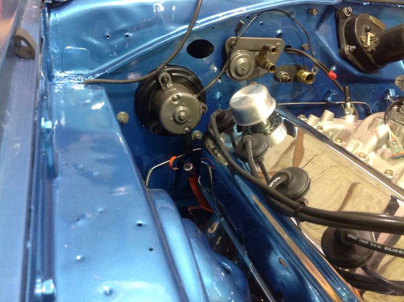

I had the same issue. Thats why no AC on the hemis. We removed the Blower unit and actually did some surgery, moving the blower and squirrel cage inward about 1/4 or 3/8 inches. The real trick was removing and retacking the three mounting brackets on the motor. I will try to post a pic next week. We also removed the valve cover and carefully did a little grinding on that corner, then repainted. Looks great and works.

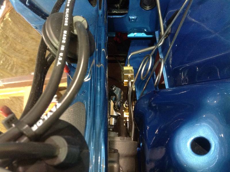

Here is a crate 472 hemi with a stock k member/ mounts and TTI headers in my 70 Satty. You can remove the valve covers and you have about 1/4" clearance on the steering box and maybe 1/2" or better on the pass side.
Oh, and the headers are 2" TTI
