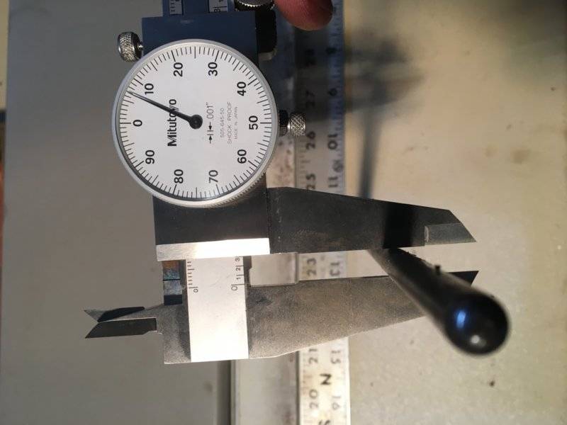

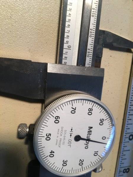

Ok, these are the rods I have removed. Diameter is .308", Over All Length is 9.303 . I see the lengths listed at vendor sites as 9.315 or 9.295. Mine happen to fall between. I would have to conclude that this is due to wear as the tips are just a whisker flat. Also they do not have oil hole.
It sounds like I want oil hole in any new pushrod.
