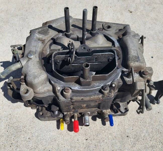

I want to let my Thermoquad carburator be rebuild that came with my car. But I first want to be sure this is the correct carburator for a 74 Charger 440. Can anyone confirm this? Does anyone has tips to ensure that past lessons learned are taken into practice in the rebuild?
Where can I find the best rebuild kit?

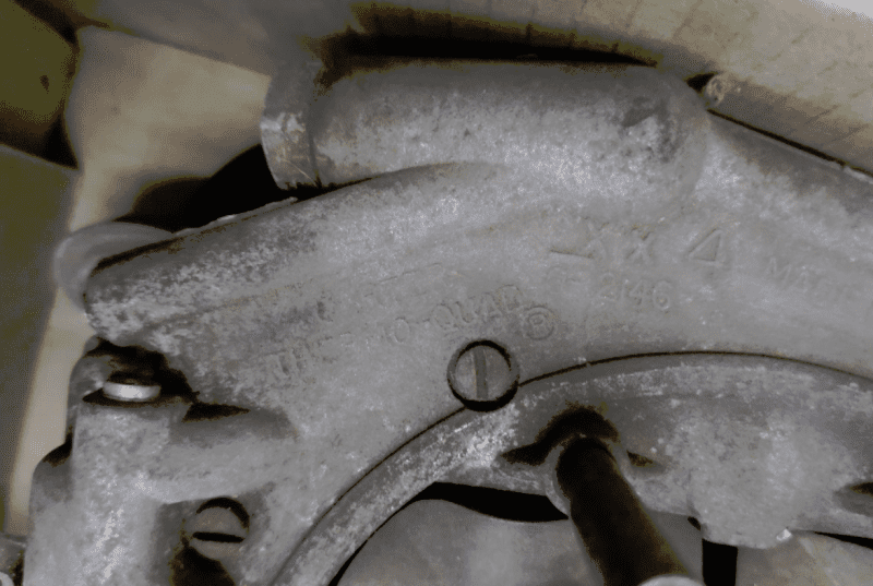

Should be a number by the yellow plug
Whats the number on the bottom left front ear?
Rock - Auto has several kits for your carb. Just get the number off of the back of the left rear mounting flange.
Application info:
Mdl YR Application Pri Sec Rod Bore
6452 74 360 HP MT F (3751433) 4098 5143 1962 1-1/2
6453 74 360 HP AT F (3751434) 4098 5143 2005 1-1/2
6454 74 360 HP MT CA (3751435) 4098 5143 1962 1-1/2
6455 74 360 HP AT CA (3751436) 4098 5143 2005 1-1/2
6456 74 400 HP MT F (3751439) 4098 5143 1966 1-1/2
6457 74 400 HP AT F (3751440) 4098 5143 1966 1-1/2
6459 74 400 HP AT CA 4098 5143 1966 1-1/2
6460 74 440 AT F early (3751443) 4098 5137 1966 1-1/2
6461 74 440 AT CA early (3751444) 4098 5137 2005 1-1/2
6462 74 440 HP AT F early (3751445) - - - 1-1/2
6463 74 440 HP AT CA early (3751446) - - - 1-1/2
6488 74 360 AT CA early (3751451) 4098 5143 1966 1-1/2
6489 74 400 AT F early (3751452) - - - 1-1/2
6496 74 400 AT CA 4098 5143 2005 1-1/2
6503 74 400 AT Export - - - 1-1/2 1
6518 H-440-3 Chrysler Industrial - - - 1-1/2
6545 74-77 440-1,-3 Truck F (3751472) 4098 5137 2024 1-1/2
6614 74 ??? 4098 5143 1966 1-3/8
6615 74 440-1 Truck AT 4098 5137 2024 1-1/2
6616 74 440-1 Truck AT CA 4098 5137 1966 1-1/2
9000 74 318 Export (3751474) - - - 1-3/8
9002 75-76 360 HP AT F IE (3830529) 4095 5143 1998 1-1/2

Tips:
- replace the air valve [ AV ] dashpot, not normally in the o'haul kit. The internal rubber deteriorates. Sitting in the car, it is mounted on the right side, rear of carb.
- do not forget the two o rings.
