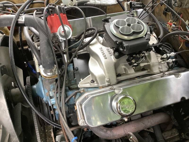

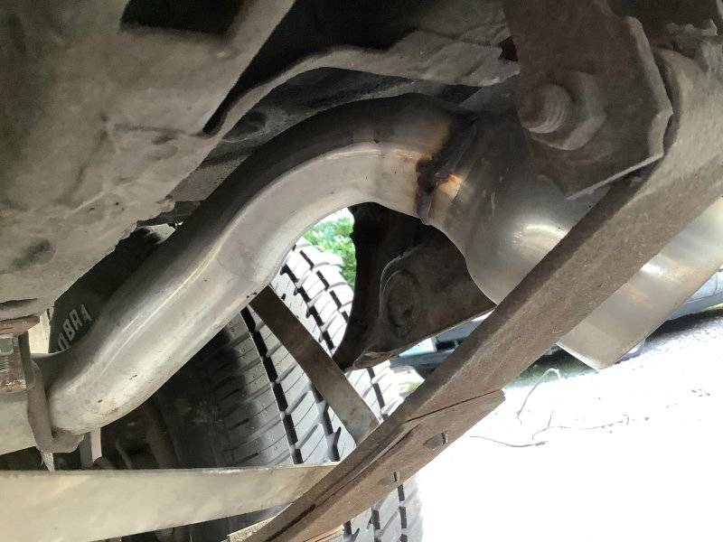

Part of the fun is learning how much work goes into making these cars so much fun to drive and deciding what’s in the budget for either dyi or taking a gamble on a shop. My Charger has the 400 motor from a 78 Cordoba that was purchased for that swap. The headers were a pain even with the swap involved. Headman headers fit decent in the car with a mini starter which still required dents for clearance. The collectors are snug with good ground clearance underneath.
No leaks or issues in around 7 years now but be prepared to do it right the first time and there will be minor issues. Then the smiles are always bigger when you drive around laughing.

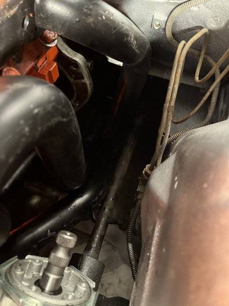

Hedman 78030 fit in my A body 383 with only minor tube denting on the drivers side. I bet they would be a cinch in your B body.
Yes but you have a manual box no column and I don't see a starter. So not really an apples to apples.
It’s an A body, it’s not Apple to apples at all. Y’all have way more room though.
Stock starter fits no problem, mini starter fits with a ding in one pipe. Steering column is being rebuilt, otherwise it fits right in.

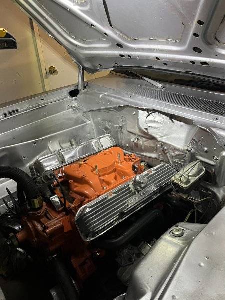

One other think no one mentioned is… is this a factory Big block car with the engine in and running already? If not there will be a need of some trimming of the passenger inner fender as small block inner fenders and big block inner fenders are different…
