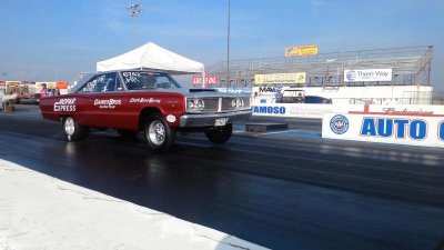

Scan0005.jpgBest Wheels Up.jpgHere are results of my 1st 5 Runs.
60" 660" 1/4ET 1/4MPH
Run #1 1.587 7.063 11.105 120.62
Run #2 1.574 7.042 11.077 120.85
Run #3 1.569 7.053 11.098 120.39
Run #4 1.557 7.005 11.045 120.62
Run #5 1.562 6.965 10.989 120.40 (got my 10's time slip)
Each run had a little tuning change made from prior run
Best ET (last run specs)
100 Octane Gas, 34 degrees timing, 83-90 Demon Jetting, Plugs gapped at 36,
Left at 3000 (off foot brake) shifted at 6100 on both 1-2 and 2-3. Trapped lites
at 6200. 16lbs air in my M/T Bias Ply DOT ET Streets 28x13.50x15 with 11" tread width
Cal Trac MonoLeaf - Bars set just touching roll pin on Passenger Side and 2 flats of preload on Driver Side with me in Car. 9 Way Cal Trac Shocks set on 7. (out of 9)
I think (hope) there is another 1.5 tenth (to go 10.80's) in the thing with more Test & Tune Track Time.
Thanks for your support, Mike
PS: It is my 505" new build
Indy SEZ (non-max wedge port) heads
12.2-1 Compression Ratio
Comp Solid Flat Tappet at 6.60 lift after accounting for my 1.6 Rocker (.024 lash)
Indy Dual Plane (non-max wedge ports)
Mighty Demon 850
MSD Dist, wires, etc
Mallory return style Regulator at 9lbs
Hooker 1 7/8 Super Comp Headers with no mufflers or exhaust pipes
5000 Flash Ultimate Converter
4.30 (spool) in my Dana
We video shot the launch I had zero wheel spin at 16lbs with the Bias Ply 28" ET Streets with 11" tread width.

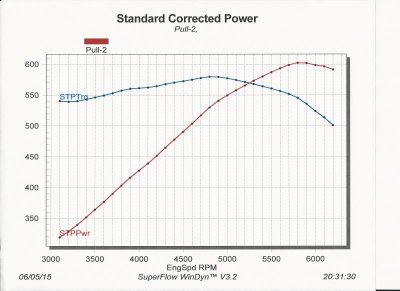

I have included my Engine Dyno Sheet for recommendations from you guys....

Very nice Mike. I was wondering if you had the eng on a dyno ? You might try to lower your shift point a tad and see if the stroker likes it since they dont always need to be shifted to high with the torque curve they have. I see you run 28" tires with 4.30's as I run 30" tires with 4.30's and I feel I may go faster with less gear but I have not tried it yet as I would like to try a taller tire and see if the car likes it. Our combo's are close but you run more comp then me and a little more cam and converter. I also run my total timing at 37 degrees as the car seems to like it best there. You are getting there for sure and I know you will be solidly in the 10's soon as you keep plugging away at it. Congrats on hitting the 10's already and good luck in getting even faster. Ron
