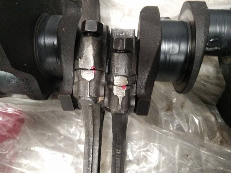

I punti che ho segnato in rosso del passaggio olio sono in questa posizione?
Are the points I marked in red of the oil passage in this position?

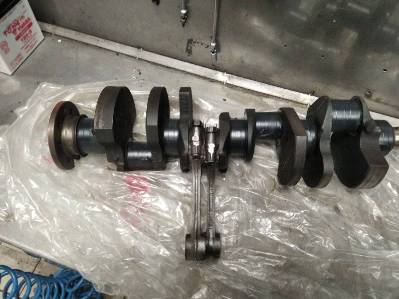

They don't look like it. I would need to see that crank in person. Itdoesn't look too swell. This whole thing looks like an accident waiting to happen.
the crank still needs treatment, now I'm assembling the sequence of connecting rods on the pistons
The crank looks like burnt toast. And the rods should be resized as well, they can figure out what went where, and mark them.
So for clarity, you put tape on the crank journals to somewhat protect them?
As for the rod oil holes, your red dots are likely the oil holes, but at least one of the rods would have to be installed the other way so that both oil holes point to the center where the cam is located. Take a look at the big rod bore and notice the larger radius that will go toward the outer sides of the crank throw.

I put the adhesive tape, because the shaft will have to be sandblasted and polished, in the meantime I prepared the sequence of pistons attached to the connecting rods, I have a Chrysler manual, but I haven't seen this thing about the connecting rod holes
