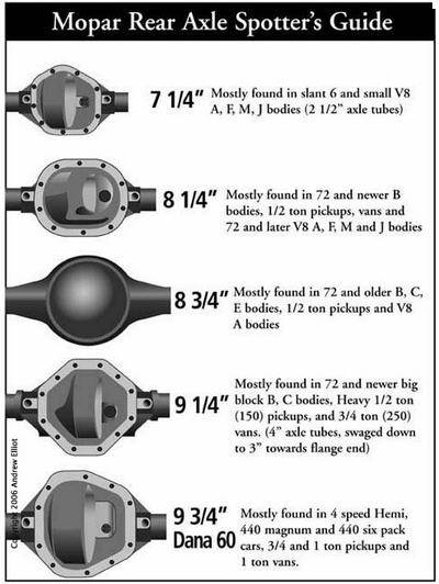

How about a pic of the rear end? I have my doubts that it is a dana whereas I bet it's probably 8 3/4.
How wide of tires are you running?[/QUOTE
I can remember 4 mpg but gas was $0.35 per gal. . Cost a whole $5 to fill the tank.
Oky doky, Tires are 215/75/15's. The guy never said "dana" but did say 9 3/4 and the word "upgraded" ...makes no sense.
The rear end has a very removable rear cover with 10 bolts. The cover also is round or slightly oblong with a big *** contour hump off to one side. It lacks any of those trapezoidal straight edges that I've seen on pictures of Dana's.
A bolt tag has "271" stamped on it. 271 gear ratio...I have no idea what he was aiming for. The rear end is a rabbit trail I think, but I am learning. I downloaded the manual for the carb, so Ill tune tune tune and try to figure out what the previous owner was thinking or not thinking as I go. Like the wheels...he spent some real money just to put modest tires on the car.

8 1/4 rear end is oval with 10 bolts
Yeah, I thought about that, I'll look at it closer tomorrow, the gas tank and my bad eyesight made it hard to see...but I'm assuming that wouldn't be an upgrade right? Actually, it closely resembles a 10 bolt GM rear end. At a 271 ratio, what sized tires should be on there?

I was going to say 9 1/4.
Yeah, I've been staring at that one for 2 days now. Still looks more like a round 10 bolt GM rear end with the convex contouring left of ctr. So, we've learned that traction bars are not needed on a 318...would a axle swap in anyway have need of, or involve installing traction bars? I honestly dont know.
On most 72-74 8 1/4 was standard unless big block or 4 barrel, then 8 3/4 and then very late 9 1/4.
Not a super easy swap as the frame width changed in 71 and only certain C body or wagon axles are a drop in.
Does it look like the spring perches have been moved...any evidence of them being welded on somewhere else, or non factory looking welds?
