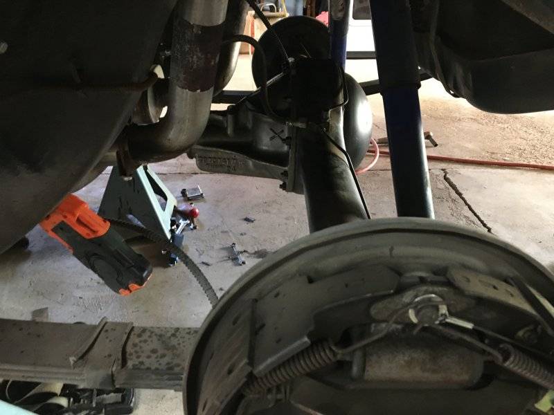

Been wanting to do this for a while. Man what a change like a new car. The 440 still has enough nuts to get a little sideways from a stop. 80 MPH @ 2200 is what I wanted though. Also leaned out the Holley 3310 from 72s to 70s and aPV from 6.5 to a 4.5. Now I can mess with the Imports on i-10. Less wear and tear and the MPG should improve. I can still go leaner on the Jets till I feel a surge. Like the Cop in Dirty Mary and Crazy Larry said, My top end is Unlimited. STOKED..

Exactly why I did it, I have the Duster to go Quick but I want to go Fast. Traffic Between Phoenix and El Paso is 85-90. Then when you get in Texas its Katy bar the Door. Hot Shot guys towing big trailers are @ 80 easy. I hated gettin passed by a Prius.

I hear ya man. 323s are a good all around gear and I drove with them all over. Just dont like screaming at 3800 all day long. Down the road a bit here is like 90 miles. 80 MPH at 2200 is more like it.

I was thinking about a TKO but to convert from auto is about 5-6 grand. I had a 741 case and one of the members here gifted me the gears. Just had to buy a bearing kit from Dr.Diff. 2.76 is about the same as the 0.68 OD trans. Happy Camper here.
