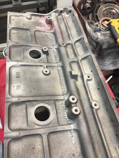

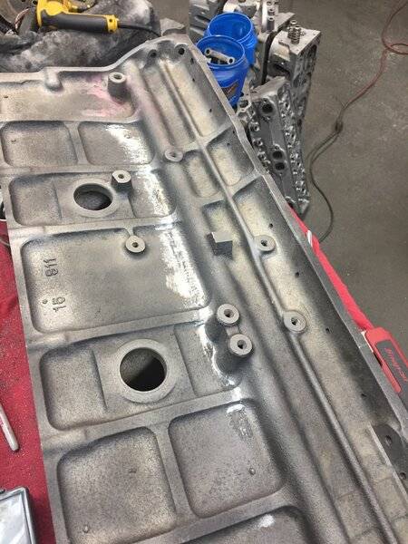

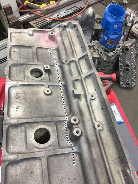

I use the "Lock-N-Stitch" product all of the time, and have not had any issues. Hell, I even fixed the rear of a slant six just below the head, and it was super thin there. The longest crack I repaired was 17", a GM 235 that was split stem to stern. The customer didn't want a new block, so he asked me to fix it. An inch and a half crack in the middle of the side would be easy to repair, and wouldn't cost anywhere near the other block you mention. Fix the one you already have and don't worry about it.
