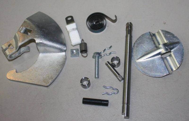

Your 383 in 67 to 69 used a stamped counter weight.

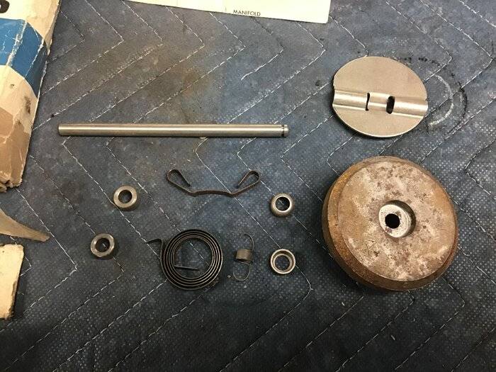

In 70 they went to a solid cast round counterweight.
My 69 Barracuda came with a cast weight. I drilled a small hole it it and wrapped a wire through the damper and around the bolt for the down pipe.
