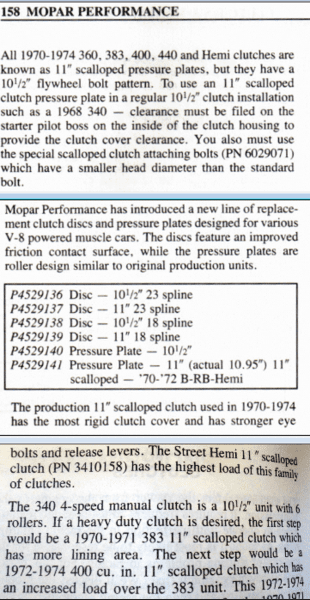

......(what the heck is a
10.95" clutch, for example?).....
10.95" = "scalloped" and bolt up to the 130 tooth fly wheel........

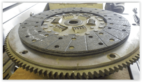

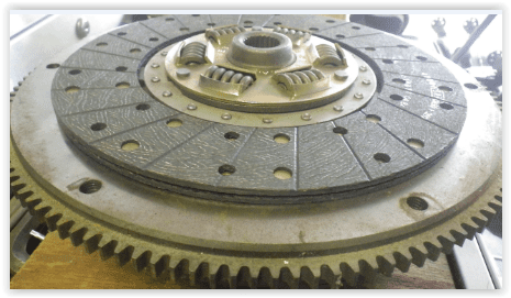

FWIW, Yes the surfaces are different but it is possible (although unlikely) to install a B&B disc backwards IMO.
Below is a 10-1/2" MP disc centered and sitting on flywheel (130 tooth) bolt heads does leave a small gap here. (.030" faced off this FW)
Wrong.....
Correct......

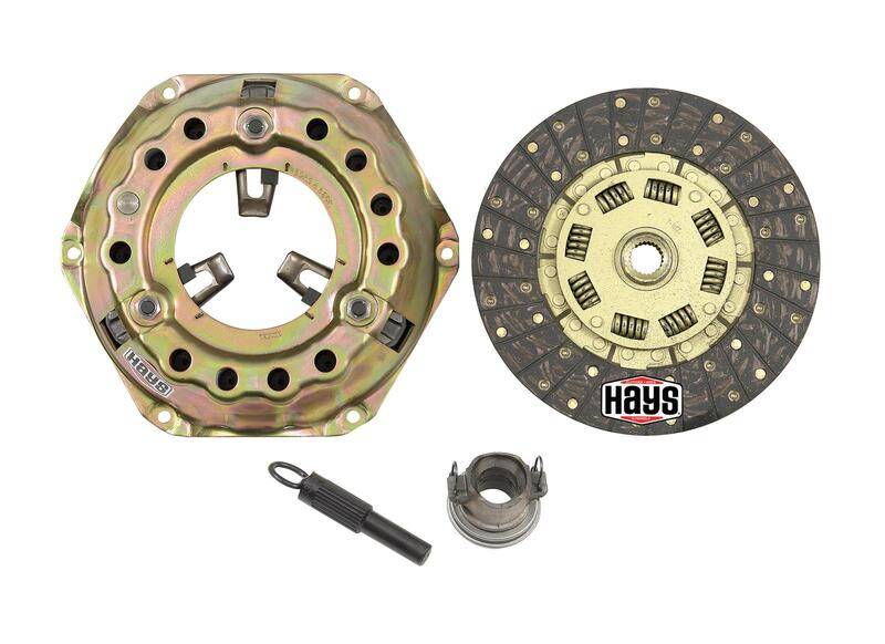

Thanks Dave, it is a 69 car, the 440 is a 74, A8333 is a 69. The hays part number I purchased is:
HAY-85-301
BTW, anyone hear of different lengths of a throw-out bearing being used on a 440/A833 set up?
HAY-85-301

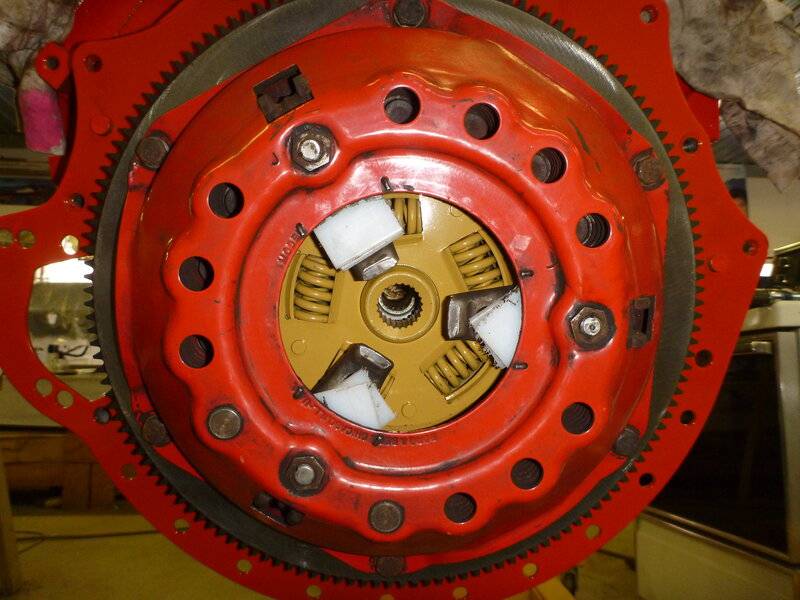

Those pressure plates ship with spacers between the fingers and the cover that limit movement. They must be removed after installation. Is it possible they are somehow left in?
They should all fall out on the first clutch depression and be sitting in the bottom of the bellhousing if that was the case. MY own rendition for install, so you don't warp the plate. 40 year old clutch pressure plate, still works like a champ..
Wrong.....
Correct......

Oh....and what's with this 11.95" clutch setup that supposedly works on the 11" flywheel?

Not Hayes, not McLeod, nada. I don't really know that much about alternatives (what the heck is a
10.95" clutch, for example?). I have the heavy 11" factory flywheel, the factory 11" bellhousing, etc.
