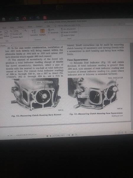

The bell housing check is for misalignment, not so much out of round.

I would install the flywheel and bellhousing and check the run out of the flywheel face. I’m not sure whether it could affect it but maybe the flywheel face is not running parallel to the back of the bellhousing. Another thing is that you could have someone depress the clutch and measure the distance between the clutch face and the pressure plate in a few locations. You might want to do the same thing with the clutch fully engaged.
