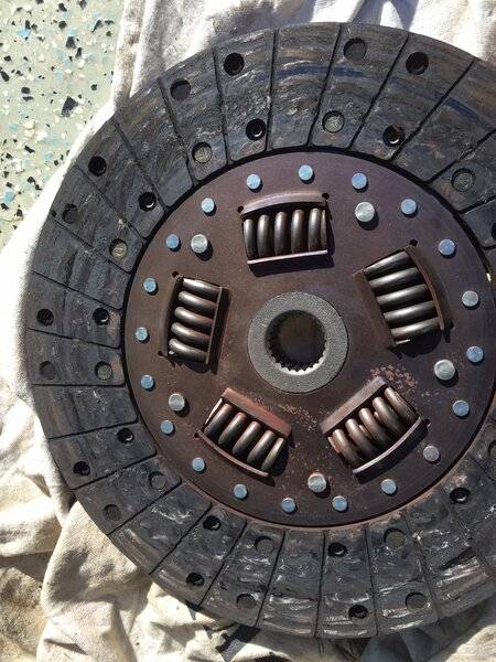

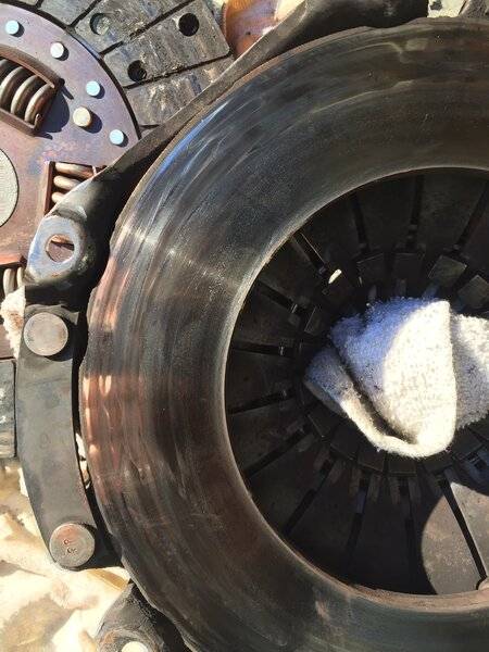

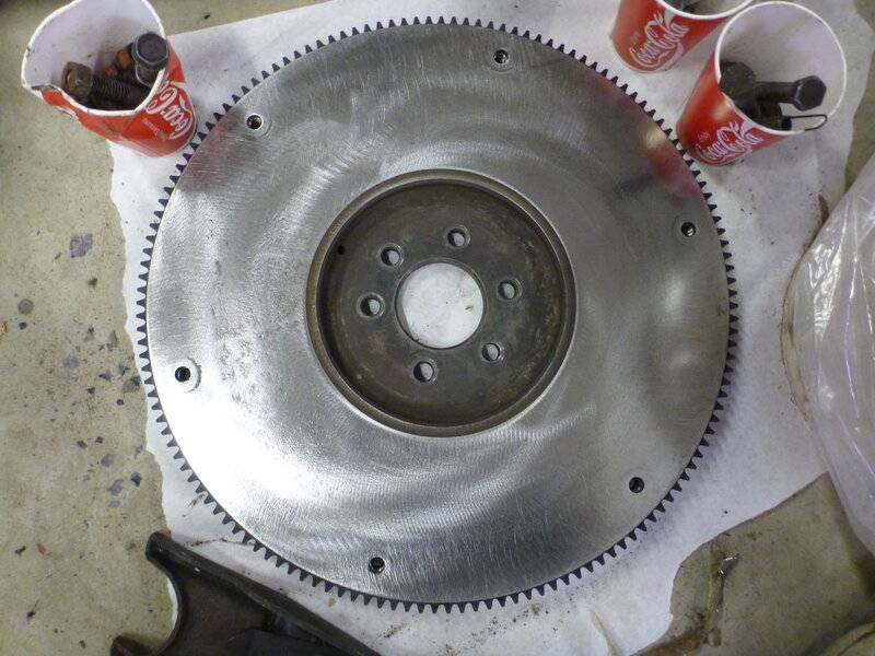

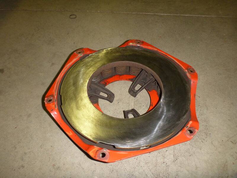

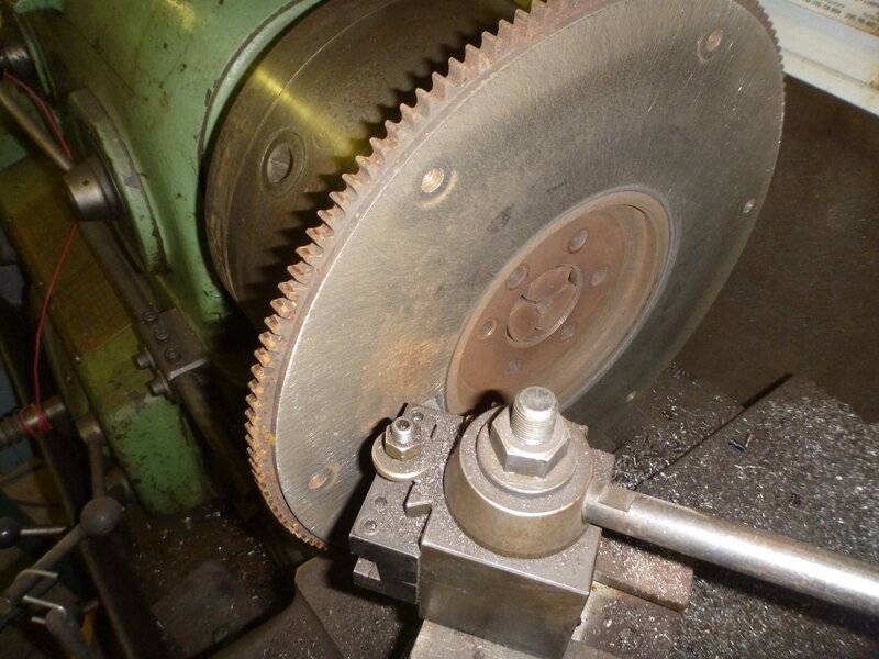

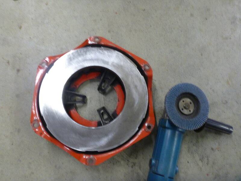

Mine wasn't that bad looking, but a quick lick with a 60 grit disc and it's as rock solid as it was in '79! Faced the OE flywheel in my old Forward lathe and then gave it the same cross hatch treatment with the flap wheel while rotating in the lathe.
