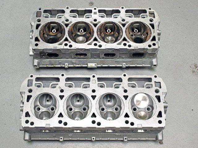

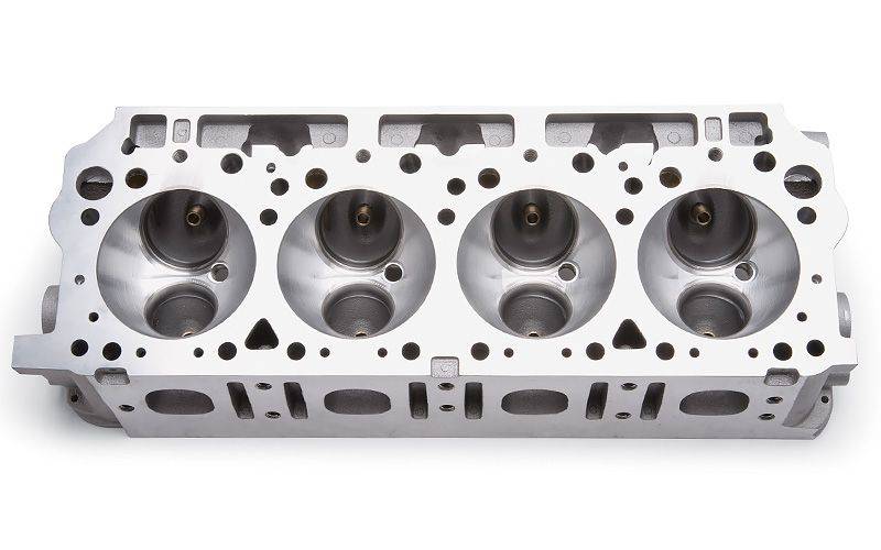

Gen III hemis as called do not have hemispherical Combustion chambers. They have modified wedge chambers similar to a polysperical chamber. The Gen II head is a true halpf of a sphere. If you look at the Gen II it has squish chambers like a wedge head to help with emissions. The true Hemi is capable of unbelievable power like no other motor ever developed because of the chamber and short runner lengths. I am not looking to bad mouth the new motor since it is far better than anything out their that is new. With correct Heads this motor will be amazing.
51a21031995bfae5cf5c7c9eacef2efa.jpg mopp_0810_21_z+hemi_valvetrain_and_head_upgrades+.jpg
View attachment 654031 View attachment 654032
Not to be a heretic but cam and valve spring improvements have taken much of Hemi's advantage in normally aspirated engines. MO. PS I own gen2 hemis.
Sorry fran not sure what your saying
What I'm saying is the engine design doesn't have the advantage that it had in the 60's and early 70's. Cam and valve spring improvements negated some of advantages.
I am not sure i agree, since i am running the Jessel Rocker system with a street roller. What other engine has the same short intake and exhaust runners? You could say the cost of building a Hemi is crazy at 30,000.00 for a basic engine/
