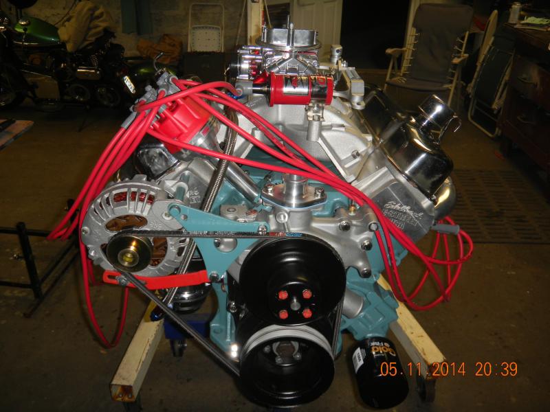

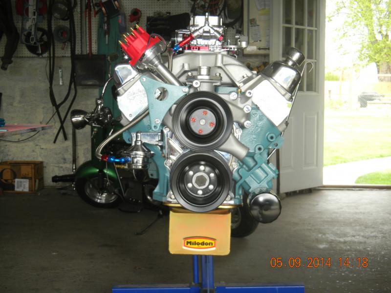

Hello All,The old 426 is coming together.Here's some of my build.The pistons are .007 out of the hole,with a .051 cometic head gaskets.
.030 Race-tec special made pistons /milled dish/19.000cc
comp cam xe275hl .525 lift
eddy e street 75cc
eagle crank 4.150 stroke.Eagle rods
10-1 comp
478 cu in
Nice date on that last picture.

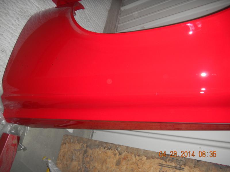

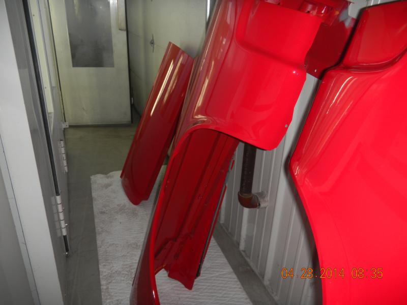

Hello All,got some parts painted it won't be long now untill the coronet comes home. painted parts 001.jpgpainted parts 002.jpgpainted parts 003.jpgpainted parts 004.jpg

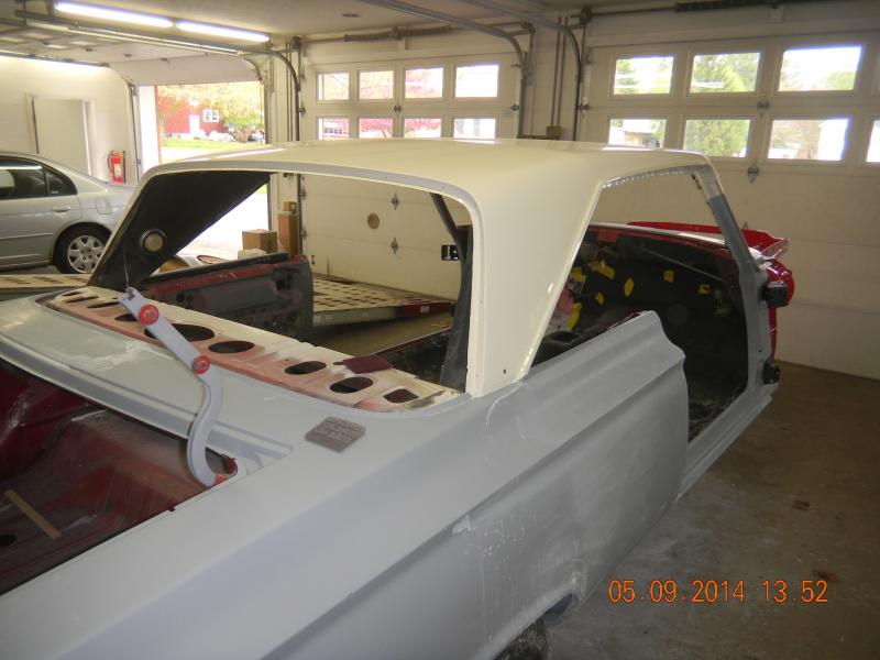

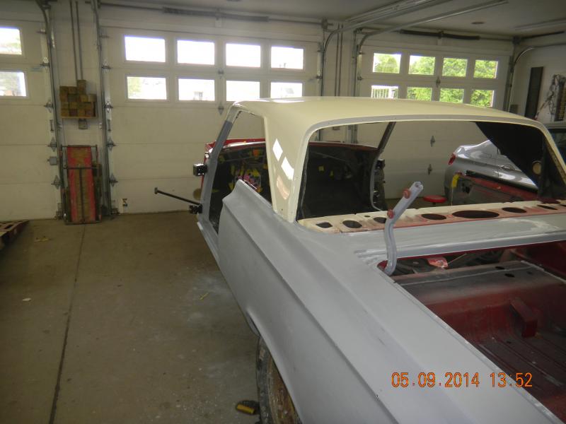

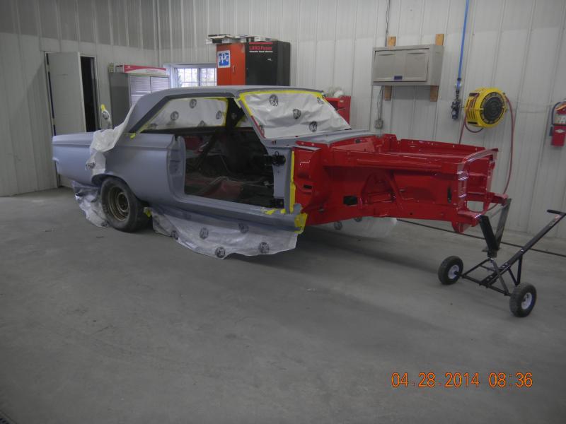

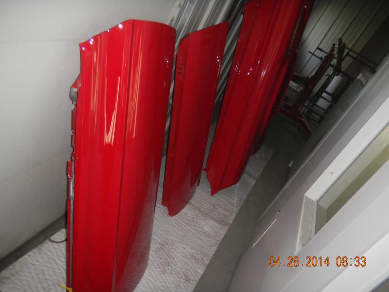

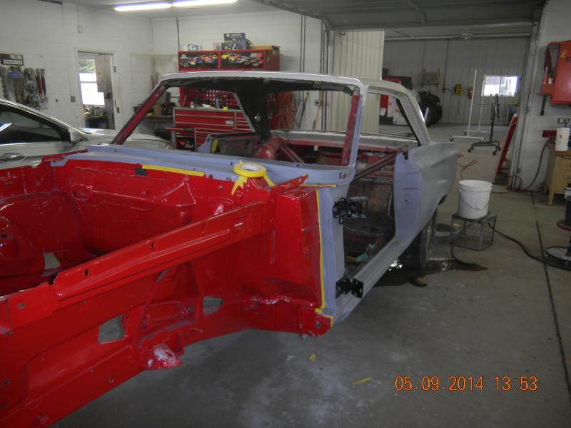

Hello All,The engine is done.The old 426 is going on a Dyno on tuesday I"ll try to post results on video on this thread.Mccellans body shop is moving right alone with paint on the coronet white is done going for red on monday.Denney Mccellan owner and his crew Randy, Don, and new painter Scott are making the dodge look better than new.In my opinion the car looks flawless. see ya on Tuesday.

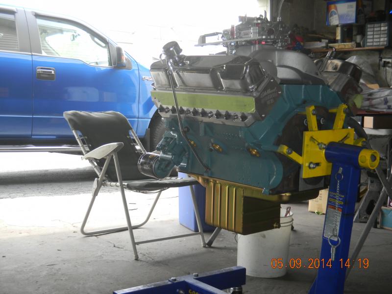

ready for the dyno

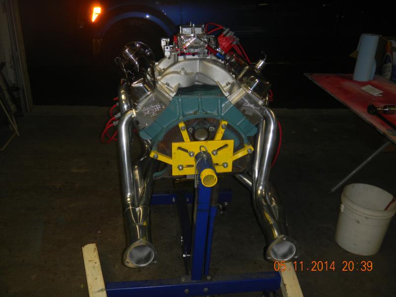

When I get the engine in the car with wire looms it may look better than it does now.I not sure what kind of header Rhoads performance (the shop with dyno)has so I kinda just threw them on.I'm geting butterflies now can't wait untill tomorrow.It will be a sleepless night I'm sure. Dave L

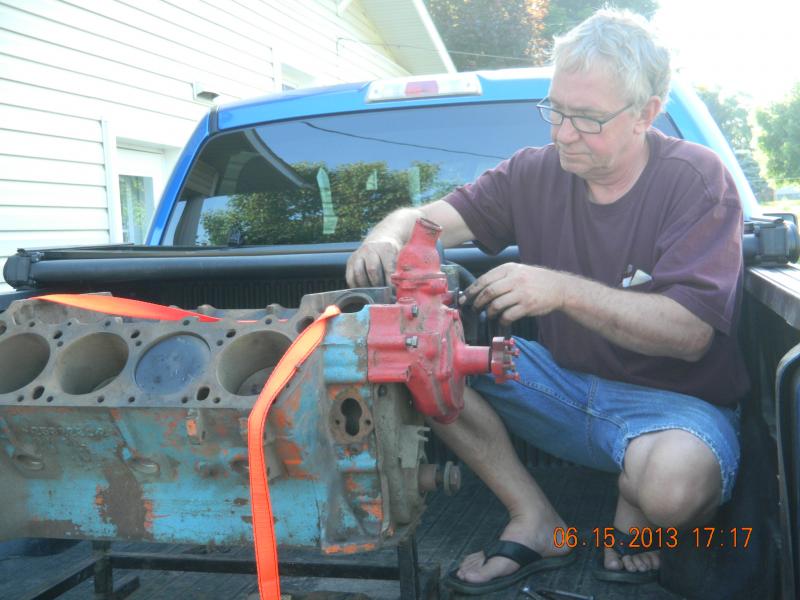

Hello All,Bill Overcash,Don Carnell and myself took my engine to rhoades performance for a dyno test.The test was going good for the break in time,The old 426 was sounding very strong.Dan at rhoads was behind the controls.After break in period it was time to check for leaks or anything else that maybe wrong before the inital test.Dan has noticed a little water near the frost plug sure enough the block is cracked at the bottom of the water jacket near the drain plug.I talked to so many people about a sure fix it stuff none of them sounded appearing to me.I have decided to take the block to an expert welder in cast iron.He said he would give it his best and added sometimes when welding another crack may appear depending on the quality of the cast iron, and that he welded many blocks with good results.The crack is low enough that I could Hard block about an inch and cure the problem.With hard blocking would mean back to the machine shop for some honing for size.The engine is at the welders now so I will know soon.I be sure to keep all of you posted. Just another bump in the road!!! Dave L
Did the machinist mag the block??? If so, he should have seen it!!
My machinist has alot on his mind with family sickness so we will leave it at that.I will deal with it. Thanks Dave L
Good luck with that sounds like you have a handle on the problem.
