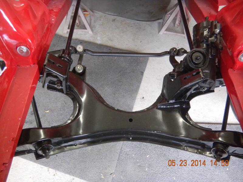

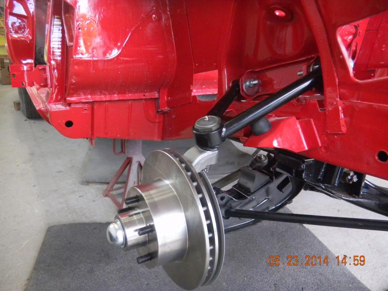

Hello All,I decided to scrap the block.Does anyone have a 426 street wedge stuffed under their work bench Pm me. I went to Mccellans a couple of days this week and was able to get the K frame built and the rotors on.I have to send the sway bar back because they sent me the wrong one.The old dodge is sitting on all four again with the help of the wife puting on tires. We will let it sit and settle in all weekend then assemble some time next week.Thanks for the usefull tip on the rubber hose in the drain hole when hard blocking.Have a nice holliday.Dave L

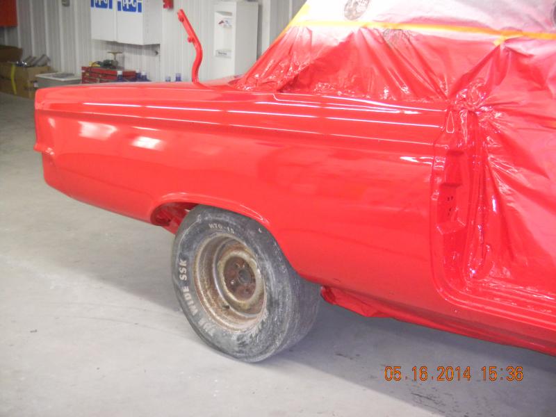

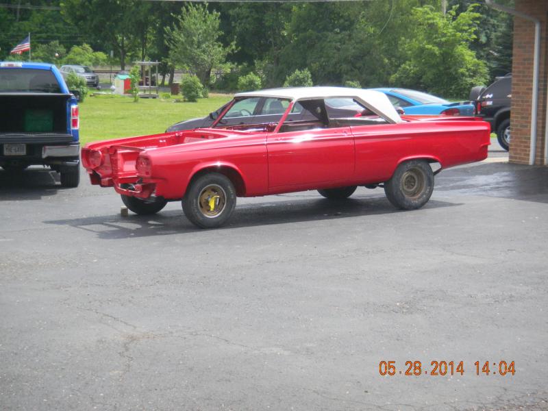

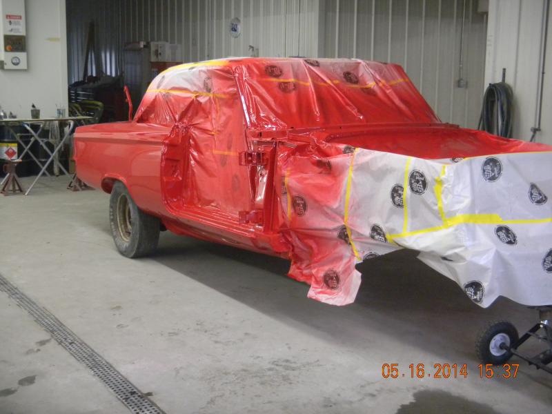

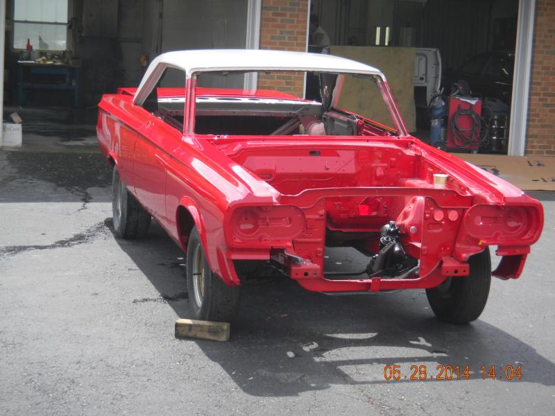

Hello All,Denny Mccellan owner of Mccellans body shop,Don Patton,and myself bolted some metal on the old Dodge today.I thought I give you an update Dave L

Dave the color looks GREAT and the body lines look awesome too! NICE job!
Any more on the engine tho?
Dave,
Paint looks awesome. Are you going with the orginal 1965 "Bright Red" color?
