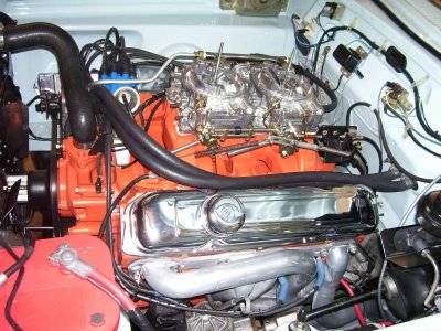

i did a 440 years ago with 8.5 comp, 509 MP cam, Edelbrock RPM, holley 750 vacuum secondary, that setup didnt run for ****, so i took the six pack off my Cuda and it worked like a champ.

believe it or not this set-up has very good throttle response, starts easy, drives great, and the fuel mileage isn't any worse than anything else i've ran. down side is fabbing some brackets and the tiny air filter.
