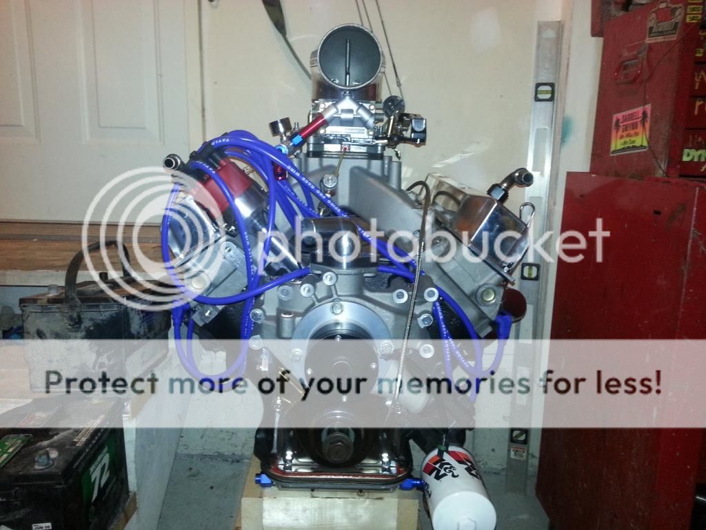

I used a 78 block to build my stroker 514 turbo motor we replaced all 5 main caps with billet ones and added a 7/16's main stud gurdle and head studs
here's some pix
Mike1965, that looks amazing. Would love having that sitting in my garage waiting too be dropped between the frame rails of my roadrunner.
