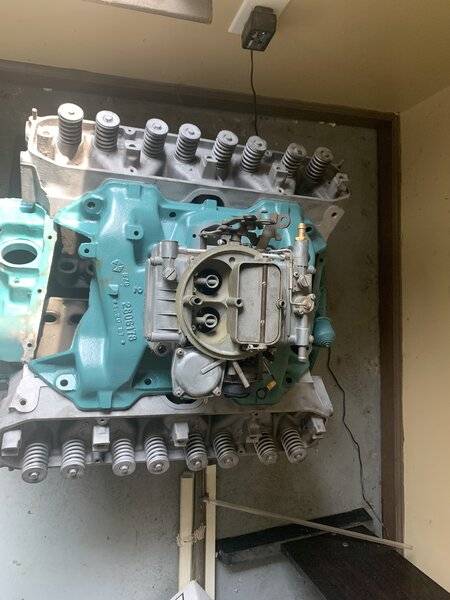

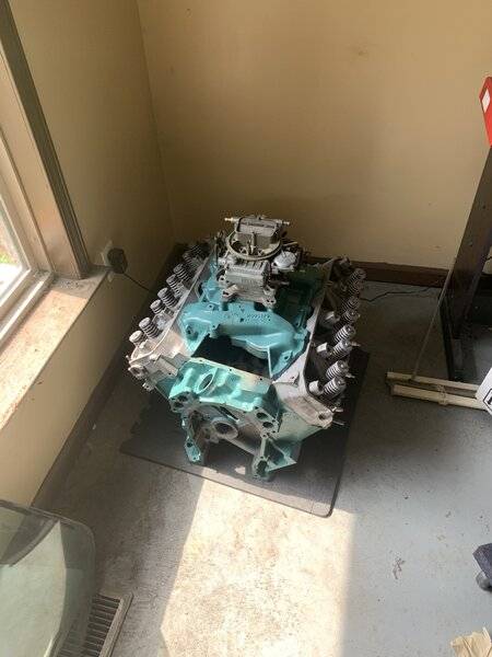

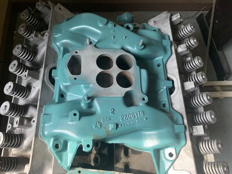

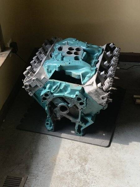

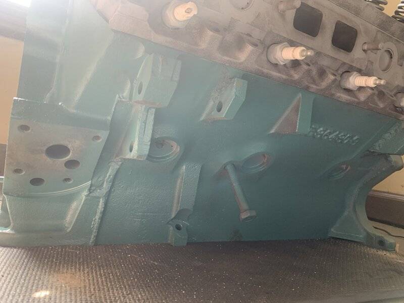

Yeah those look like the smaller exhaust valve heads but still closed chamber.
Just have the machinist put in the bigger valves and hardened seats when you have them rebuilt.

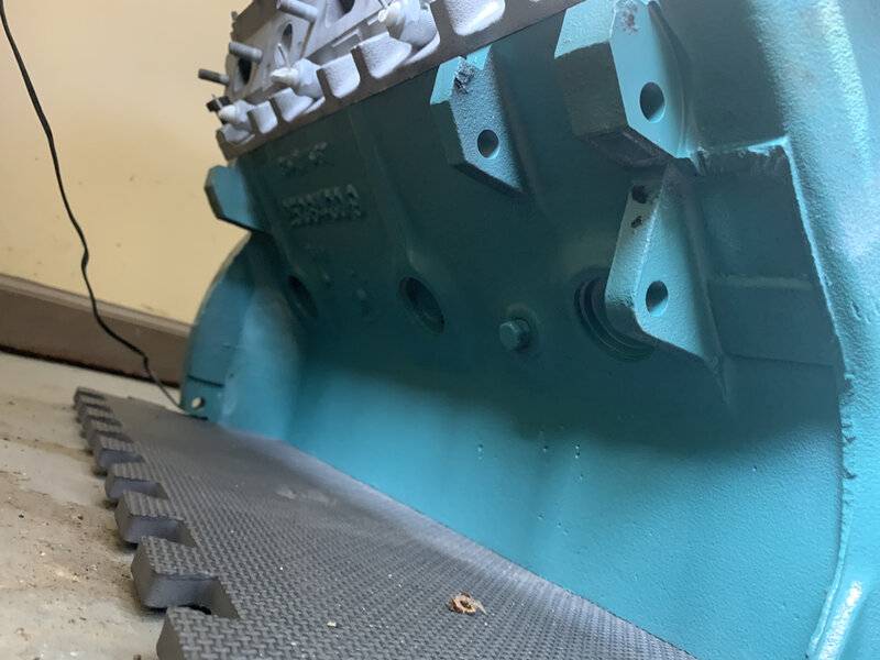

As far as matching date code, if they are within a couple 3 months of each other they probably are a matching set.
