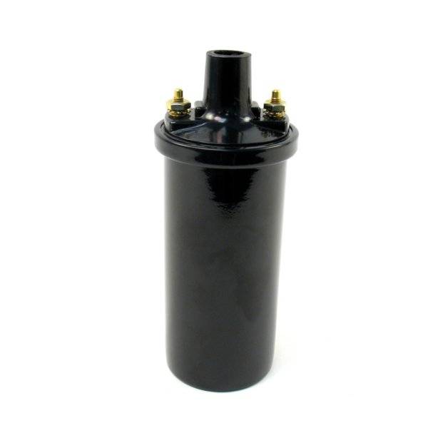

That sounds to me like a bad coil...that's exactly how they've acted when they've gone bad on me in the past. This is of course assuming the carbs are setup close enough for it to run. The carb adjustments don't need to be perfect for it to at least idle, it may idle crappy but it should run. Check or even swap the coil with a known good one, even a stock replacement cheapy if you have to. You can always keep it for a backup which is never a bad idea with these old babys..
My 2-cents. First, beanhead has an interesting point about the coil & the above advice is all good.
If it were me, I would turn up the idle screws to get it running & go from there. Making sure the timing is close too at the beginning. Then start looking for vacuum leaks & fix them. After that, start trying to tune the carburetors. At each step (timing, vacuum, carb tuning), the idle should go up & you can start turning down the idle screw(s).
I appreciate all the help, I'll take some pictures and video of the engine to show what it's doing, not too sure on how long the car was sitting or much about the specs. I just jumped at the chance to buy the car as it's been my dream car for as long as I can remember and I'm willing to put the time and money into it it's just like I said I'm not very mechanically knowledgeable so I wouldn't know how to figure out what the problem is so I could learn to fix it. And what do you mean by "coil"?
