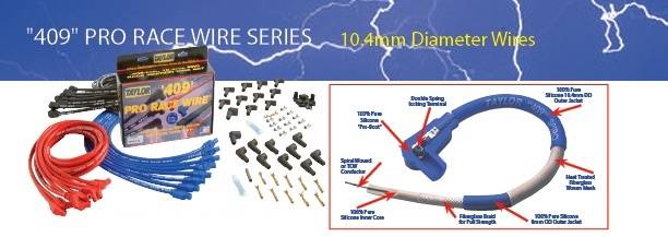

I run 10.4mm Taylor's on my built 440. Definitely worth the extra money. Don't forget the boots or the headers will eat them up.
