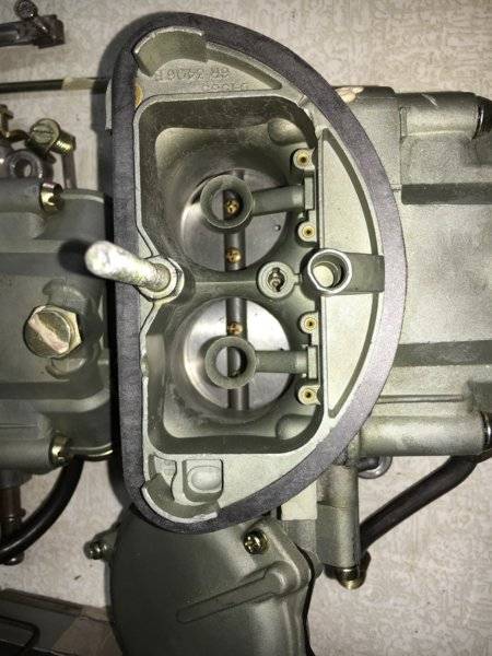

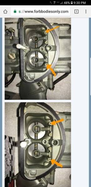

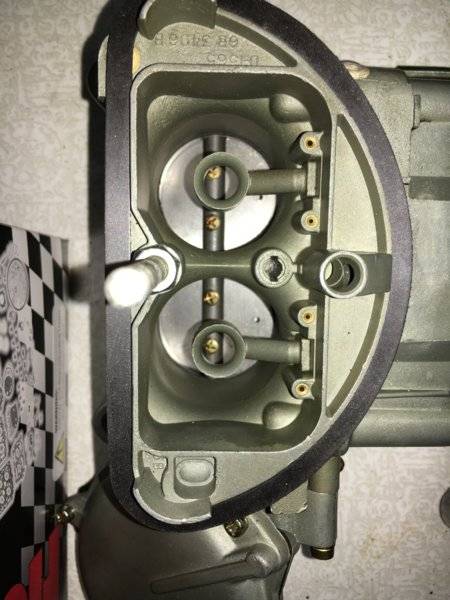

I'm looking down the carburetor throat, I see the four small holes, right side of photo, front end of carburetor, which of these four are the idle air bleed holes?
Please see the attached photos.
