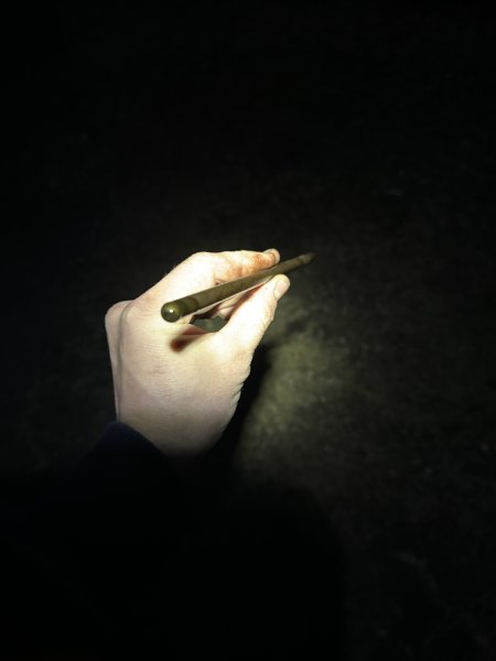

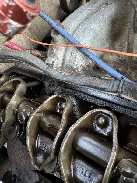

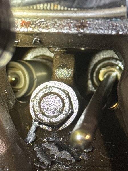

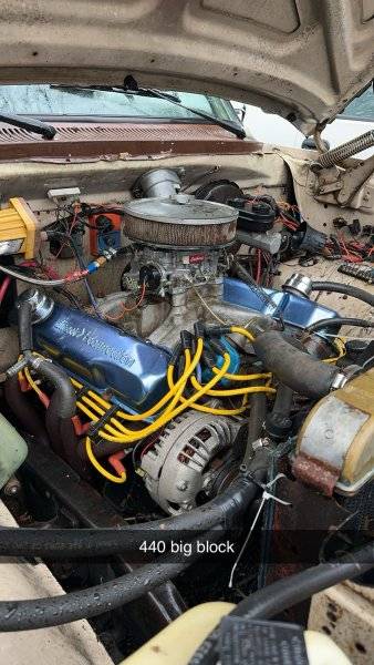

Just got this motor and it sounded a lil wonky. Might be cammed not sure what’s been done, has a Holley street dominator intake manifold, 600cfm Edelbrock carb, and long tube headers. No fire to cylinder 6 definitely have spark because i used a spark tester at the end of the plug. just did a compression test (cold motor all plugs removed full charged battery throttle wide open tested one cylinder at a time) here’s my results in psi

Run a leak down test. You could also pull the valve covers and inspect the valve train. If compression was ok I would be looking at the cap as 3 and 6 are next to each other.

Someone couldn't count to 8?

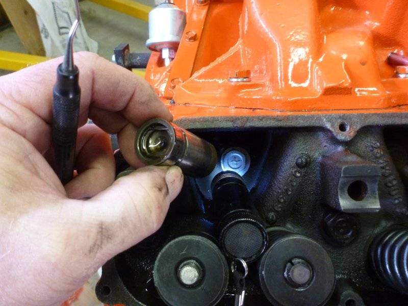

I would also get a light and inspect the top of the lifter if you can see it decently to check if the socket is ok, and nothing has come loose
