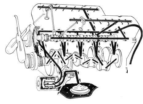

I'm confused. Why do the direction arrows show the oil flow out of the pickup?
Haha, I never noticed that... Boy that motors gonna have some real issues!

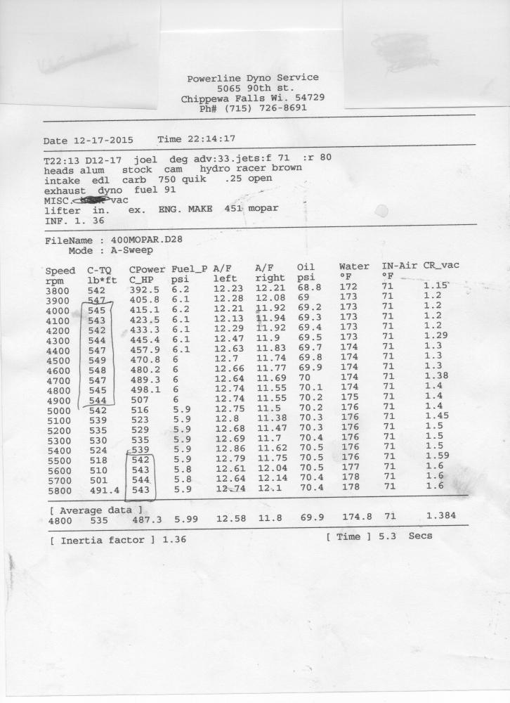

Thought I should get this thread updated as we just got the motor dyno'd last week with the new top end. We reused the bottom end which is a 440 stroker kit with 10:1 compression. Also reused the stock Stealth heads and Edelbrock RPM intake. New pieces consist of a Racer Brown SSH-44 hydraulic cam, Comp racing lifters, Harland Sharp roller rockers 1.6 intake 1.5 exhaust, Quick Fuel Q750 mech. secondary carb, FBO ignition box with rev limiter, blaster coil, and his distributor. I am down 12 ft. lbs of torque but up 22 hp from my old Comp 282 solid cam. Looking forward to getting it out on the road next spring.
Those are some healthy numbers, should shred the tires with ease!

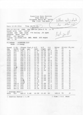

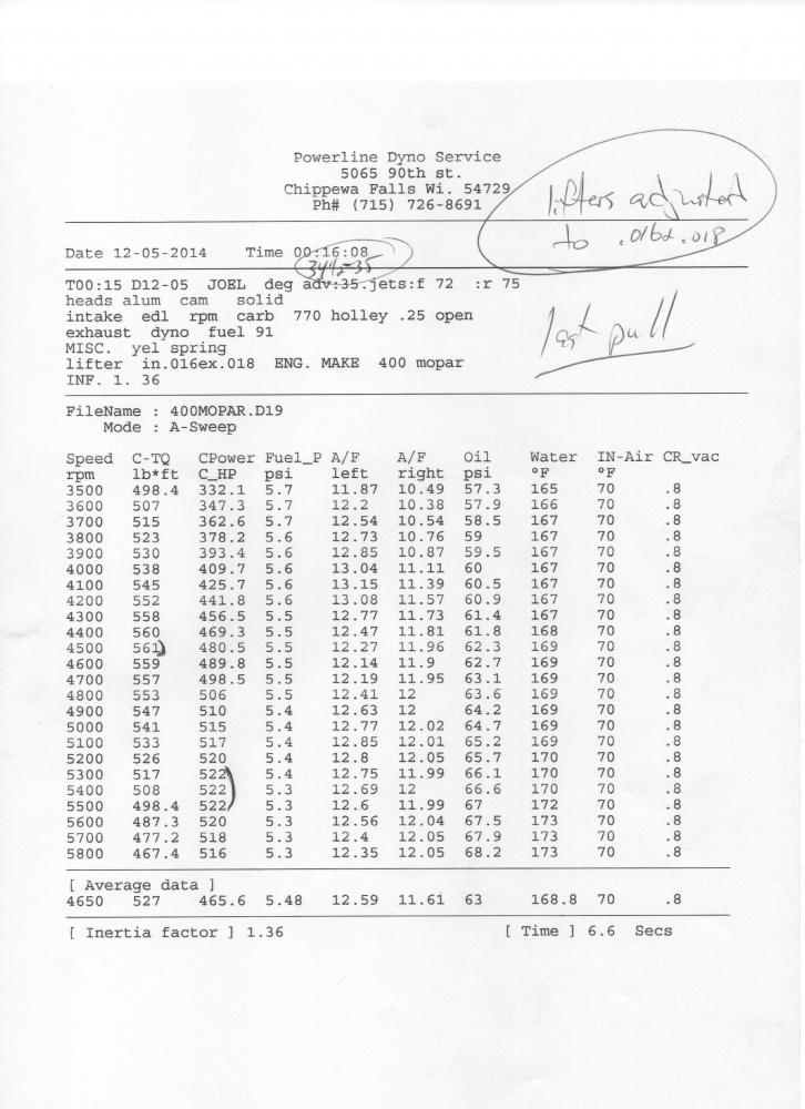

do you have a dyno sheet of the 282 magnum cam? it would be interesting to see what a larger carb would do.
As a matter of fact, I do. This is with the Comp 282 solid, Proform roller rockers, Holley 770 Street Avenger. We did make a couple of pulls with this set up and a new 850 Holley double pumper. That carb added 8 hp and 8 ft.lbs to these #'s.
