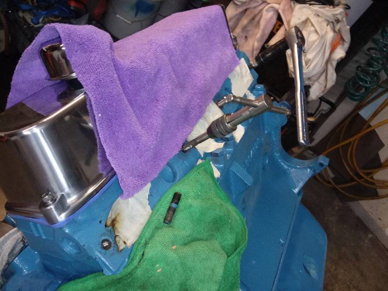

Actually I guess the not fit problem on the valve cover bolts is not arp's fault. I'm sure the bolts fit fine on stock or similar but these have a thick bolt area, which I should have thought of. But the smaller heads/wrench sizes is not a good thing, in some spots... I removed the exhaust studs, with some difficulty., won't need them in the way of the headers.

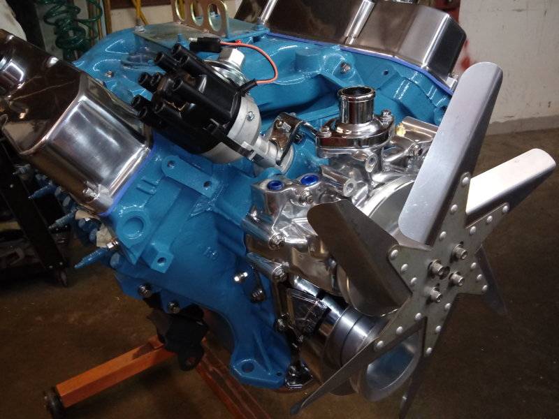

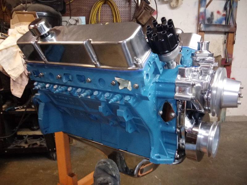

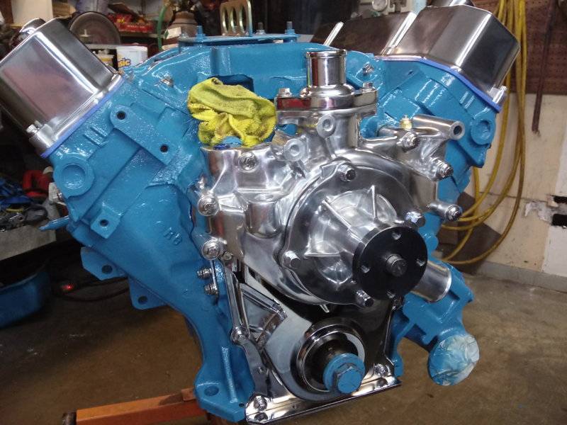

I think I'm going crazy with the shiny stuff, I can't stop.. Nice deal on this pump from 440source.

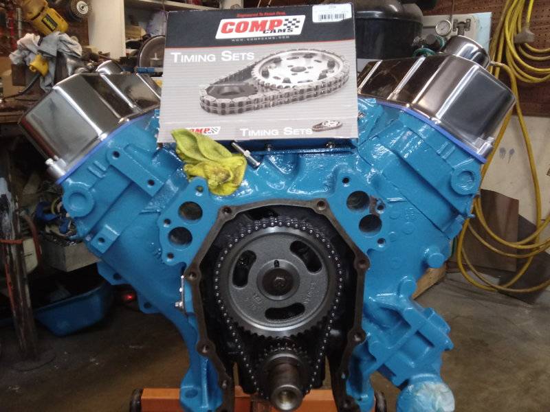

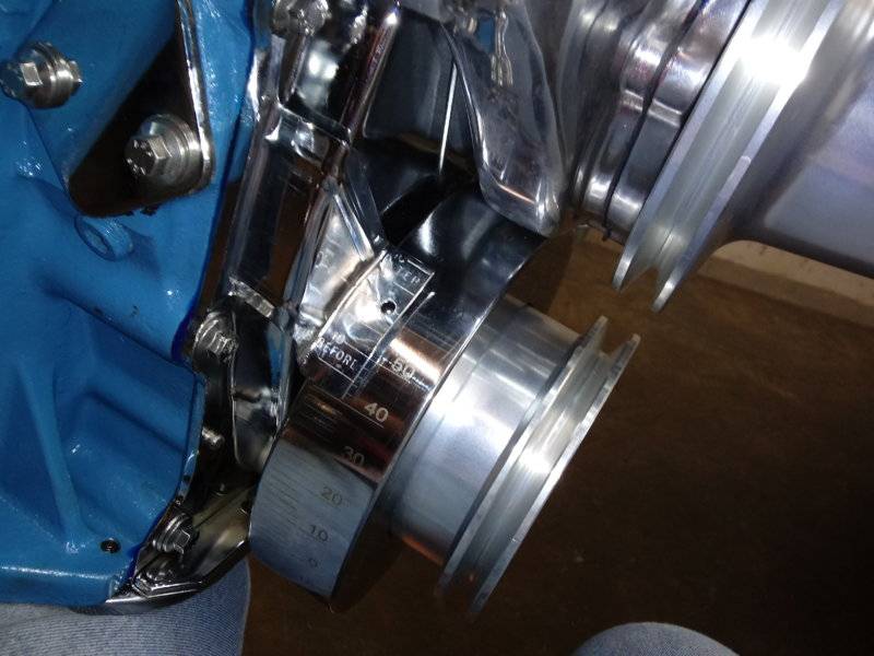

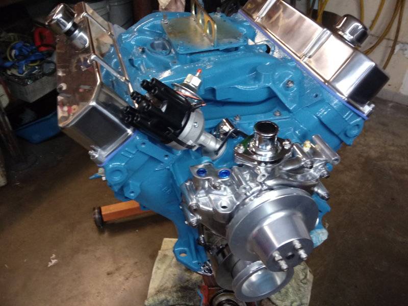

I put a new timing gears and chain set on, then the cover and water pump final bolt down. Anyone know how I can tell what carb was on this 440 motor. I think it came out of a 72RR. I want to put a holley on it and hope I can use an adapter if necessary.
I don't know what was on it but you can't go wrong with a Holley. If mostly racing a 750-850 double pumper, street use a vac. secondary. My 2 cents. A Eddy performer RPM would be a good intake, that'd still give you hood clearance.
I'm not planning on buying an intake for this motor, yet anyway. I'm trying to buy nice stuff for it but only if it will also fit the 400/512 that I'm hoping to build later when time and money allows. I don't really know how healthy this 440 is. It did pass the compression and leak down tests but I'm not real confident with it. If I buy a new intake I'd probably go ahead and get aluminum heads, cam, ect., and rebuild the short block. I'm pretty sure this is a smog motor with 8 to 1 pistons, very low hp. It is going in the car for now just to get it running/rolling, probably no racing with it., may rebuild it after the 512 or sell it...

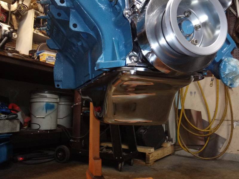

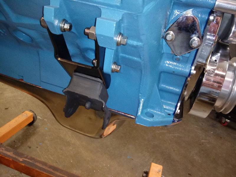

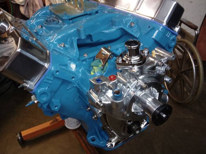

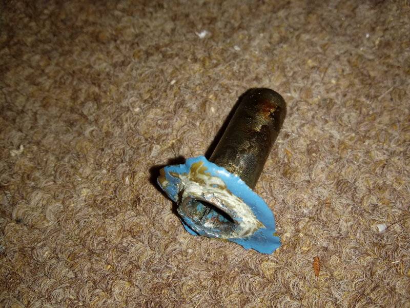

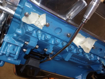

Got the mounts on and the dipstick. I recalled how difficult it is to get the new dipsticks in but when I started I said there is no way. The guy who had this motor had broken the dipstick off, so fortunately since I had the pan off it was easy to tap out with a punch. I still had to dremel the new tube down quite a bit before it would fit. Then tapped it on in with a little hammer and an open end wrench that fit snug on it.
20190118_205543.jpg 20190118_210103.jpg 20190118_220802.jpg 20190118_220056.jpg
At least you put the dipstick on before the engine was installed. I had not thought ahead enough and had to install mine with the engine in the car. I also had to file the tube to get it to fit.

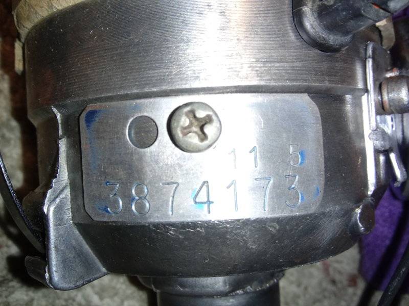

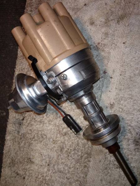

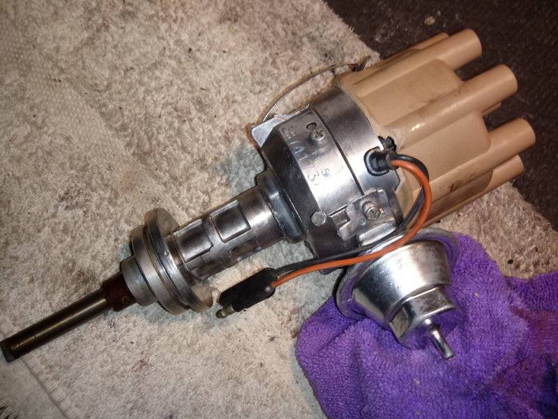

Kinda ran out of stuff to do while waiting on more parts and decided to go thru this old distributor that came with the 440. It was very cruddy and that's why I bought the new one. I took it apart, cleaned and lubed it. It is in fine shape. I may later try to find a short shaft to go in the new proform one for use on the 512, and put this old one in the 440 to help it sell.
20190121_194835[1].jpg 20190121_194923[1].jpg 20190121_194947[1].jpg View attachment 710396

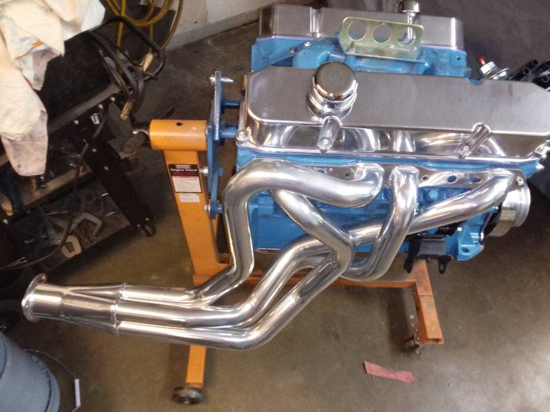

Got these Summit brand headers today. I ordered them 4 days ago for $437 and saw they went on sale yesterday for $393. Called them up and they gladly gave me back $44. Bravo Summit!
Make sure they will clear your torsion bars. I bought some for my car that did not clear my torsion bars. Mine were a different brand so your's are probably fine.

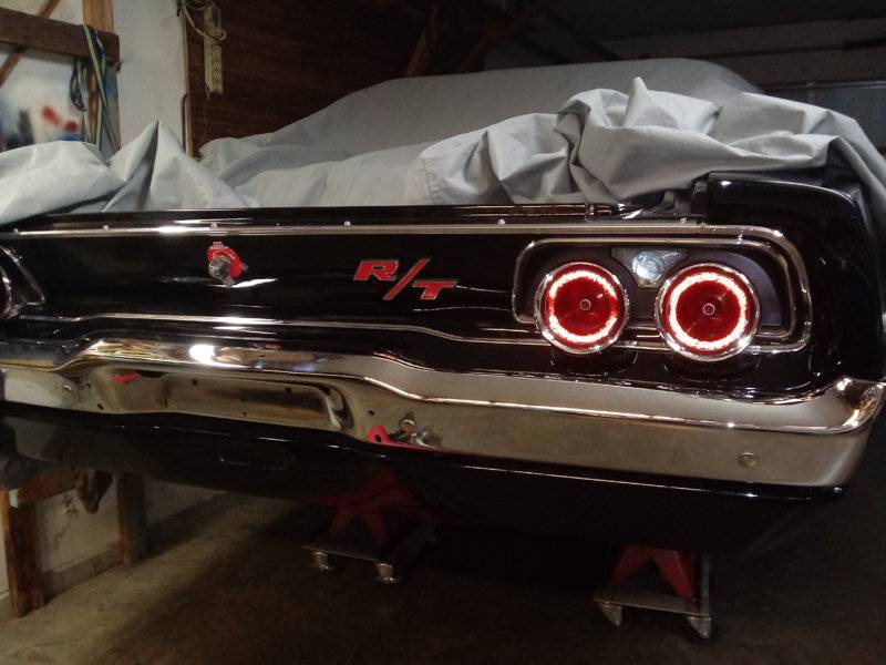

A bud gave me this late model rt badge that he bought at a garage sale for for $2, I said thanks but not sure about putting it on since it's off a late model and bigger than early stock. It is plastic tho and I could marine seal it on, or one the right size, instead of drilling holes.
