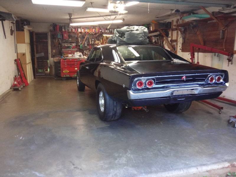

Yea it was a lot of work and took a lot out of me.... It sits a tad lower now but maybe it will sit down more, still has a little more weight to go on. The caltracs are in the lowest setting, may put some 1" or 2" lowering blocks on it..
Such a great feeling getting that motor mounted back in the car. Congrats!

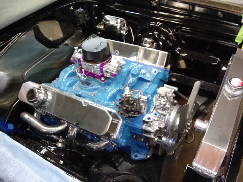

Added a few items today. Funny, I just noticed the windows on the carb, neato.. ha

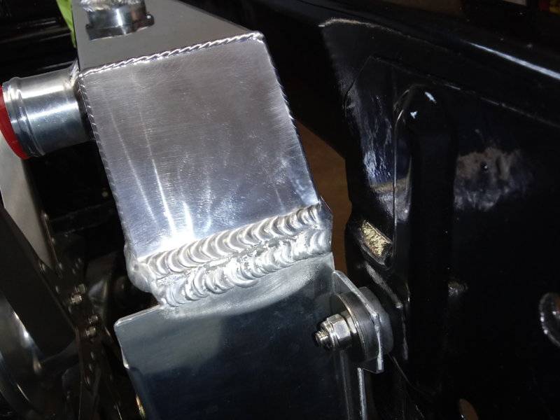

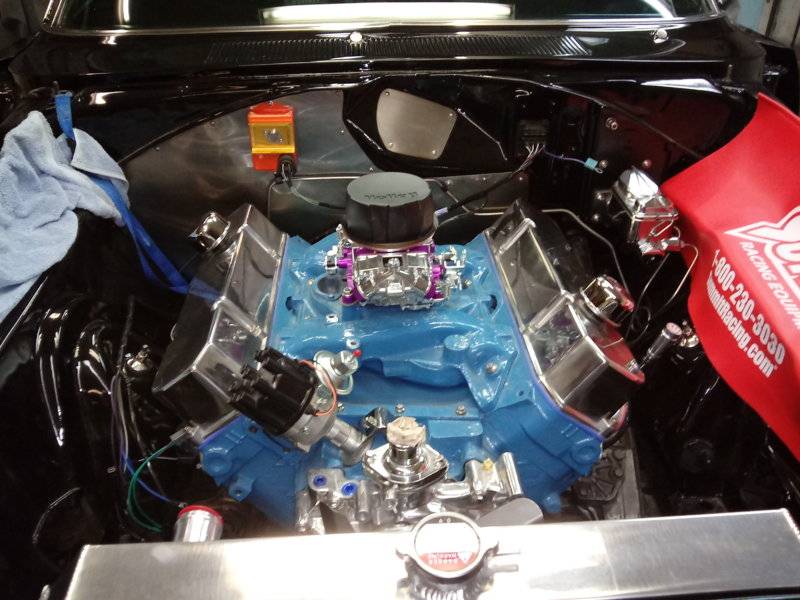

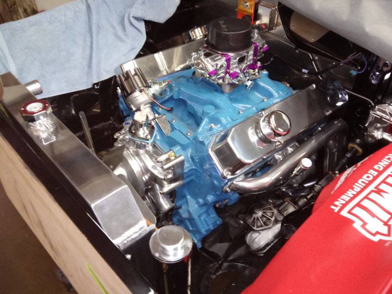

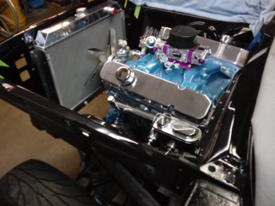

I rubber mounted the radiator today, same way as I did the fuel cell..
Mounted the ignition box and started messing with the engine harness, which I'm not looking forward to installing.
What brand valve covers are those, and curious if you are going to use a PCV valve?
Also did you use any foam to seal the radiator to the sheetmetal. It will help with cooling forcing the air to go through the radiator and not around.
Those are summit brand covers, not sure who actually makes them tho.
I will probably get a pcv, I assume it would be better off with one, right?

That is a good idea, may do that.
Yes, should have a breather on one side and a PCV valve on the other.
i have the same valve covers check the gromet size before you ordering a pcv, those covers have a 1.16 grommet size or hole size. i believe, going into them, i ordered the wrong size the first time. looking fantastic by the way, you gotta be excited with the motor sitting in there, won't be long till IT'S ALIVE!

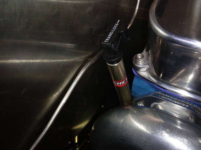

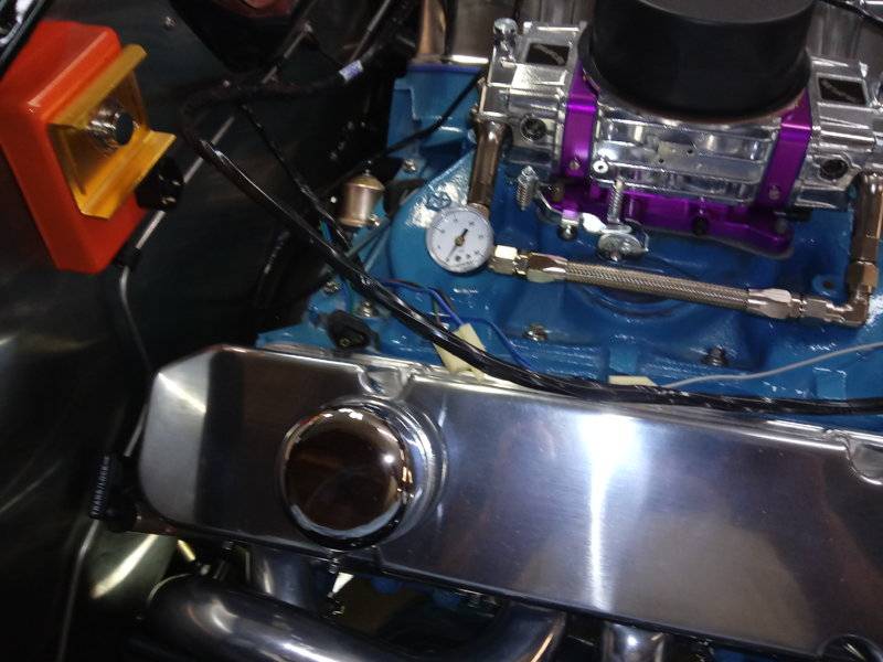

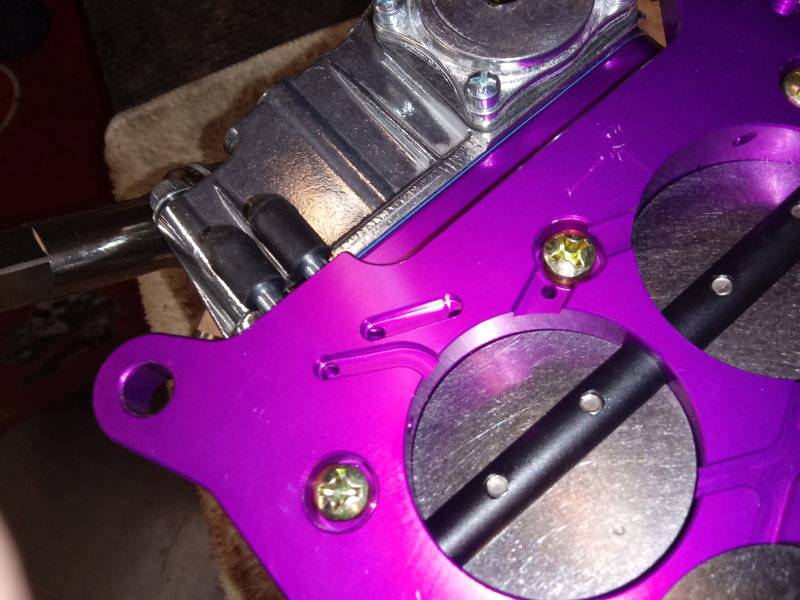

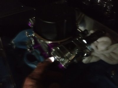

Got a new Hughes locking trans dipstick & tube installed. And a Quick Fuel supply line and gauge for the carb. Speaking of the carb, Does anyone know which one of those vacuum line ports I should hook to the distributor advance? It appears they pull from different sides of the butterfly which I'd think might make a difference.

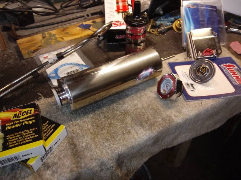

More motor goodies.. MSD coil, s/s overflow tank, Accel header plugs, Mr Gasket temp gauge radiator cap, Tuff stuff voltage reg, s/s trans lines.. Gotta figure out a new place for the coil since the carb is in the way of the stock spot. Any ideas?
Those valve covers are very very close to the aluminum ones sold by 440 Source. And I would put in a pcv valve.
View attachment 770943 View attachment 770944
Either you fabricate a custom bracket for the coil to keep it in proximity of the original location or you jump off the reservation and mount it on the right side apron somewhere. I run the monster Accel super coil that has a nice place on the inner apron and I don't have a 12 ft. coil wire..
